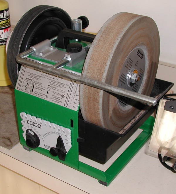

The quickest and easiest way to get a good edge is to get the Tormek sharpening system.  This is what I now use.   At about $400 for the basic system, it is expensive, but if you use a lot of edged tools on a regular basis,  it is worth the cost.  The system includes a large, low RPM, water cooled wheel with a rotary leather strop.   The wheel is normally 200 grit and can be re-graded to 1000 grit.   There is an adjustable tool rest and all sorts of special jigs for the precise sharpening of every conceivable edged tool.   However,  the only accessory that I think you need for gun work is the profiled, leather honing wheel. While I have a Tormek and highly recommend it, I will go over how to use standard bench stones to sharpen plane blades and chisels.

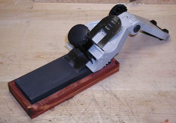

Once you have the back flat and polished, now it is time to grind the bevel.   You can do this free hand or you can use a jig to hold the blade at the desired angle.  If you do this free hand, you need to hold the angle steady and keep a good deal of down pressure on the blade to make sure you keep the bevel flat on the stone.  Remember it is important that the bevel be a flat as you can make it.  This is what is so great about a slow speed grinder like the Tormek.  It is easy to hold the blade at the exact same angle while the stone is turned under it.  It is much harder to hold a blade and move it over a stone at the same angle for the number of strokes needed to grind  the bevel.

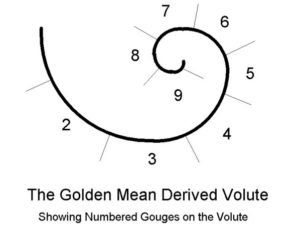

You might be asking, why is that important?  Well, for traditional, 18th century, Rocco carving, you should be using European numbered chisels.  The numbers represent the relative radius of the blade as a segment on the golden mean derived volute.  The golden mean derived volute can be thought of as the increasingly tightly spiraling line of the Nautilus shell.  A #1, or flat, chisel is at the beginning of the spiral. A #11 gouge, or veiner,  with a very small radius represents a segment at the center of the spiral.   All the other gouges lie in between.  You form a proper Rocco "C" or "S" scroll by using increasing and decreasing number chisels in sequence.  The radius represented by the number is ground on the inside of the blade.   It is for that reason that you have to grind the bevel on the outside edge in order to maintain the proper radius of the chisel.
That said, what does that mean for grinding the back of the gouge blade?  It means that you hold the best fitting  rounded edge of your multiform stone slips firmly again the inside surface of the gouge while stroking along the blade.  You stroke back and forth along the blade, moving the stone from one side of the blade to the other.  Remember, that at all times, the long edge of the stone must be firmly against the blade using the blade as a guide.   You will stone first with your soft Arkansas stone, then with your hard Arkansas stone.   You should remove all the machine marks leaving you with a smooth, uniform surface near the edge.  You will strop later.

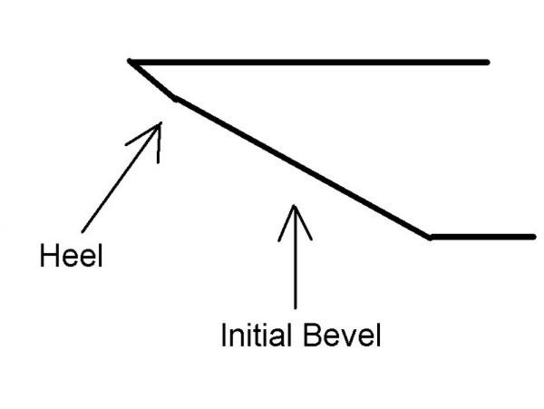

Once you get to the hard Arkansas stone,  you might think from previous experience that it is time to strop.  Well, there is another step required of sharpening carving chisels that I haven't told you about.  Actually you need to go back and perform this step on all your flat chisels that you use for carving, particularly the double bevels.  You need to grind a very small bevel at the end of the bevel you just so carefully ground.   This is not a big bevel,  just a few licks with the hard Arkansas stone until you can see another bright edge.   The final bevel should just be a few degrees greater than the initial bevel.  The reason for this bevel is to give you a little heel to use for leverage to keep from taking a deeper cut than you want.  Without the heel, it is difficult to control the tool.  You grind this same type of heel on gravers for the same reason, but that is another essay.

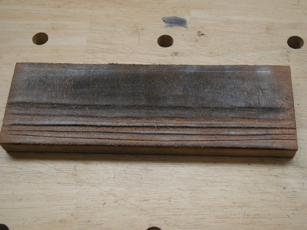

When   you have finished the second bevel using the hard Arkansas stone,  then,  it is time to strop.   You will need a wide, thick piece of leather as described previously.  It may be easier to use if you glue it to a piece of wood but that is not necessary.   We will start by stropping the back of the blade.  That is done by pressing the back of the blade down into the leather hard and pulling it from one end of the strop to the other.   As you pull the blade along, the blade will cut down into the leather forming a convex groove that will fill the back of the blade.   Keep stropping the blade until the back edge of the blade is polished bright.
Next, we will stop the bevel.  Use the chisel to cut a concave groove next to the convex groove.   Once you have cut a groove from one end of the strop to the other,  pull the bevel through the groove from one end to the other at an angle slightly greater than the bevel.   Keep stropping until the blade starts to heat up.  You can stop when you have a bright shinny edge.
When cutting the convex and concave grooves in the strop,  you don't have to cut one for every gouge.  You will find that you can use the same set of grooves for several similarly sized blades.  You just have to press down hard so that the leather conforms to the blade.  While some people don't use any sort of abrasive on their strops, I do.  I use some white rouge or the honing paste that comes with my Tormek.    By the way,  the profiled honing wheel on the Tormek takes the place of cutting grooves in  a flat strop.
