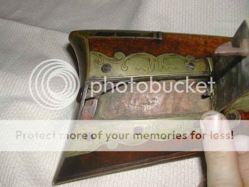

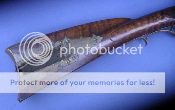

Here are acouple of photos I have in my archives that are from a rifle that uses a similar release to that of A. Figthorn
http://img.photobucket.com/albums/v648/DaveB44/jpb-002.jpg
http://img.photobucket.com/albums/v648/DaveB44/131117.jpg
Dave Blaisdell

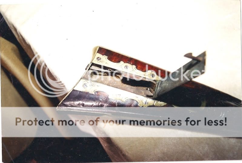

N Beyer also used this configuration.

This is a Nicolas Beyer that is owned by Homer Dangler. I was able to hold this one in my hands for a while durring a CLA meeting. As you can see all three of these are very similar to one another.  The second one is a Figthorn. The last one is from a Bonewitz.

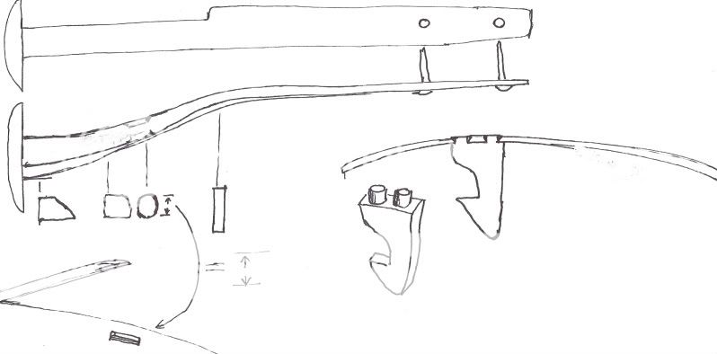

Here is the layout of what the parts can look like. Note that there is a rounded shank section in the long release spring. You slide the shank through the slot in the butt plate then at the rounded section turn it 90 degrees then secure it to the side wall of the patch box cavity.  The Bonewits and Figthorn both use nails through the end of the shank section to keep it in place. The Nicolas Beyer uses a slim sharpened end of the shank section to be driven into the wood shelf you see in the photos. I suspect that the shank penetrates this shelf up to 3/8 of an inch. I built a rifle in the style of Nicolas Beyer using the bird head patchbox design and this very same release. The only difference was the rivet head is only a single stud on the Beyer and no nails use to retain the latch spring. Hope this helps you to Get er Done. The book by Peter Alexander has some great info on building these pieces. I highly recommend it if I was limited to only one book to choose from.
« Last Edit: May 06, 2025, 05:59:01 AM by Ky-Flinter »

Very helpful drawing Dave B. Thank you! Where to acquire the release is my next question. TOW, Dixie, and MBS all have something similar , but it appears that the thumb button is only a half of what I think it needs to be. Is there a source for a release that is closer to correct or am I to make one? I am looking for the Alexander book, but out of print seems to be the case. Thanks again, with the photos and drawings I understand the construction.
