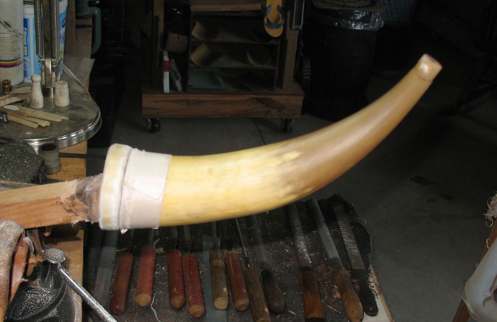

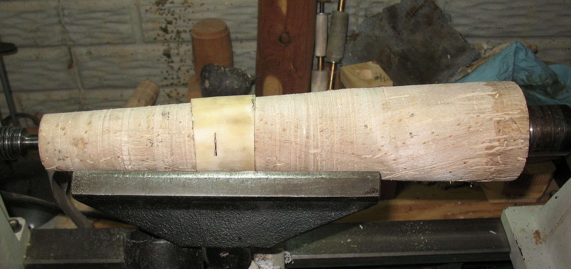

Back in Feb Tim Albert sent me a couple of pics of a blowing horn he had that had some damage. I do not have the skills to repair the damage it has so I decided to do the next best thing, make as close a copy as I could using the pics and a life size drawing Tim did.
Since there has been some interest in hunting horns of late I decided to record the process.
  The original has, as you can see, a turned mouth piece but the band at the base seen to be hand shaped making me think it was a later addition.
   Had to do it in 3 section the number hopefully coincide with the pics.
1.Damage
2.Overall view
3.Hunting horn to be

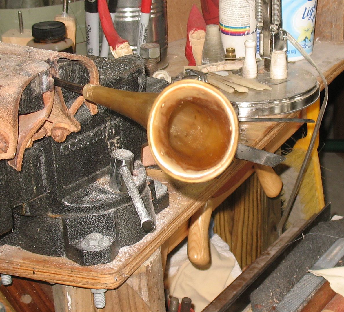

4.This will be the Mouth piece
5.Layout for mouth piece and end of body cavity. It is drilled and tapped 1/4-20
6.Bolt in and chucked up in lathe.
7.Turned down to 1/2", you can see how much the horn has to be worked down.

1.Drilling the mouth piece
2.On the mandrel and squared up
3.Rough turned
4.Lining up mouth piece in chuck using  ¼” bit
5.Drill both end with a ½” bit, maybe ½” deep. One
   end will go on the horn the other the mouth piece.
6.The mouth piece end hollowed out
7.Back on the mandrel for shaping
8.Test fit. At this point you can give it a blow and see what you’ve got.
    If you don’t like the sound you can put it back on the mandrel and deepen
    The mouth piece or with a reamer open up the ¼” a little. Go slow and test.
     It may just take one or the other or a little of both.
     A ½” counter sink can be used to help shape the bottom of the hole.
     BE SURE AND DRILL ALL HOLES WHILE THE BLANK IS AT ITS LARGEST SIZE.
9.Look close at the tip and you can see how much has to come off during shaping.
    Shape the whole horn not just the tip area.

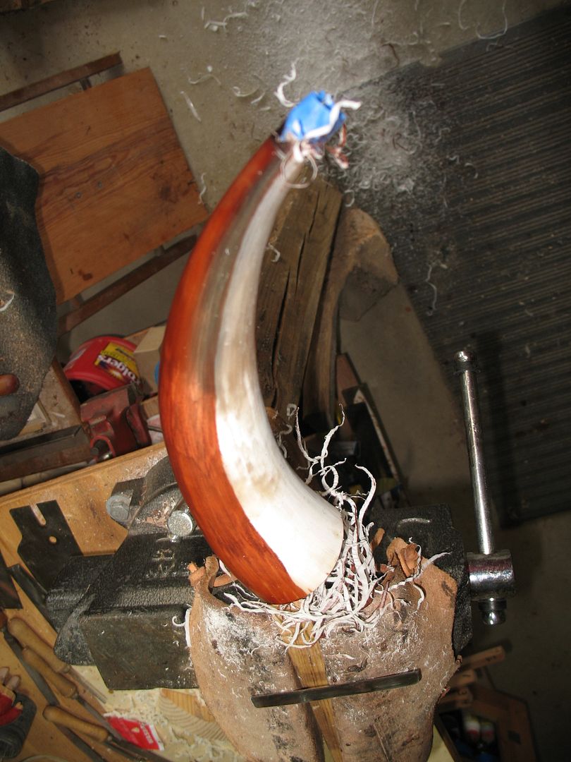

1.Shape with Spoke shave, rasps, scrapers.
2.Tip protected with tape.
3.Paint on a coat of something and scrape it off, it helps level out the horn.

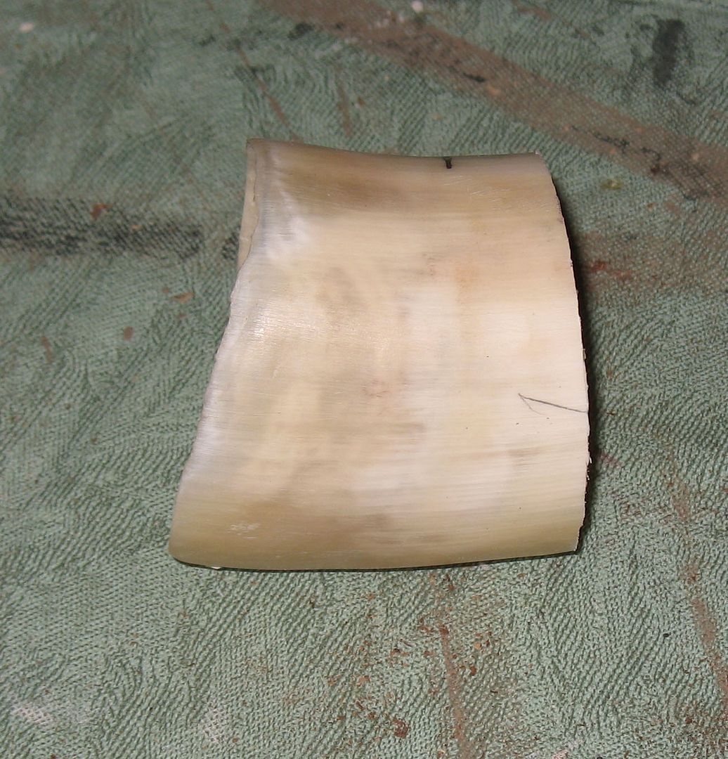

4.This is the piece I cut off the end of the horn, a piece of it will become the band.
5.Here it is on the sizer ready to be cut off. Since the original band looks hand shaped

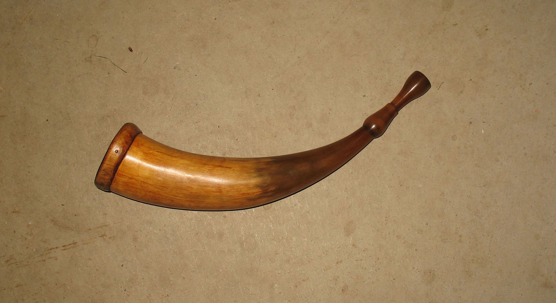

   once it is on the horn it can be worked down.
6.On the horn and is being shaped, that is tape to protect the horn.
7.Brass pins holding the band. The tip is attached with 3 steel pins,
   sorry no pic, it was to blurry.

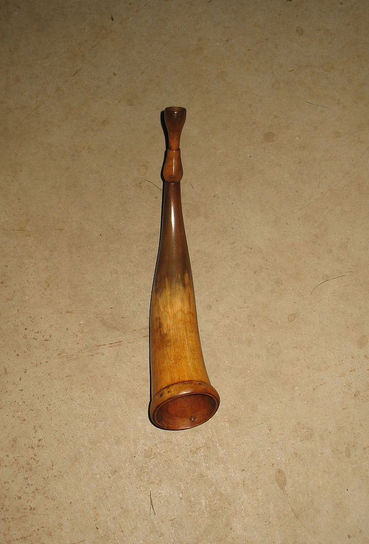

8.The color came from a couple of coats of AF, a coat of thined out oil base Light Brown
   leather dye and a coat of Brown shope polish lightly brushed.
8. The finished horn.
 If something is not clear or I missed something let me know and I will see what I can do.
