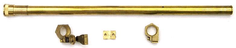

Anyone here use a sight like this? Not a scope. I've only seen a couple of them, and couldn't locate a good picture of one on a mid-19th century rifle. They were just long tubes with globe style sights or cross-hairs near the front. What are your results? How do they compare to peep sights?
I might be younger than most on this board, but my eye sight is probably as bad as most of you grumpy old men.  ;D Anyways, focusing on sights has always proven a challenge for me, and I thought this might be an interesting "period" option for something easier on the eyes. I still haven't even purchased or built my rifle, but I am just kind of thinking ahead.

 The "tube sight" pictured is a scope, because I own one. It is made in Japan, and is 4X. The mounts are non-authentic, and virtually worthless. Real tube scopes are easily made from brass tubing, preferably in a size you can get scope mounts for. BTW scope mounts from a small airgun scope will fit the scope pictured, but you have to make the adjuster at the breech, and the windage adjustment at the muzzle.

Thanks for the replies. I'm not thinking about buying that. It was just the most similar image I could fine. The few I've seen were simple long brass tubes with basic sights in the front. They were dark on the inside of the tube either from age or some treatment.
