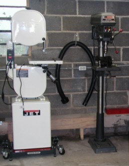

12"+ bandsaw or
bow saw
(Woodcraft)

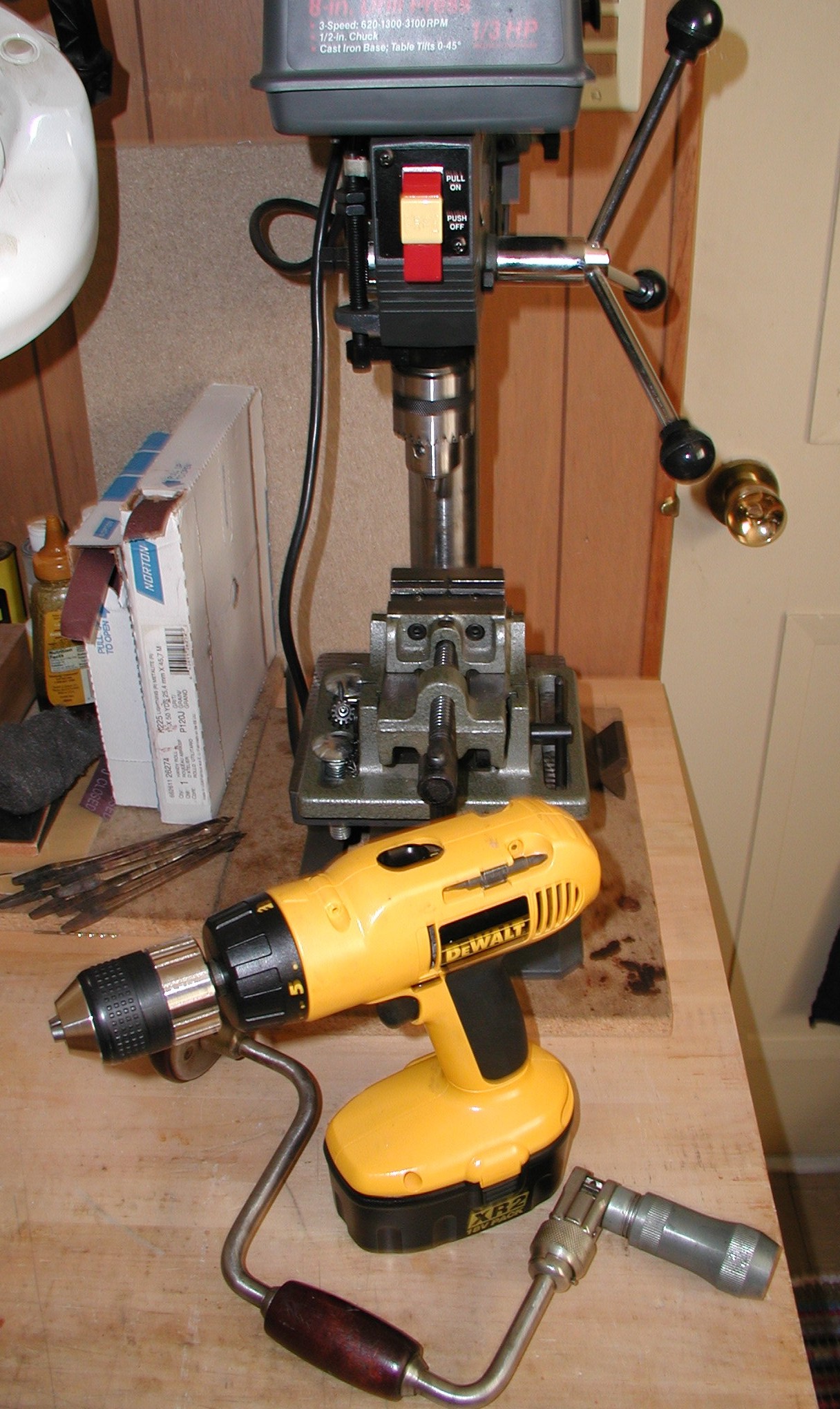

Brace, variable speed electric hand
drill, or drill
press. All are
recommended but an electric hand drill will do. I actually use my
Dewalt,
cordless, drill/driver most of the time and highly recommend it. You will need a good
vise for use with the drill press.

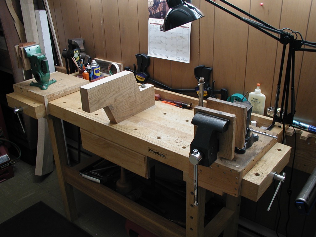

The most important tools are a good workbench and vise. A very solid 36" x 24" bench will do. A 60" x 24" bench would be better. You could certainly build a serviceable bench out of standard 2" Douglas fir or southern yellow pine. Of course, 3" white oak would be best. If you don't use mortise and tennon construction, make sure you bolt or screw it together. Any bench will need to be screwed to the wall.

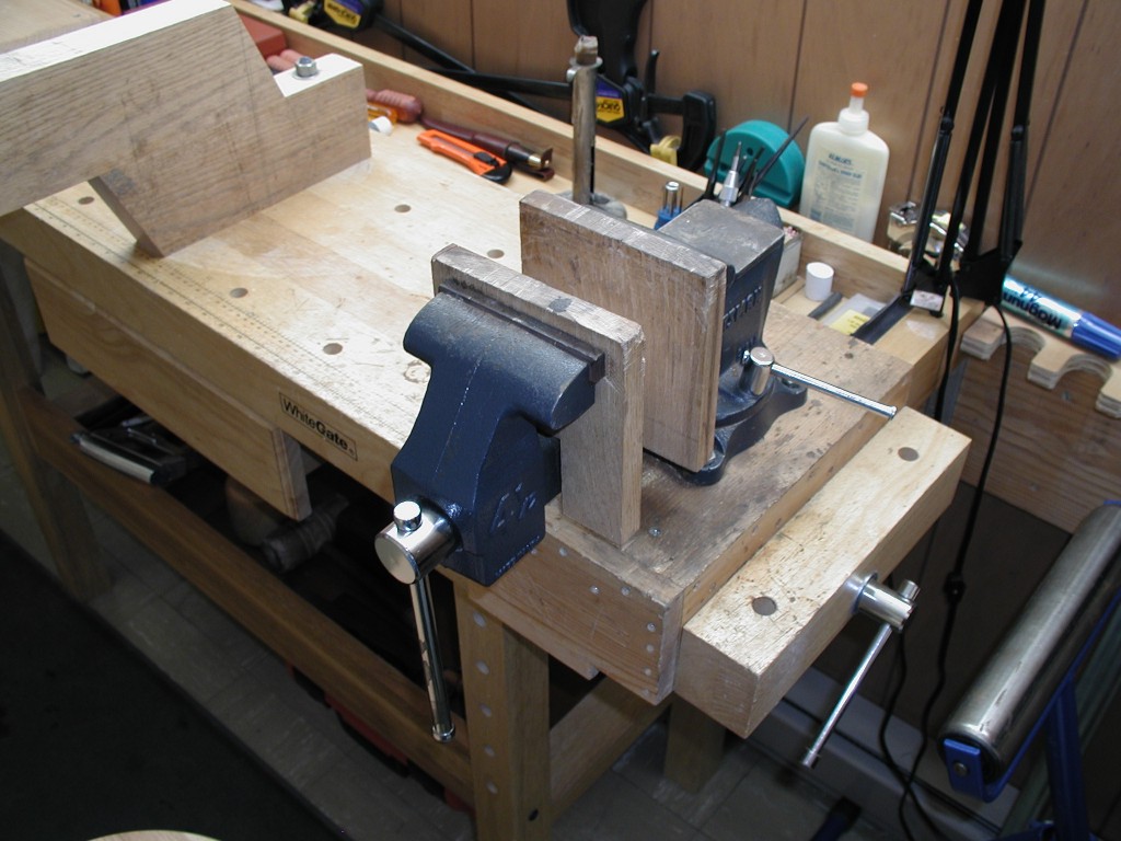

I recommend a minimum 4 1/2" machinists vise with a 180 degree swivel mount. A good machinists vise such as a Wilton Tradesman can be pretty expensive but you should be able to find a good vise for less money. The older Craftsman machinist vises were pretty good and less than a $100. You can also get an old post vise in good condition for less than $100. There are generally a number of posts vises listed on ebay at any given time. The only problem with a post vise is that it doesn't rotate, but it is historically correct.
You will also need a stock support the approximate height of the vise about 16"-18" away. I suggest that you make it out of 2" oak. When clamping the stock in the machinists vise, I always use wood jaw liners. These liners are two rectangular pieces of ¾" oak a little wider than the jaws and long enough to accommodate a slot to fit over the vises main screw. You can see my stock support and vise jaw liners in the pictures below. I also have metal liners made of lead that I use when holding delicate metal parts.
