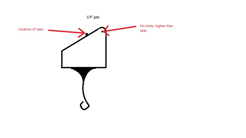

J.Cundiff
Re: how far forward is too far to pin a single trigger
« Reply #14 on: February 08, 2014, 05:49:44 PM »
Below is an extremely crude drawing of how Jim Chambers instructed me to pin a single trigger. I did my trigger on my Lancaster this way, and it's really a wonderful trigger... that Jim guy knows what he's talking about!  ;)
Offline johnny
  • Posts: 10
« Reply #15 on: February 08, 2014, 06:04:23 PM »
Great post!  I just finished a Chambers Lancaster kit for a NRA banquet item.  The pin is high and forward.  Although the trigger pull is light it has sponginess to it I could not understand.
thanks for this post again!
Offline Habu
  • Posts: 1266
« Reply #16 on: February 08, 2014, 10:09:25 PM »
Over the years, I've seen a couple of duelling pistols set up that way.  I really like the results, and use it when I can.
