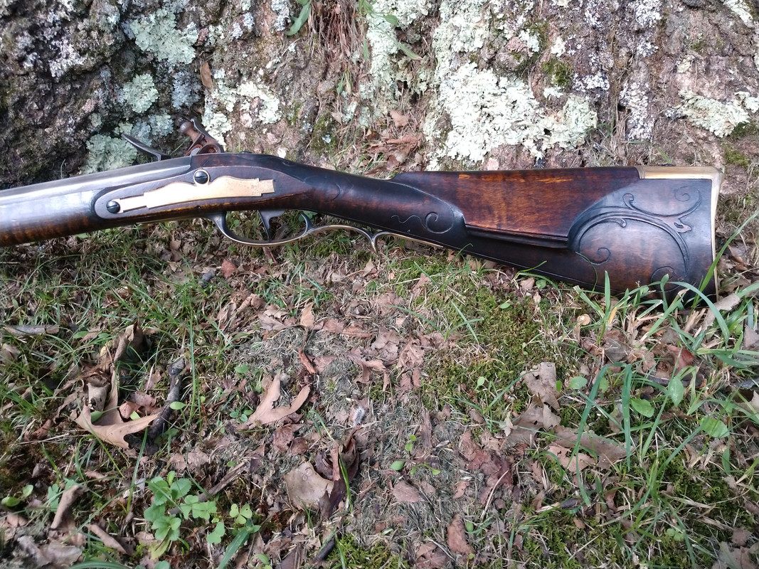

Here are two guns done with Jim's tannic acid and Iron nitrate, rubbed out, no neutralizer. The first is sugar maple and the second is red maple. In my experience the red maple will go a little darker.  Prompts me to buy better wood. ;)

« Reply #13 on: February 19, 2019, 01:07:50 AM »

Wow, that gun with all of the wire inlay sure is pretty! I wish I could afford something nice like that!!
Yeah, me too! ;)

« Reply #15 on: February 19, 2019, 07:24:35 PM »
Love that Lehigh rifle.  I need to add one of those to my little collection.
