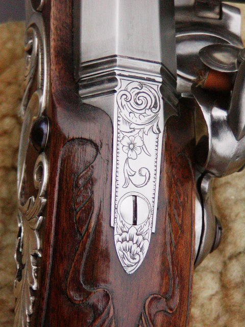

Thumbnail finial

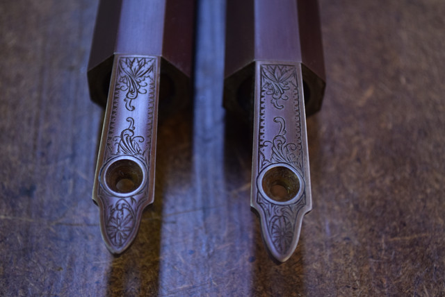

« Reply #2 on: April 15, 2020, 07:31:10 AM »
I recently built a Pennsylvania fowler for a buddy down south.  It has an interchangeable .54 cal rifle barrel with it, so there were two tangs to file - the same.  So here's how they finished up.

« Reply #4 on: April 15, 2020, 02:59:57 PM »
That's quite a trick to file them the same and have them fit Taylor!

« Reply #5 on: April 15, 2020, 05:01:54 PM »
I am convinced this man is an Artist in its purest form.

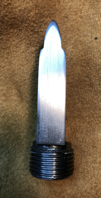

« Reply #8 on: April 17, 2020, 07:58:19 PM »
This is what I have so far.

« Reply #9 on: April 17, 2020, 11:09:01 PM »
Coming along. Overall length could be a bit long.  Does the length match well with your carving plans if any?
Looks like a little more could come off the left side step to match the right.

JohnN
Re: Tang shape
« Reply #10 on: April 17, 2020, 11:59:30 PM »
It may be a little long but I can always take some off, can’t add it back. 😁 Thanks.

« Reply #11 on: April 18, 2020, 02:03:04 PM »

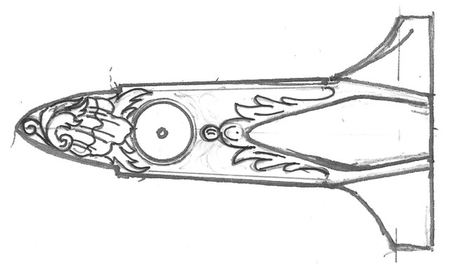

Hi,
The tang is way too long.  Two inches long from the barrel is plenty.  It also looks better if it tapers a little. However, it looks like you are using a pretty skinny barrel, which may preclude tapering the tang .  I draw the profile on a sheet of paper, making sure both sides are even, then I cut it out and glue it to the tang as a guide.  If the tang design is not even it really shows on the gun.  The drawing below shows a tapered tang
Here is one without the sighting groove.  Although a hooked tang and breech, the proportions can easily be adapted to a plain tang.

« Reply #12 on: April 18, 2020, 04:04:52 PM »
Thanks for the advice. The tang is just under 1/2” wide. This was a practice run . One more thing, I hate you artistic types. 😄

« Reply #13 on: April 18, 2020, 07:04:59 PM »
One more tidbit of advice.  It's easy to file the steps or shoulders too deep.  Keep these pretty shallow.

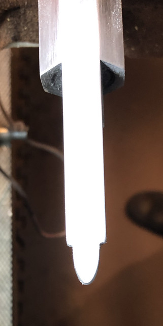

JohnN
Re: Tang shape
« Reply #14 on: April 18, 2020, 07:52:49 PM »
Revised version.
