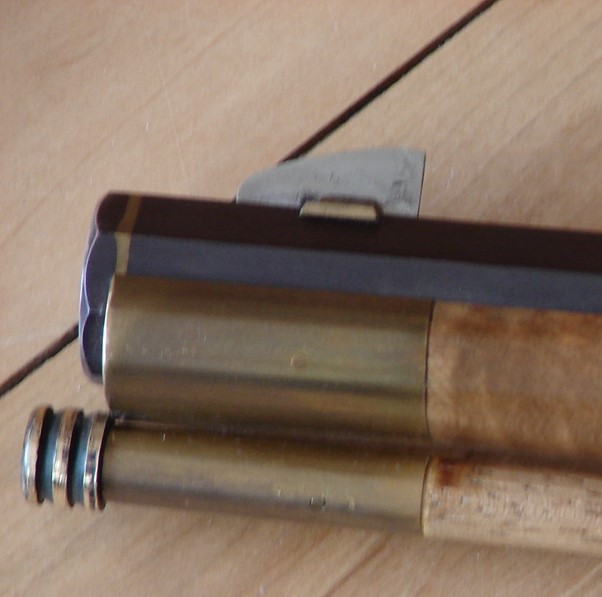

The group at 100 yrds is 2.75in  above dead on so 100yrds =3600in the space between front sight &rear 35.75(36 in) so if my math is right I need .03(.029) height
The point of aim is at the base of the brass peep in photo   so if I need to make a new front sight I might as well try different angles/shapes
this is the new sight before shaping & filing to point of impact went with the same thickness (I have other blades thinner & thicker in silver )my brass ones are to short
I had filed the base of the peep sight to lower the 2 shot group But was getting to low to remove any more soooo a taller front  :o

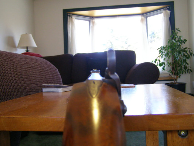

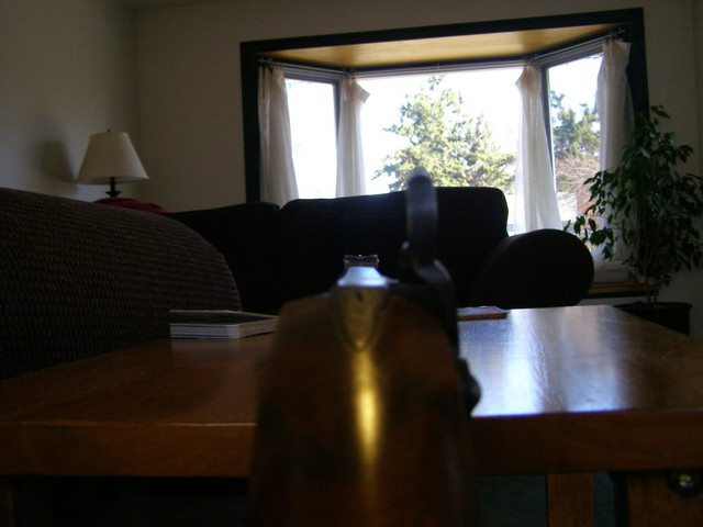

We like about a 45 degree angle to \catch' the light. This works on blade sights as well as beads.
If you enlarge this picture, you can see the shine from the STEEL Blade on Taylor's Kuntz rifle. This one has a 45 degree angle cut to shine when need be.
I've published these pictures here "add nausium" sry
The brass bead has a 45 degree angle to catch and hold the light for shooting in dark places.
I carry a (dull black) dry-erase felt pen in my 'kit' for blackening the front sight when shooting in the sun. This is easily removed with a swipe of the thumb or finger.
