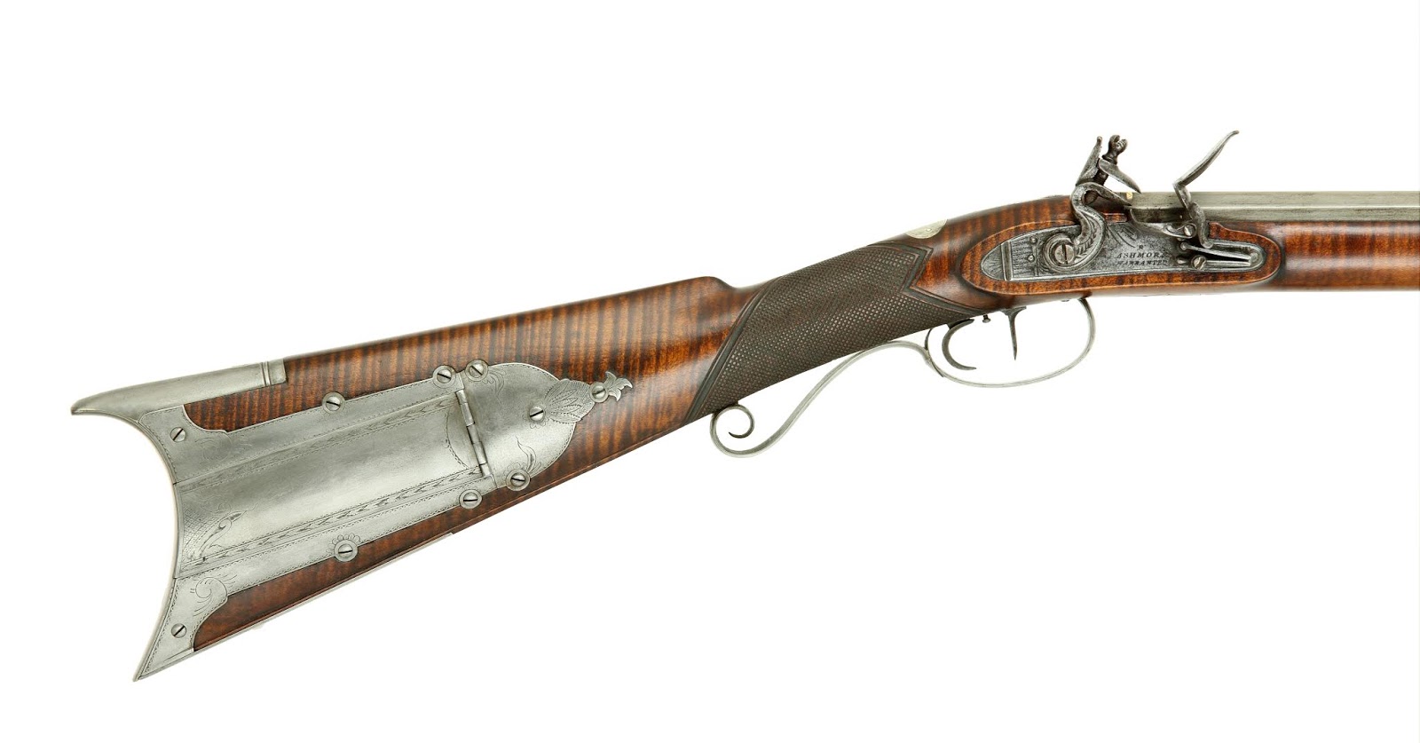

I'd like to be able to make one similar to the Philip Creamer rifle, but this being a 58 cal I don't want it curved as much. So, the curve and width of the early Hawken but I'd try to put the flat on the top the return like the Creamer. https://4.bp.blogspot.com/-kTDGBKXLCPc/Wx27nG8-DnI/AAAAAAABxkg/MOtTByg1TsIvqn6Jop0K3EDkNff-8LOzgCLcBGAs/s1600/TNKY18_600_rl.jpg

I think I got the picture. You could rivet that, but I would also braze or copper braze them together. It also doesn’t take much of a curve to stiffen it up. And you can always coat the inside with braze to firm it up. I have used .050 on early style buttplates over 2” wide to reduce weight, but there a little flimsy to inlet.
If I remember correctly, the buttplate on the Edward Marshall rifle is about 1/16 thick, but again it’s a wide early plate.
