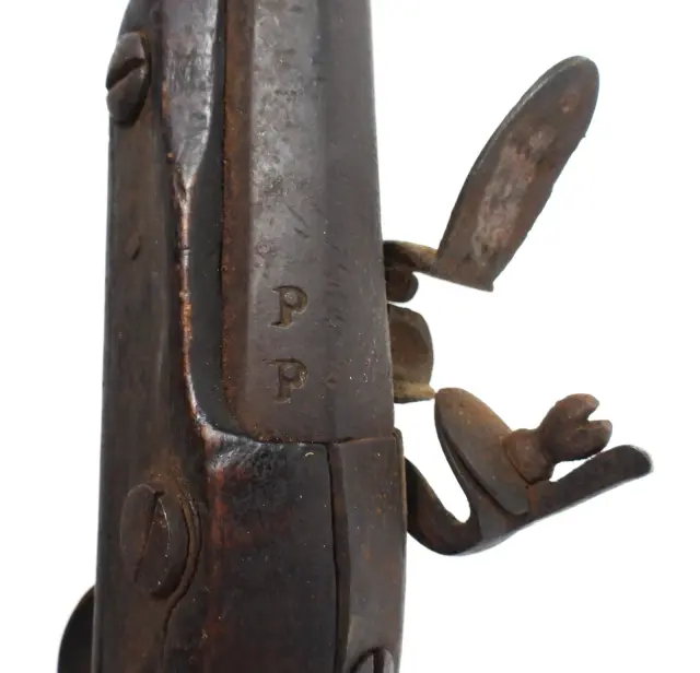

Markings On A Dickert Barrel
« on: October 21, 2025, 01:02:05 AM »
Signed Dickert barrel with engraved initials MR on the top flat near the tang. Barrel makers markings are usually under the barrel, so I’m not sure why these initials are here. What are your thoughts?
  • Posts: 4632
Re: Markings On A Dickert Barrel
« Reply #1 on: October 21, 2025, 01:33:00 AM »
Good question!
I read somewhere, probably last century, that the old makers would take the barrel runout into consideration, and mount the barrel so the runout would have it shooting high. Maybe the runout on this barrel had it shooting high with the barrel makers mark on the top flat?
That's certainly a nice Dickert signature!

Good question!
Interesting, hadn’t thought of that John, could very well be the case here. If it’s the barrel maker, any thoughts on who MR might be?

« Reply #3 on: October 21, 2025, 02:32:12 AM »
For what it's worth .... over 50 years ago, an elderly and knowledgeable collector told me that  when the breech plug was screwed into an already marked barrel, it was easier just to leave the stamping wherever it fell rather than take the time to modify the plug or barrel unless it was a higher quality and priced gun. I don't know if it's true, but that's his story

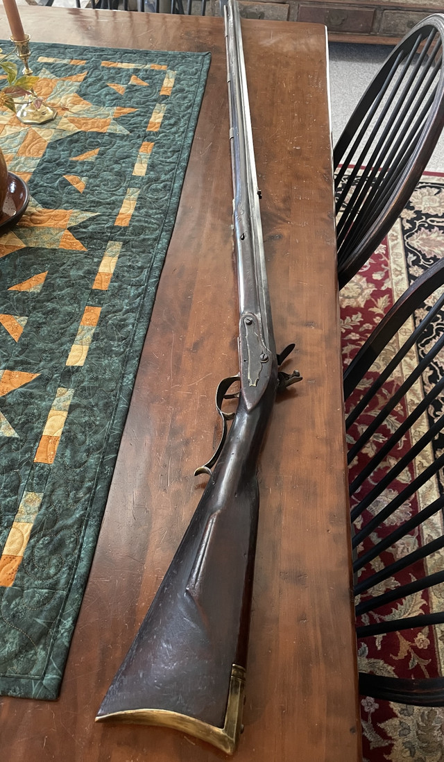

« Reply #4 on: October 21, 2025, 02:51:49 AM »
I have to ask, what does the rest of the rifle look like?

« Reply #5 on: October 21, 2025, 03:51:36 AM »
As requested, here are a couple pictures of the Dickert rifle. Fairly early working man’s gun, plain with no carving, just some basic forearm and buttstock moldings.

« Reply #6 on: October 21, 2025, 09:36:49 AM »
Nice--thanks for posting those!

« Reply #7 on: October 22, 2025, 01:58:24 AM »
Awesome rifle!  Thanks for posting the pictures.  Would love to see more if you have them.
Unfortunately Dave there isn’t much more to show, no carving or inlays, but if there are specific areas you want closeups of, I’ll get them for you.

« Reply #9 on: October 22, 2025, 02:50:26 AM »
On some restocked rifles I have seen, if the barrel was signed by the original gunmaker, the second gunmaker re-using the older barrel often left the first gunmaker's name on the barrel... I presume out of respect for his elder, especially if the barrel had been hand-made in the original gunsmith's shop.
This Dickert rifle, while a great gun, is a bit on the plain side without butt carving and somewhat limited engraving. While speculation on my part, it seems to be the type of gun where the owner may have requested a good quality but lower cost gun, perhaps provided an older barrel from a family rifle [or Dickert had one], and was willing to re-use a good older barrel while limiting the amount of decoration added by Dickert... keeping the gun reasonable.
When I see the older looking "M.R" on the top barrel flat, where guns were normally marked by the gunmaker, it makes me wonder if the barrel might have been a good quality earlier barrel by Mathias Roeser of Lancaster, who worked in the area earlier than Dickert.

« Reply #10 on: October 22, 2025, 03:29:24 AM »
Not his fanciest engraving, but still well done and original to the rifle.

Frank,
Ver nice rifle. Looks to me to be a Dickert rifle for a man who wasn't as well off as some of Dickert's other clients. If it had extensive carving it would look just fine. The lack of carving is the only thing different from other Dickerts I have seen.

« Reply #13 on: October 23, 2025, 04:21:01 AM »
There is a chance the MR could be a militia unit marking as well, Dickert sold rifles to PA militia rifle units in the war of 1812 (see Moller v2).

« Reply #14 on: October 23, 2025, 04:24:27 PM »
Your post got me researching the different early contracts that Dickert had and I found an article on the internet written by Ed Flanagan for the American Society titled “1792 and 1807 Contract Rifles”. He discuses the various contracts and shows a picture of a contract rifle with very similar markings at the breech. He thought they were barrel makers marks and from Martin Fry (MF). My mark is a bit clearer and I think the marking is most likely MR. So I’m now thinking the marking on my barrel are those of the barrel maker. So was this a left over barrel from the contract or could the entire rifle have been one of his contract rifles? That could explain why it’s so plain. Thoughts?

« Reply #15 on: October 23, 2025, 05:52:01 PM »
from the ASAC article by Flanagan:
The barrel is stamped MF and US at the breech with
the U cut in half when the barrel was shortened (Figure 3).
There are several letters from Knox to Hand discussing the
markings to be applied to the contract rifles. From these let-
ters, the rifles were marked US; one letter referred to the
usual method of marking them US.5 The implication here is
that all were being marked. I believe that all contract rifles
were marked because the Government learned back during
the Revolutionary War that unmarked arms and material dis-
appeared unless marked US or with some form of United
States.
From Moller specific to PA contract rifles (NB your gun lacks the US marking):

No problem, and interesting rifle. It may be a coincidence, but Moller notes these rifle Companies were hastily raised and armed to serve in Maryland. In addition, it is worth noting that the state of Pennsylvania marked it's Revolutionary war era arms in years prior with a "PP" mark. I suspect there is archival info out there that can illuminate the true meaning of MR, whether it is a maker's or ownership mark or unit designation.
Moller V1
It is speculated that this is an ownership marking and may mean “Pennsylvania Property” or
“Pennsylvania Province.”

I enlarged the photograph from the American Society article and the marking identified as "MF" sure looks like "MR" to me.
Ron
Ron Winfield
Life is too short to hunt with an ugly gun. -Nate McKenzie
Offline spgordon
  • Posts: 1342
« Reply #19 on: October 24, 2025, 07:34:19 PM »
Ron
Yep, totally agree. It's MR on that rifle included in the ASAC article.
I thought before--and am even more convinced by the two MR barrels--that the MR has nothing to do with Matthias Roesser.
Check out: The Lost Village of Christian's Spring
https://christiansbrunn.web.lehigh.edu/
And: The Earliest Moravian Work in the Mid-Atlantic: A Guide
https://www.moravianhistory.org/product-page/moravian-activity-in-the-mid-atlantic-guidebook
Offline Fullstock longrifle
  • Posts: 1105
« Reply #20 on: October 25, 2025, 01:27:20 AM »
Ron
Yes, Flanagan was mistaken when he thought the markings were MF, the markings on both rifles are MR. So you’ve seen this marking (MR) on other rifles? Could they be some sort of acceptance marks on militia used rifles?
