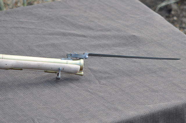

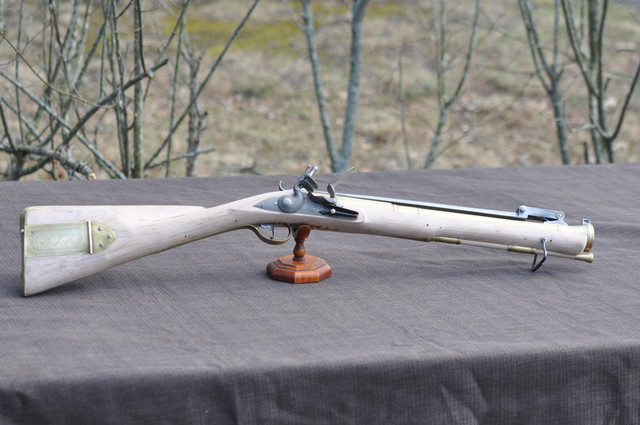

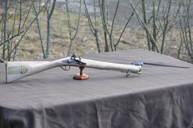

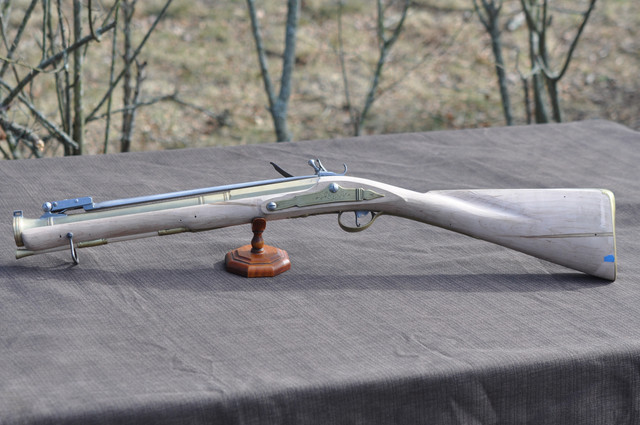

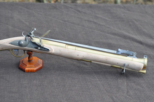

  Most of my work is based on existing examples.This Blunderbuss(at the request of the owner) has a bit of a story.He lives out west and does fur trade.He found fort inventories with blunderbuss's listed that had been repaired/restocked? after they were obsolete and shipped west.My version represents  one of those possible restocks which explains the patchbox and maple stock  ;D ;D ;D I made the bayonet and mechanism and the barrel is a .75 cal Getz barrel.The gun is loosely on a couple of different originals.A special thanks to runastav  who posted his making of a flip out bayonet as his photo's of the mechanism were a big help.Anyway it will be on my table at Lewisburg and Lake Cumberland shows.Stop by and say hi!!!

Very cool Mitch. I think I'm going to make one for myself one of these days. Definitely with a flip up bayonet.
I was wondering if there is a reason the pin for the entry thimble is so far back?
Justin
I have always pinned my entry pipe there which is at the back of the tab rather than the center of the tab for the other two.I find that if I spring the tang of the pipe down it puts tension on the  the tang and helps keep it in place.It helps especially with English style pipes who sometimes want to curl up even thought they have a embedded point to keep them in place.
