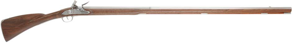

Hi friends. The smoothbore bug bites firmly and I have been investigating. I am learning about the French smoothbores of the early-mid 18th century and that is because I grew up right next to Fort de Charters in Southern Illinois. Really interesting time. I also love the French butt shape and the general lines of these weapons.
What is everyone’s thoughts on the Track of the Wolf Fusil de Chasse kit?
https://www.trackofthewolf.com/categories/partdetail.aspx/601/1/french-tulle-fusil-de-chasse-44-parts-list
Is this considered a good kit in terms of proper shape and is it of good quality? I am intrigued because I’ve never built a gun and according to track this is there easiest kit which would be beneficial for me.

The barrel is wrong. The profile doesn't  match any of the three original  barrels  I have from st.Etienne or Tulle.
The ramrod web is a bit t thick for my liking.
If you know what your doing while shaping  the lock panels and tang,you'll lose all the carving, just as well the tang is all wrong.
Get rid of the sight they sell with it,its wrong.
The ramrod pipes that come e with it are questionable.  I'd go with plain sheet metal
That being  said,  it can make a fair looking piece.

Oh wow. Any alternatives that are a closer match?
In addition, are there any builders making good ones? I am also not at all against just hiring a builder.

Though I've never held one in my hands, RE Davis makes a nice parts set for the French Trade Gun...with 48" barrel too.
I've had a lot of experience with various Tulle muskets and the bottom line for me is this:  the stock design on the contemporary kits is a real cheek slapper.  There isn't enough drop at the COMB and the Pied de Vache buttstock shape further exacerbates that.  I have a reference text on these original guns, and TOW's design doesn't even approach HC to my eye.  So check out RE DAvis' effort.

Could you be so kind to provide illustrations of the differences? Especially of the barrel tang? Unfortunately their are only 3 published works of French trade and hunting guns, one is unobtainium and the other 2 are quite dated and lack the illustrations for full study.

Thanks, all. Didn’t know they had a tendency to slap the cheek. No fun not being near the east coast away from muzzleloader country. I’ve never fired one.
I’d prefer one in 24 bore (.58) so I could use it with .575” round balls which I have plenty access too. Yet of course most modern barrels would be even heavier and throw the balance off.
Bother.

I built one of those. Its a great gun even if the history is off a bit.
