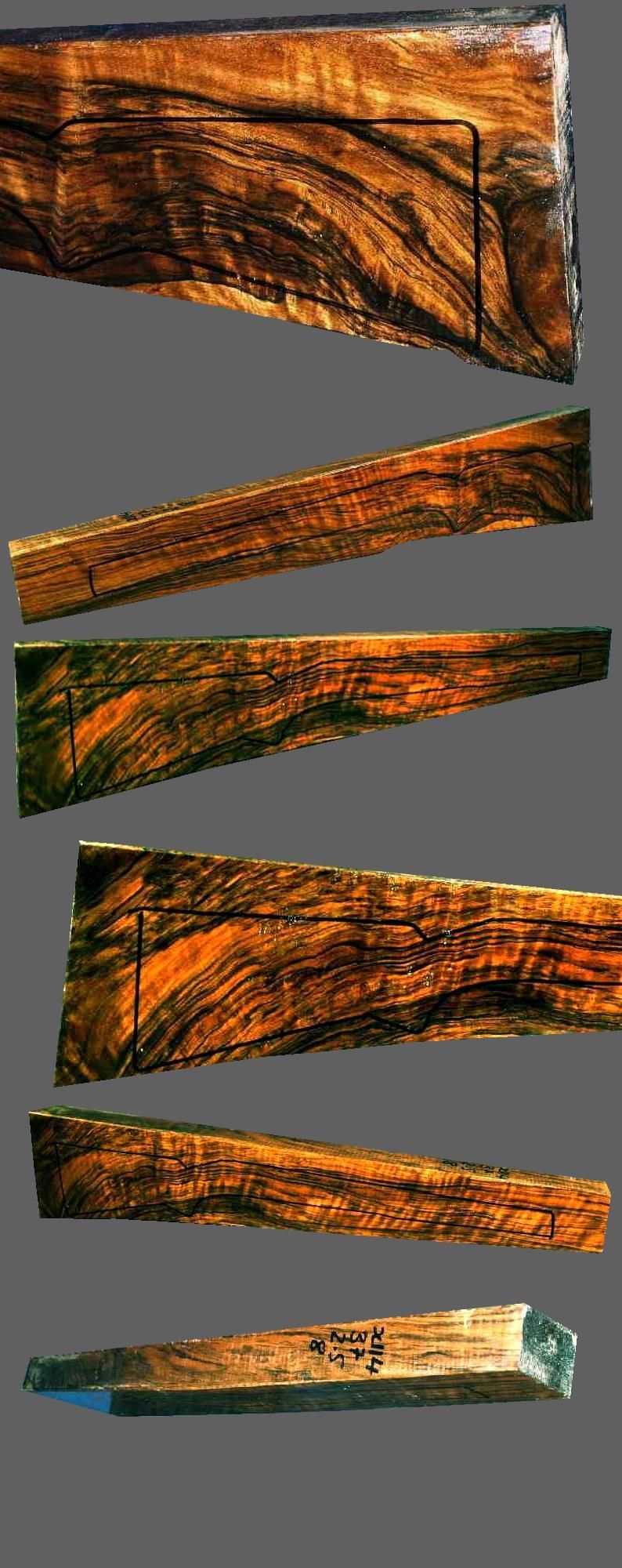

Re: claro walnut?
« Reply #7 on: April 09, 2010, 05:31:04 PM »
When I bought this stock as a bandsawn blank back in the early 80's, I was told it was California English/Claro hibrid.  It was expensive.
That's what all the Claro looks like that I have used. Don't get me wrong here, I like the stuff, but all the English I have used is far better for gun stocks. I have probably been spoiled by getting to use too many good english blanks....

« Reply #10 on: April 09, 2010, 07:31:57 PM »
The other straight claro I've had on modern gun stocks, lacks the black horizontal lines & was considerably softer than this wood.  Of course, there is much variety in wood.

Juglans regia grows over a enormous range from England to somewhere east of Turkey in all those 'stan ending countries in central Asia.  Like any other species that grows over a range like that there is lots of regional variation as well as country pride.  A good Brit would never use the term French walnut even if the blank was imported from France, likewise the French were ill inclined to term their wood English walnut.  The growing conditions in England are pretty radically different than those in Turkey and the wood will reflect some of these features.  Circassian and Turkish are generally used to indicate wood grown in Turkey and the surrounding countries.  Wood from any near eastern or asian source will work almost identically to that from California and like wood from California may differ considerably in density, pore size, growth rate, etc.  I've seen wood from Oregon where the growth rings are more than 1/2" apart.  One almost always sees tight growth rings in Turkish or other asian wood due to the considerably drier conditions.  What makes for the highest grades in these woods is typically not feather or curl in the grain pattern but black mineral lines which do not correlate well with growth rate.
In a blank like this the black lines completely mask the grain lines.
http://www.hunterbid.com/cgi-bin/new/auction/APUserImages/U4F1EPECKDCH.JPG  You could buy this piece for your next halfstock for only $2,650.
