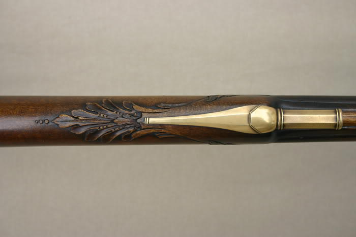

This subject comes up repeatedly, and there's no question that normal use, and BP fowling will surely darken the brass, but if you're looking a for more specific effect, such as this by Jim Kibler:
http://3.bp.blogspot.com/_vb_Yo_ELC48/SwX0CsC7j5I/AAAAAAAATy8/Lv-Q3jRoAPw/s1600/IMG_0832.jpg
You probably want something a little more controllable.
