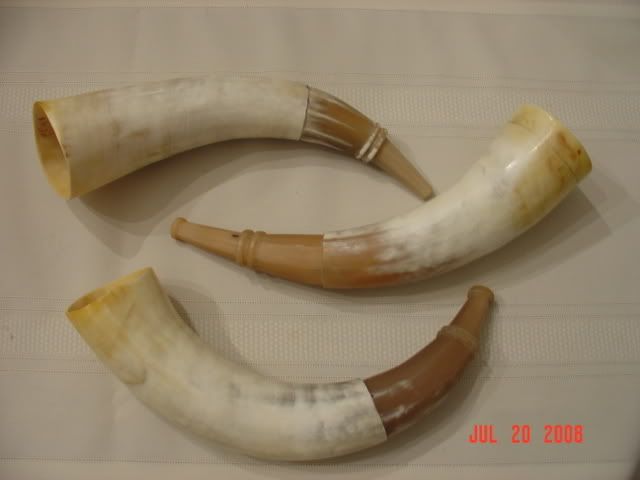

Here is are photos of three horns that I have been working on.  The first pic was earlier in the summer as I roughed out the spouts.  The one attached to the bag went on the woodswalk at Friendship this fall. The other two were finished up last night. They have slightly domed cherry and maple plugs. I used eight walnut pins. The staples are cold-forged with a twist in the square wire. I had planned to do a turned plug with a threaded fill hole and didn't get that done. I'll save that idea for a future horn.
At this point none of the horns have a aging dye job. I tried a mix on one but it was too yellow. I plan to leave the horns as is until I get back from the Conner Prairie horn class with Art DeCamp. I hope to come back with ideas for the dye and also for scrimshaw. A decision about scrim will be made when I finish Art's class and see what confidence I have in what I learned.

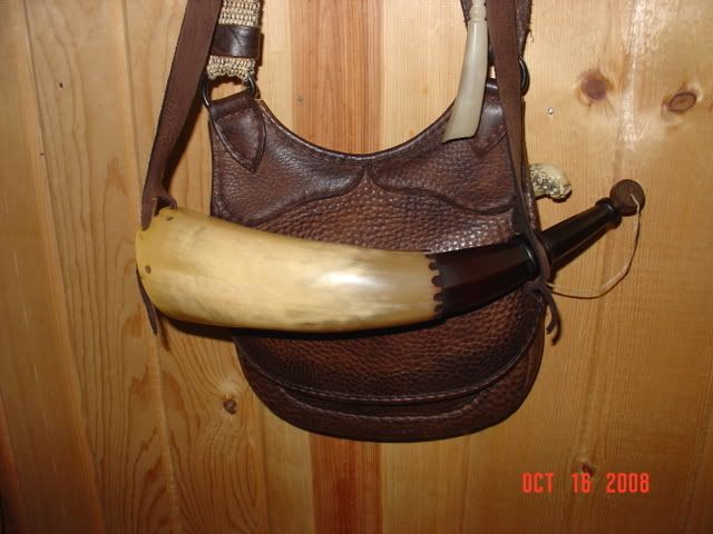

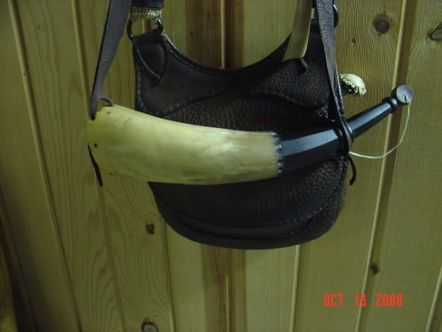

I mentioned earlier that I wanted to wait to dye my horns until I came back from Art DeCamp's horn class.  As it turned out, Art used my horn as an example of the process he uses to dye his horns.  The color turned out very nice.  Rather than try to describe the color, here are two photos.  One is with flash and one without.
The first probably is the truer color.  Trying to accurately show color shades is my weakness with a camera rather than the real shade of the horn.  I hope you get the idea.
Art, Thank you for the class and for your help with my horn!

California Kid
Re: horn project
« Reply #10 on: October 18, 2008, 08:22:03 AM »
Larry- check to see if your digital camera has a setting for white balance. Florecent , incandescent , and daylight all have different color temperatures, measured in degrees Kelvin. Flash and daylight are about the same. Mixed lighting sources is where you are getting in trouble.
 Film is the same way. Did you ever shoot Ektachrome film indoors and notice that the color doesn't look right? Its color or white balance is for daylight or about 5500 degrees kelvin, if I remember correctly. That's why everything has a green cast.
