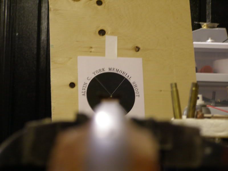

This is the front sight I like. The rear face has forward slant, but is flat across the it's rear face so light coming from the sides doesn't cause off shots due to glare.  In the bush it's a bright round beakon, and a swipe with a felt pan makes it dark if needed on light targets.  A deer, moose or bear doens't have any light areas in the kill zone and for targets it works equally well.
So how did you make the yellow spot??

Tim - the yellow spot is actually the rear end of a rod of solid brass, soldered to a steel base, with the front end, tapered with a fine file. In the picture, it wasn't finished as it needs a swipe with a file across the rear end to leave a smooth, small round bright brass surface.
Hmmm, I'm a little dense so a rear face slanted forward, but flat across the it's rear face doesn't quite compute.
Does that mean that the bead is tipped so the bottom is closer to the muzzle with a flat face that is also slanted downward?
If that is the case, wouldn't the top of the bead be visible, and would it contribute to glare?

JD - the sight's rear face is slanted to the top is closer to the muzzle, whereas a pistol's target sight is either square, straight up and down, or even slanted as you noted, with the top edge closer to the breech.  Since the face is flat, it doens't pick up light from the sides, which caused a big glare on one side and causes off shots.  In the bush, the sight is always just a round, bright bead in the rear sight.  I have one other picture that might show this. I'll edit to include it. In the picture, there is a small bright brass bead sitting just about in the middle of this chunk target. The picture isn't great, but if the front sight had been a steel blade, the shop lights probably wouldn't show it at all on the black target. Indeed, had the sigth been a steel blade of typical straight up and down form, it would have been invisible on the black surface. This is the square blade's nemisis - only getting a good sight picture with it out in the open, whereas something that is shiny must be used in the bush, normally, depending on the colour of the target.
; Amended to include sight picture and a drawn profile of the front sight. The taper of the sight is in 3D, ie: all way around. This way is it impossible for light to reflect off the sides, top or bottom of the bead.

Above post amended to include drawn sights.

Thanks Daryl, that explanation was as clear as the front sight bead in the photo.  :D
