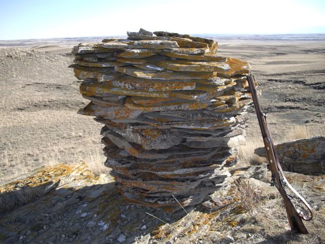

If one wishes a big game rifle, one must use a bore size having appropriate dimensions. Of course, one must check for mice, snakes or squirrels before loading.
« Last Edit: November 12, 2008, 06:42:13 PM by Daryl »

frontier gander
Re: What makes a good hunting rifle?
« Reply #23 on: November 12, 2008, 07:39:18 PM »
Im betting you paid a midget $10 to hold the rifle so it looks so big  ;D
« Reply #24 on: November 12, 2008, 10:03:09 PM »
Spot-on! - It's 1.350" bore does look a bit larger than it probably is, doesn't it.  That makes it a 2 bore, by the way.  8 ounce ball - what fun!   I wonder what the conical weighs?  Looks like a lot of gun spending at the range for several days working up an accuracy load for ball and bullet, lube testing etc, - eh what?
 Ed Rayle made the barrel, btw.
« Last Edit: November 12, 2008, 10:03:32 PM by Daryl »
