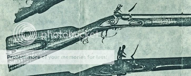

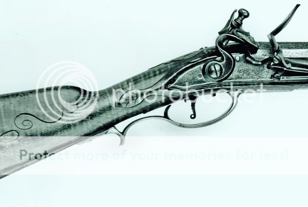

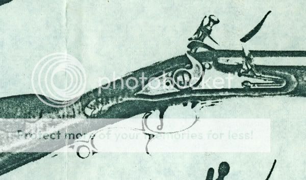

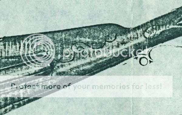

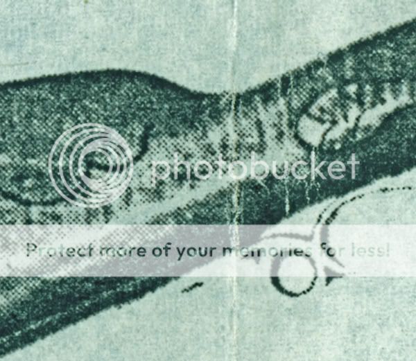

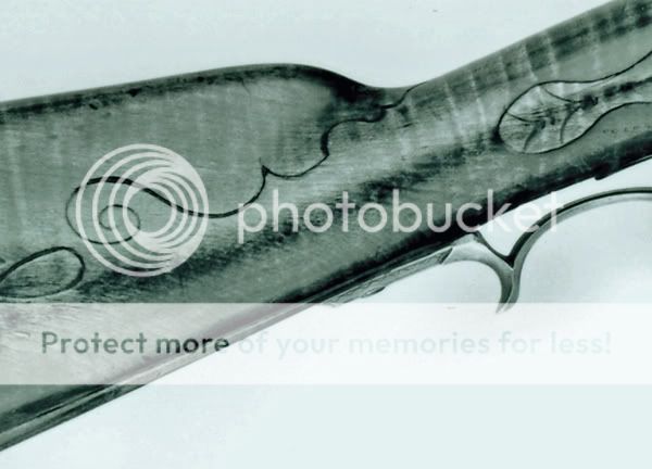

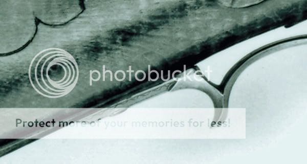

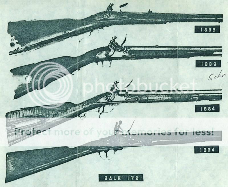

As promised I have scanned the rather poor copy of the picture of the Schreit rifle from the auction catalog. As I suspected the photcopy was high contrast and the original image was low in the number of dots per inch. I suspect it wasn't more than cheap magazine resolution is today.
The photos below start with the entire catalog page with four guns then "zoom in" on the detail of the wrist area. I've also included two images from pictures taken after the first round of "restoration" was done. In evaluating how much of the step was removed I suggest you look hard at the difference in the width of the lower butt moulding at the step from the old picture to the more recent.

Your photo series is great Gary.  Thanks for taking the time to put this together.  Really appreciate it.

Gary, thanks for taking the time to do that.  THe pictures are very informative as to the visual impact of the modification.

    Well, I guess that pretty much answers the question of did RCA # 18 Schreit ever have a stepped wrist.   More than half the original molding/step was removed in the various triggerguard replacements etc.   I appreciate your efforts to help us understand the architecture of this grand rifle.

Thanks, Gary. That is much as I recall the photo, but there was some "memory drift" on my part pertaining to the guard in place at the time of auction. I didn't recall it being quite so 19th c. "scrolly".

To me, it appears that the slight step, was shaved down to remove the rear guard slight inlet to accommodate the new one which appears to be mounted proud on the stock.  I wonder if wood was also removed with the switch from the original horn/wood grip.  This last edit/fix was for sure an improvement, even though it was an adulteration of the original architecture.

I think I see why the step was removed - the replacement guard was not as long, and the rear return of the triggerguard would not fully 'land' on the step.  So the worker simply removed the step to provide an adequate platform for the triggerguard.
Bill
I'm not seeing the third or fourth generation brass guard in the last three photos as mounted proud on the stock. It looks like a "regular" inlet up to the edge of the bevel to me.

It does look like the rear of TG may be inlet some, but that the return is a little short of the step.  If I cock my eye the right way, it doesn't look like the step has changed so much as the "new" TG extends the toe line and obscures the step to some extent.  Looking at the last two pictures, it seems like the wood of the step hasn't changed much at all, but from a distance, it looks like it has been reduced significantly because of the TG.
