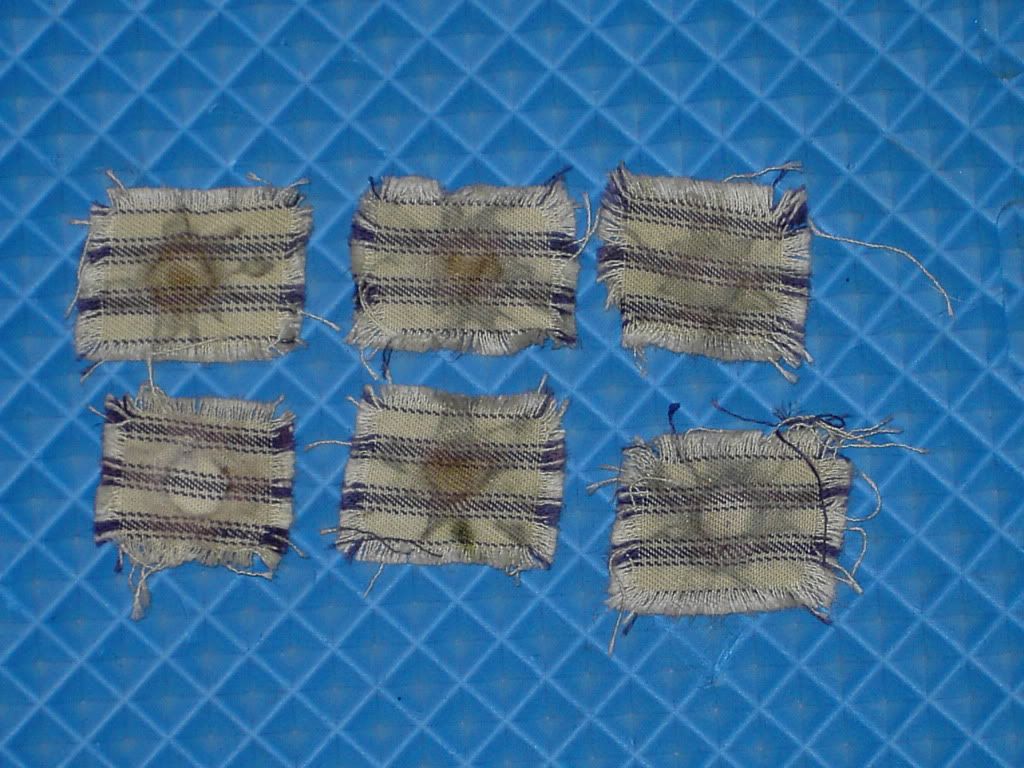

I can't clean with one patch or even a dozen....well maybe a dozen will sometimes do it.  Hoppes does keep the bore cleaner.
These are not cleaning patches but shooting patches after a couple dozen rounds.

Macon - .440" ball (have you actually measured them?) + .020" = .480".  A Rice barrel, will usually be .450" bore, with .016" rilfing depth, thus .482", groove to groove.  Assuming your patches are actually .020" (everyone differs with their measurements) that is smaller than the groove diameter by .001" per side and that means some fouling, however little, is deposited each shot and is building up. A thicker patch or larger .445" ball should reduce, or eliminate that buildup.
We like to see at least .004" to .005" compression each side as that eliminates any fouling buildup, gives great accuracy and clean shooting.
