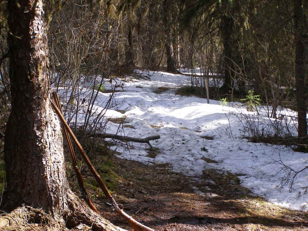

Here's a few looks at our trail walk's course, with moslty steel targets.
The little orange pig or buffalo in front of Taylor is a pistol target. The rifle target is behind his left hand, a ram on a chain, on the cross branch.
bunny above the black hole at the end of this shooting lane - about 95yards. We've had 4 smoothbore shooters nail the bunny in a row. Once!
the start of the trail, November.
start of the trail mid April
92 yard fox
92yard fox on telephoto
flying goose station;
last target 109yards (100 meters)
It's a bit more lush, in the summer time.
Hatchet Jack
Taylor
Crispy
LB
