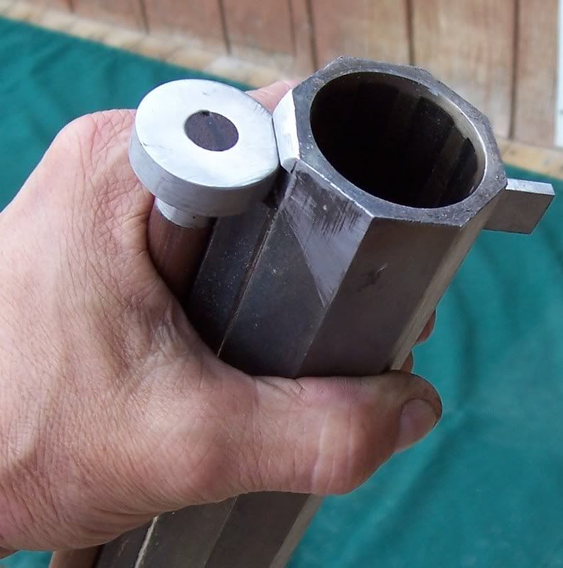

In response to 1911's and Jim's post, here are some crowns and the method I use for 'changing a machined crown, into one that works with tight loads, easily.  If I head over to Taylor's I can chuck the barrel up in the lathe and use emery on a tapered wooden plug or the same emery on a small diameter 'electric hand drill-type tapered stone which, along with it's 3/8" shaft, provides a good hand hold, fingers pinching the emery onto the stone.  This 'sets' the taper I want, whether it's done on the lathe or by hand, with a wrist-twisting motion, turning the barrel often to make sure it's evenly cut/ground.  I finish with 600, then usually crocus cloth on my thumb- by hand or with a finger if using a lathe. This turns a fairly sharp angled machine cut, into a nice smooth radius that helps the ball to conform to the bore, without cutting or pushing up a ridge of lead, as a sharp edge or corner can.
Here is another crown, that 's actually been 'finished'  by the rifle's maker - thisdoes not happen often.  This a work in progress Squirrel rifle by Steven Zihnn.   You wait for the squirrel to run up the muzzle to the peanut oil dipped over-powder wad, then you pull the trigger? :D

Thank you, thank you, Daryl. These photos go in my permanent(?) gun file.
