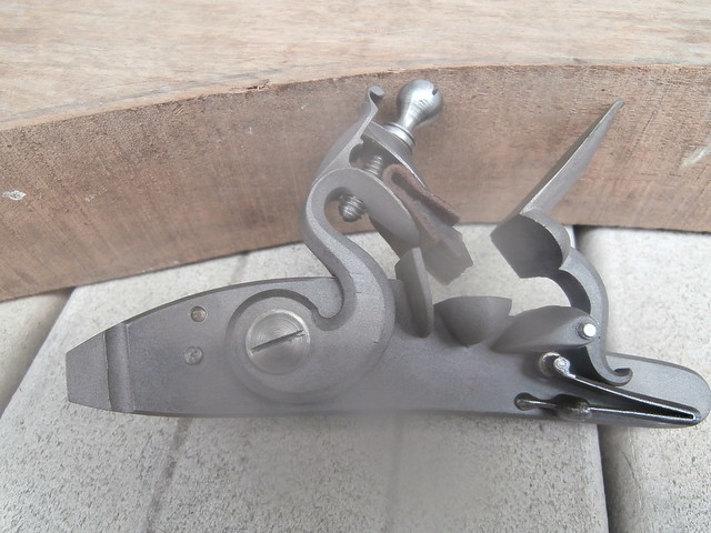

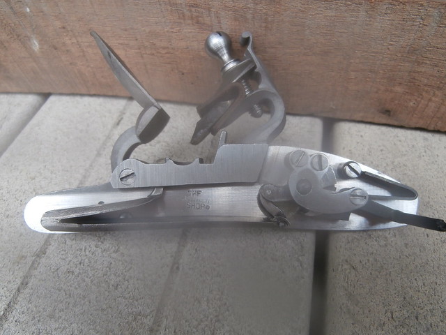

Had a few parts lying around, such as a walnut half stock, a brass butt plate, single trigger, and materials to make thimbles and a trigger plate. I decided to try and make a turkey/waterfowl gun for under $200 more in cash outlay. Bought a $30.00 12ga round tapered 30" barrel from a forum member. Also got a flintlock from "The Hawken Shop" for $102.00. I'll need to get a barrel rib, lower thimble, and trigger guard for under $68.00 to meet my goal.
The lock was a pleasant surprise. It is fitted and polished and smooth as butter! Sparks great. Has a roller on the frizzen, and a fly on the tumbler. A very well made lock for that price. The only thing I will do to it, is stone the bottom of the frizzen and the top edge of the pan to get a little better fit. It is ok now, but I can see a little light between the pan and frizzen when closed.

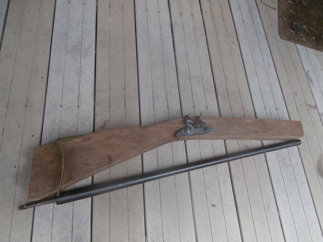

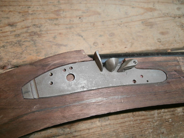

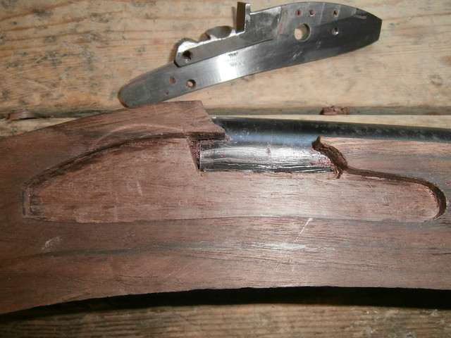

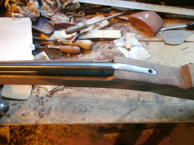

Started on the gun this past week. I inlet the barrel and tang by hand, narrowed the stock blank, and inlet the lock plate.

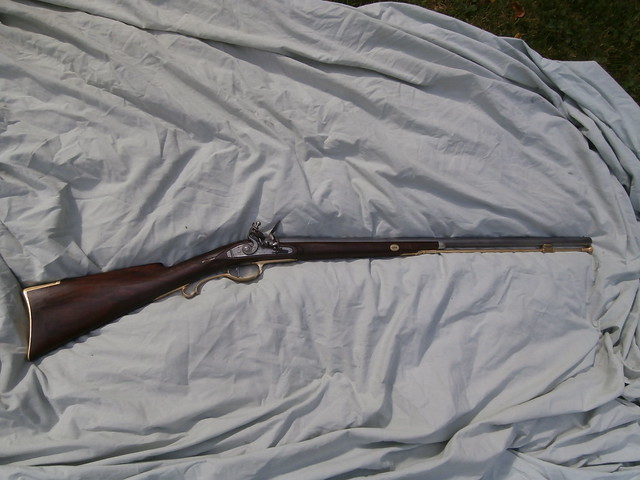

I like the looks of the top picture for the rod thimbles. My barrel is only 30", so I would use 2  instead of three. I also like the idea of a steel ramrod. Where was that gun made?

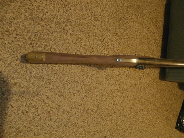

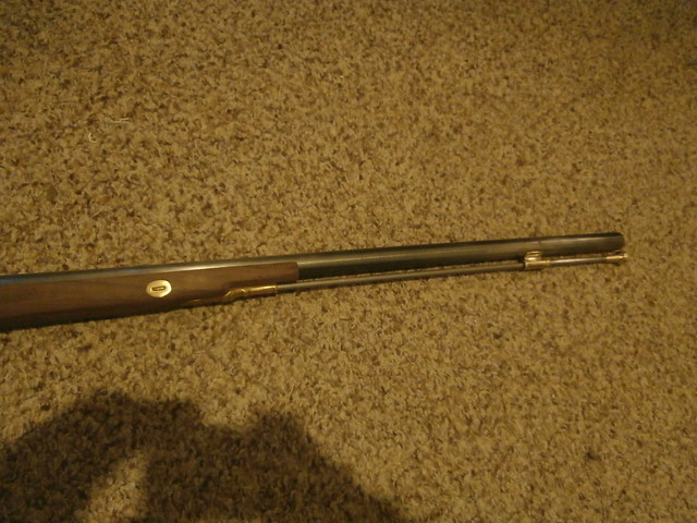

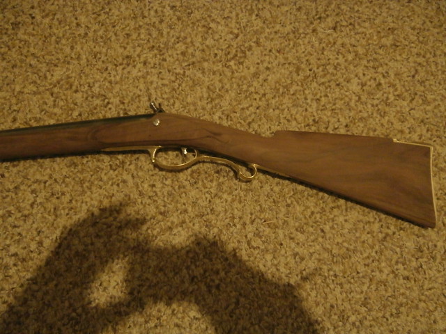

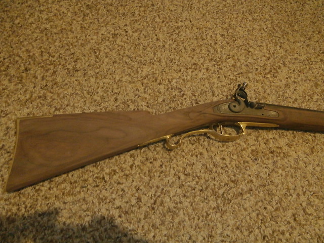

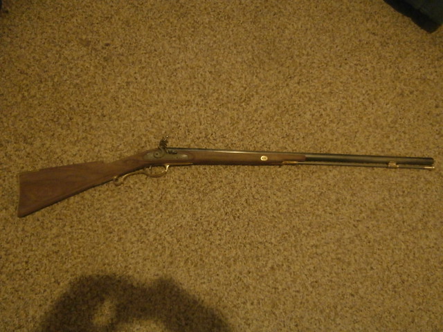

I've been working quite a bit on the gun lately. And, while I realize it is not a longrifle; I thought some would be interested in my progress. I'm kind of building it like I think a riflesmith might have built a fowler, if he'd not seen too many.
I still need to pour or make a nosecap. I proofed the barrel already with over 200 grains 2f, and a double shot charge. I'm still under $200.00 so far, but very close. The gun weighs 5#5oz so far.

A rite fine lookin job so far okabow.The single pipe on the barrel has a nice look,and the overall shape and layout looks good ,too.I kije to do budget restrained projects,too.Tends to give one the motivation to make our own parts when possible.Keep us up to date.Best regards,Dave
