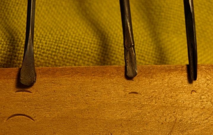

Curtis that is a wonderful job all around but that incised carving is just beautifully done. Which tools did you use?

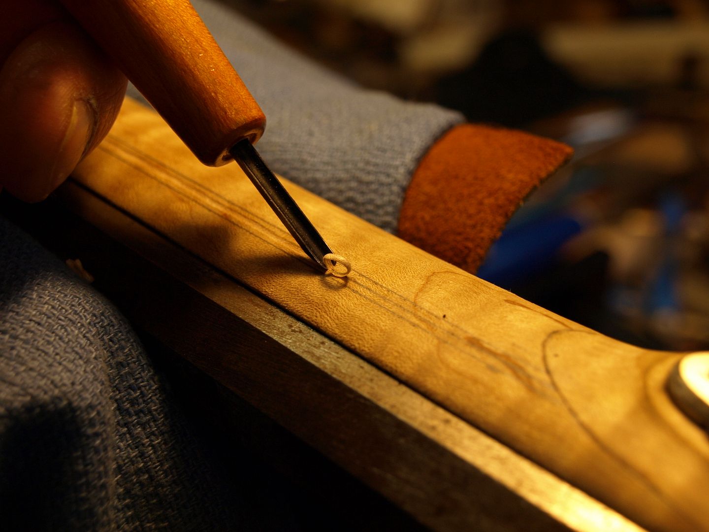

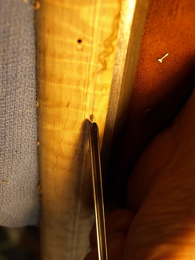

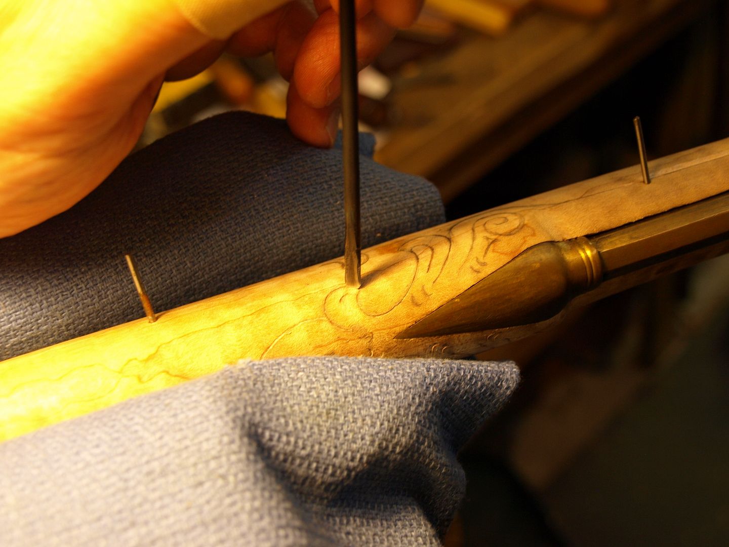

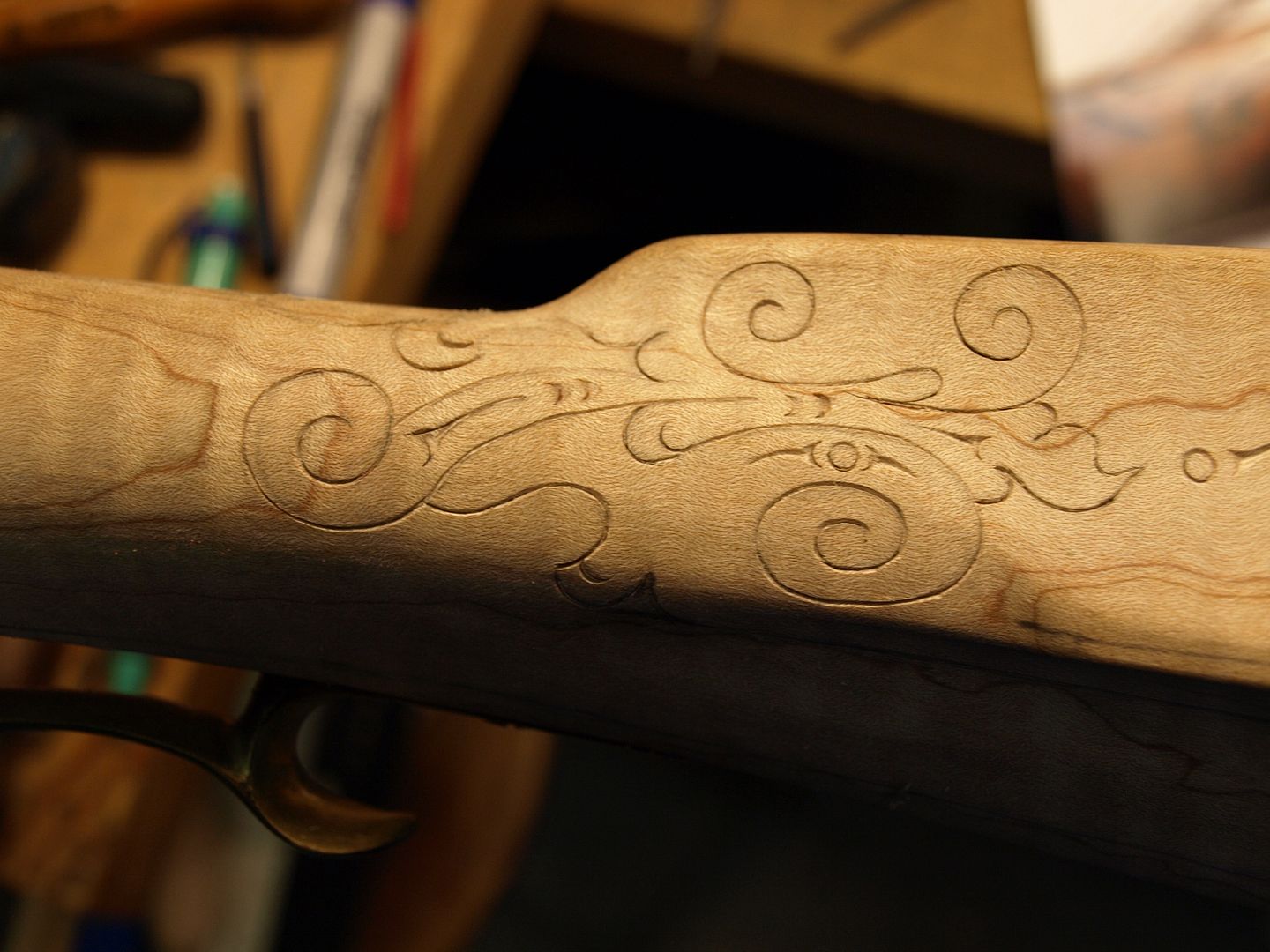

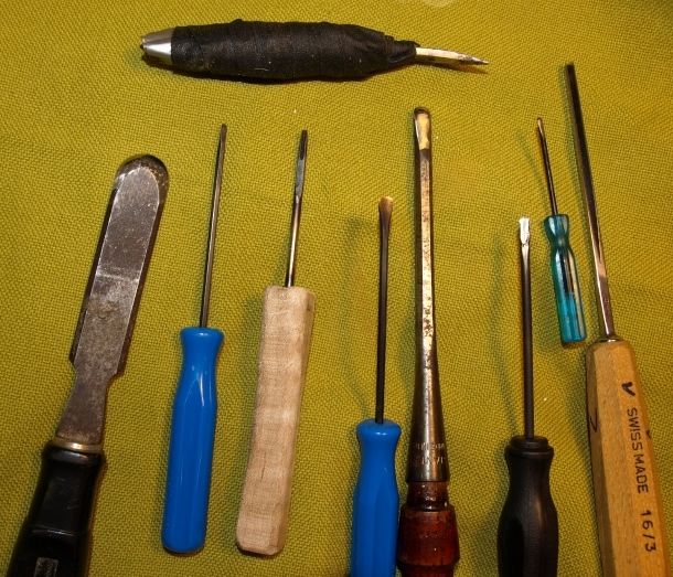

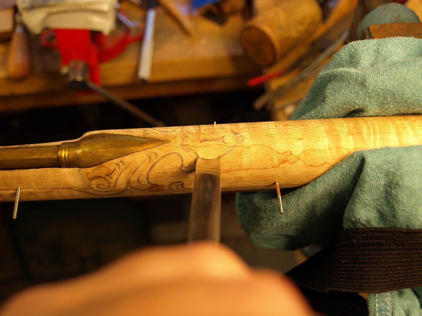

The straight lines, lock panel accents and molding lines on the lower butt stock were cut freehand with a Pfeil 16/3 V-parting tool.   The accent on the fore stock carving was done with a small gouge.  The "moose tracks" were stabbed with a Pfiel 9/2 and 9/3 and the really small ones with a home made gouge.  If I had a gouge that worked out on on a curve I stabbed it.  Most of the curves and c-scrolls were Roll-stabbed with rounded home made gouges and lens shaped chisels.  Pretty much all of the stabbed carving was then chased free-handed with the V-parting tool.  Hard to reach areas were cleaned out with a large sharpened curved needle.

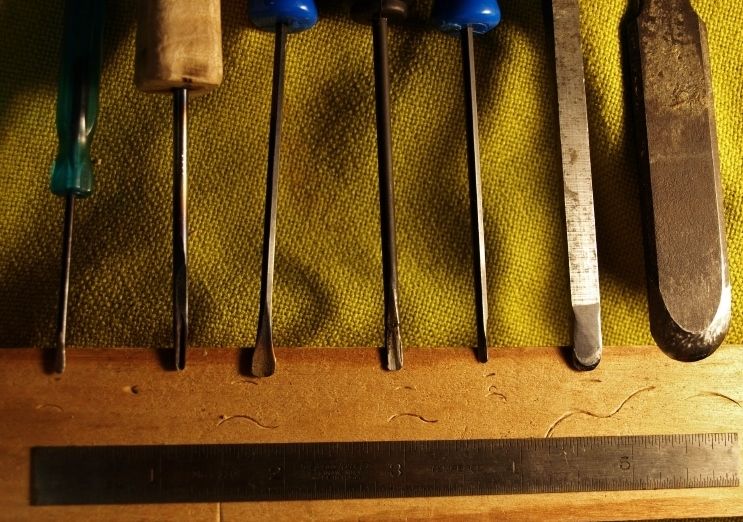

Here are most of the shop made tools I used with an attempt made to show the shape of the blade and some rudimentary stabbing examples.  The tools aren't very pretty but I found them effective:
Cutting scoop with small gouge:
Straight line with V-parting tool:
Roll stabbing with a small shop made gouge:
Stabbing with Pfeil gouge:
Stabbed carving before chasing with V-parting tool.  I found when I chased the stabbed cuts I could correct minor imperfections and vary the incised line width to accent curves etc.:
If you have any other questions about the process feel free to ask.  It may not be the best process for incised carving but it is what worked for me.

Thanks Burnt, and good question.  I didn't really do any mallet tapping on any of the incised carving.  With the V-parting tool, I did kind of a "push-pull" thing for more control, using both hands, often just urging the tool forward by rolling an index finger behind it a few millimeters at a time.  The tool is held at a very steep angle if it is sharpened properly, and the tool needs to be quite sharp.  It would be helpful if I could take a picture of the technique however it's not possible with just two hands, lol.
I tried chasing the V-parting tool with a hammer like Homer Dangler does, however I did not have the control to make the curves look graceful and flowing.  I imagine with practice it would improve greatly, but I tend to just jump in and do things with just a couple of test runs and no real practice.  Probably not recommended for best results.
On the C scrolls and sharper curves I set most of my lines by roll-stabbing.  If you look at the shop made tools the edge of them is curved and not flat like a normal gouge, which makes it easier to roll around a curved line.  I found if I roll stamped a curved line it helped guide my V-parting tool for the final chasing, as well as adding depth.  You still have to maintain careful control, but again it helped stay on course considerably.
