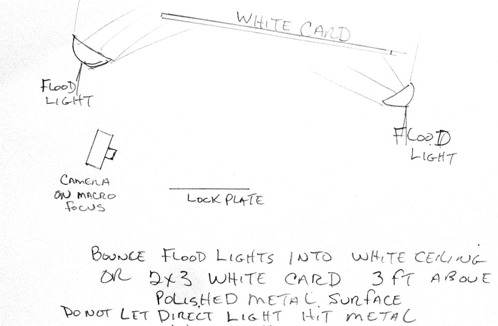

Here is one done in Photoshop from a straight shot
Here is the straight original simple shot
The set up was placed 4 feet from a glass patio door that had a thin sheet of white muslin hung
on it to difuuse the sunlight coming in the window. This was on the left side. you can see the direction
of the main light is coming from the window on the left ( note the highlight on the flintlock cock)
A white posterboard card was held over the set up to evenly illuminate the steel parts by reflecting some light back ito the top of the shot.
A silver piece of mylar packing material ( usually used to ship refrigerated materials ) was held at an angle by the cameras right side
to bounce light into the shadow area.
This was taken with an old point & shoot digital camera (3 megapix  2001 vintage) Shot on the Manual setting so I had control
of my shutter speed & f stop. built in flash was turned off and camera was on a steady tripod. Exposure was about 1sec at f5.6
I will try to post a line drawing diagram of the shot when I draw it up.

On Acers sugestion....What I would like to try to do in a few of my upcoming posts to this photo tutorial is to offer some assistance & explain a few basic concepts which will be geared for folks who want to take some better pictures of their work, but with the simplest equipment. (later hopefully to be followed by a more advance practices)
   First thing I will address is the simple point & shoot digital camera: while these are limited in the quality and features for doing high end photos that shouldn't discourage you because there are a heck of a lot of them out there and most of you will have them.
To get started This is what you have to do:
1) most of these cameras have a "manual setting" if you have never read your cameras' handbook I suggest you do so  to understand how this setting works. This will be the most important feature to use on the simple point & shoot camera. This feature will let you set your exposure for the existing lighting by varying the shutter speed and f stop ( aperture). Any other mode then manual will have the camera microprocessor decide for you and most times it will be wrong with the lighting we will be using in our demonstrations.
2) forget about the built in flash Turn it off... It will not help you.
3) get yourself a steady tripod. (Hint the mounting hole thread in a camera for a tripod is 1/4-20 I'm sure you guys may be able to improvise on a steady rest...it just needs to be mobile to maneuver it around on multiple axis)
Other items you will need will be some light transparent white fabric like muslin to be used to diffuse light.  I would get a couple of yards of this cheap fabric.
Get at least two large pieces of white poster  or mounting board to be used as reflectors. two silver reflectors ( can be made by place alum foil over mounting board or what have you.
Also recommended but I'm sure you can find substitutes are some photoflood lights (2 or 3 if you want to work indoors without window light) and some light stands to hang lights or reflectors on( or a suitable alternative)
In theory: good photography can be achieved with
a) a main light source ( provides the bulk of the light and shapes the object)
b) A fill light source   ( adjusts the light in the shadow areas)
c) Modifiers and highlighters ( used to selectively place light or shadow in the image or controlling areas).
The difference in intensity of  the main and fill light will control "contrast" ( a lot of main and a little fill makes for high contrast or deeper shadows & Equal amounts tend to provide low contrast---- High contrast is harder to work with Low contrast is easier to work with) Higher contrast can help at times to bring out detail in close up of carvings etc. but the proper control of this " contrast"  is necessary to produce good images.
Modifiers and highlighters allow you to throw a reflection of light on things like patchboxes locks & barrels to illuminate them to the degree necessary for you to see them properly within the over all shot ( sometimes you may need to modify the light in a given area by using a card or what ever to lightly block light falling on that section to achieve the results you want).
One of the simplest methods which produce good lighting is what Bill was talking about in the start of this tutorial. Outdoor cloudy day or on an area of only north light the illumination is even but of lower contrast which make it easy to deal with.
by using this type of light and some white card reflectors the results can be excellent has his photos attest to.
Indoors the same type lighting can almost be achieved by bouncing flood light into a white ceiling and using white reflector cards (no direct light on the object)
Now if we were to add some main light to this overall soft light It would make the soft light the "fill" and this additional light the "main" this can be achieved by reflecting some sun via a white or silver card across the object to give it more modeling  Now we are getting fancier here but don't get scared this add'l light when placed across the object can give you more punch & dimension  when you learn to control it.... You can pop off carving on a dark stock or accentuate the dip in a cheek piece and if you go slow and easy with it, always watching the changes you are making, you shouldn't get yourself into trouble exposure wise
Keep in mind all the lighting we have been talking about is diffused in one form or another whether it be cloudy sky or bounced off a ceiling or reflected by white cards.
All of it has been modified to some extent & this is what gives you the control to create a good photo.  You can't get a good shot of you gun with the bright sun ( blue sky)  gleaming across it because the shadow to highlight contrast will be to high. It may look good to your eye but it will be out of range for good photo reproduction.
Although an overcast sky with the hint of diffused sun achieves naturally what we are trying to mimic but again this only happens occasionally under certain conditions and we would rather create the lighting when we need it.
Keep in mind I can't address everything here or continue writing a book on photography, but I'm willing to share what I have learned in my photographic profession of the past 35 years, to help you guys get some photos to highlight your super work that you do and be able to present it here if you would like the help.
(to be continued)

« Reply #19 on: April 14, 2009, 02:35:38 AM »
Since it is a good reference to add to this tutorial I will re-post this info for photographing metallic objects indoors:
For a polished metal surface indoors bounce a work light or two off a white ceiling
or a white card about a few feet above the piece. Arrange the card until you see its refection in the piece you want to photograph. Do not let direct light hit the metal only the card or the ceiling.
Also if using a small digital camera try to use manual setting if possible and do not use the camera flash...shut that off.
There should be a setting on the camera for macro focus ...usually it is designated as a flower icon or some such thing that will help if you are auto focusing at less then 10 inches
 use the above info along with this "crude" drawing
