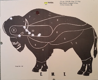

Range Report, Aug/07/2015.
Still shooting without my prescription glasses which seemed to have disappeared.
50yds, 55grs of 777-FFg, 0.530 roundballs from my newly arrived Lee mold, 0.022 Bull Denim patches.
Some of the patches were 0.030 blue denim.
The paper target shot using the bull denim patches.
This dirty-bird target shot using both bull and blue denim patches.
Sorry don't know which hole is which patch.
Thanks to all - for all of the great information and tireless helping.  ;D
I found only two of the patches, one Bull Denim and one Blue Denim since it's monsoon season and was raining cats/dogs/pumas, etc.  Those two patches were not ripped but reuseable.
All loads went down fairly easily but did require a tap from a wooden mallet for the start.
Bull Denim (Jo-Ann description here) is natural color and ravels quite heavily during washing.  Have someone either pink (pinking scissors) or zigzag stitch the edges before washing.
Paul    :D  ::)

Range Report for Aug/28/2015.  ;D
All Targets:  50 yds,  52 gr 777 FFg,  .530 RB self-cast,  Bull Denum Patches lubed with Hoppes 9 Plus.
First fuzzy target (sorry)
Second Fuzzy Target (ditto)
That clover-leaf hole has at least four shots through it and I lost count. I started shooting elsewhere not telling if the target was even hit at all.
Third Target
Barrel is becoming smoother to load and I'm starting to calm down a bit and not jerk the trigger.
For this barrel this is the 50 yard load and rear sight setting.
After we move this month, I can go out and do the 100 yard run.
The rear sight is still too close and I may have to relocate it further towards the front to keep it in focus.
Thanks again for all of you folks helping to get this barrel working.
Paul
