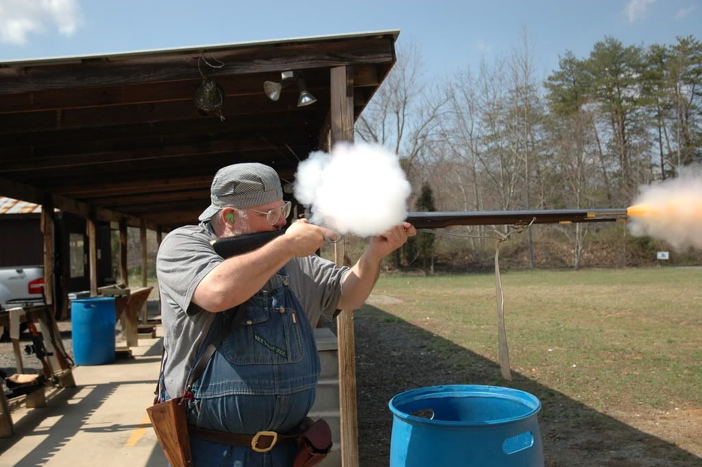

Ricky Roberts and I took our Ferguson rifles to the range yesterday.
http://i356.photobucket.com/albums/oo1/grizzledroberts/100_0335.jpg
Ricky's  goal was to break his old record of 48 shots. to do this
From Ricky's post on another forum
"I did an 18th century tortue test. I did not fire these rounds super fast. As in an 18th century battle there would be no cleaning what so ever. Firing slow perhaps one round a minute of aimed fire The barrel started heating up after 8 rounds. Shots 9 & 10 were shot through a sea of heat waves. After shooting 10 rounds I set the rifle aside for the barrel to cool.
After cooling I shot 10 more. I brought another muzzle loader to shoot during the cooling periods.
I brought 53 greased ball this time. I actually hollered when I shot # 49! I shot all 53 of my rounds when Bryan offered me some of his greased rounds. I shot 7 of Bryan's rounds and took the total up to 60! A little later Bryan was shooting his Ferguson off the a rest to figure out the sight picture, He loaded and fired two more rounds out of mine to see the difference between the two sight pictures. This brings the total up to 62 rounds fired. After round # 55 the action began to stiffen up some from the fouling. But we were still able to crank the action closed into battery. An outstanding day at the range! We stopped at 62 rounds because we were getting hungry not because we only had 62 rounds!
Ever wonder what a rifle looks like after 62 rounds with no maintenance between the shots?"

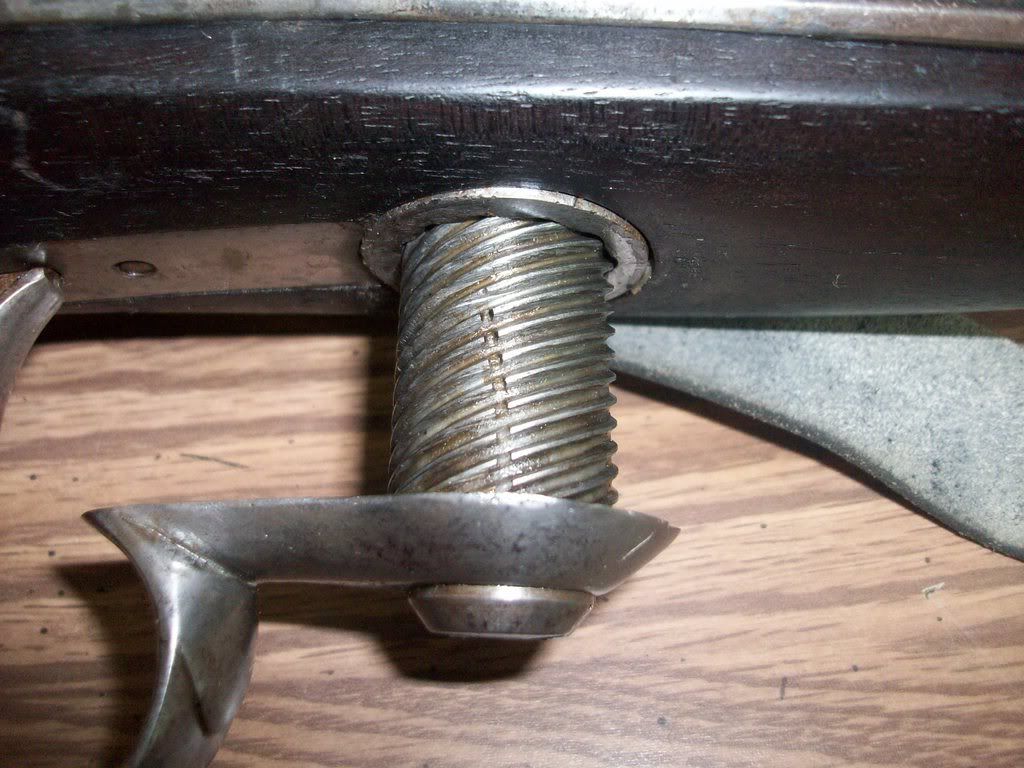

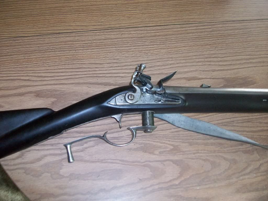

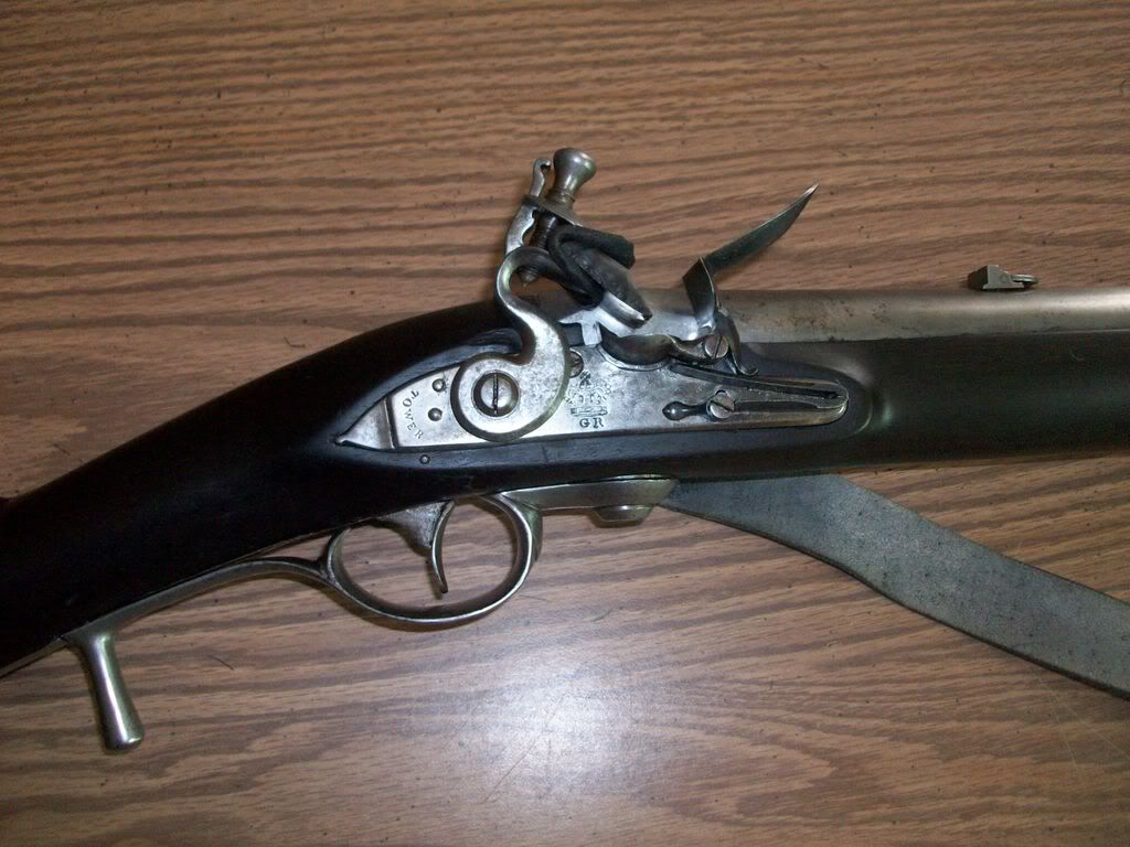

Pictures of Ricky's Ferguson over 1500 total shots fired rather more then any original!!
1. Ferguson Rifle breach closed.
2. The screw breach is attached to the trigger guard. One full turn of the trigger guard opens the breach.
3. A close up of the screw breach showing Patricks Ferguson's 1776 patented anti fouling grooves.
After 62 rounds fired
The wrong lube, or wrongly applied lube can be a challenge to thick or too much creates issues with the anti-fouling cuts and the "touch hole" (in quotes because it is largely a half open cone in the rotation breach)
hopefully that helps some
