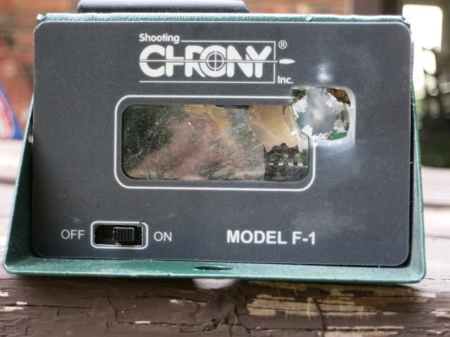

If you don't have a soup can, I'd be happy to loan you my chronograph.
.54 caliber, in case you're wondering how big the hole is...

Jose I just have to ask ::) Did you have to trail it any. By the looks of that hole I would say it went down right there. I have a friend that done the same thing except with a pistol but it was just as ruined
