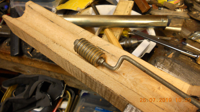

Hi ! and thank you guys and Dennis for help With the video. I will use parts I have laying around . Stock European Alder rest from the Gillespie build, Davis John Twiggs Lock ,. BB trigger gard and but plate dont now

Does the barrel bore have a taper, or is the bore consistent until it gets to the flare?

Hi all!  And thank you guys! Smokey Plainsman, the original I use as a pattern have a very light taper to the flare. My barrel made from Gun metall OM1(CC493K) have 18mm cal to the flare see the start when I make the barrel from start.
