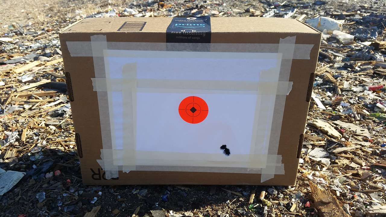

Smokey Plainsman
Re: Slow Twist .40? (1-66)
« Reply #47 on: December 14, 2019, 10:57:20 PM »
Well, yall, I don’t think I need to worry too much:
Shot the gun for the first time at 30 paces (about 25 yards) which I figured would be a good “squirreling range”. Took five shots with 35 grains and ticking cut at muzzle, .395 Hornadys, she’ll shoot guys very pleased. Now I just have to get the sights dialed in.

Very nice, think you would kill a squirrel with that.

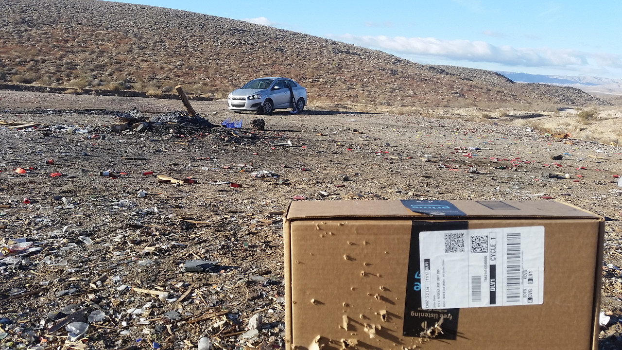

Nice group!
Were does one find squirrels in country like that?
