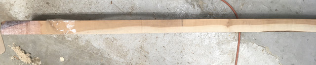

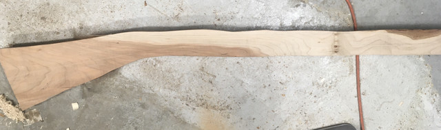

I bought a cherry blank sight unseen with “a little” sapwood. I think some will remain after I lay out the profile. If I use lye as a stain, will the sapwood show?

I’m hoping I can wrangle a stock out of it avoiding the sapwood.  I’ll work on my pattern today then hope to get to a bandsaw soon.  Meanwhile I will practice staining.

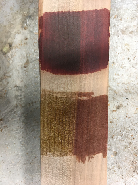

Lye staining doesn’t work on the sapwood but with LMF red, the sapwood and heartwood look almost identical.
I bought this a year or more ago, stuck it in a corner, and pulled it out just recently, so am not going to return it. The blank cost me less than $100 if I recall and so it’s not worth hassling over. Nuff said. I’ll make a back story and be as happy as if I was in my right mind, as my dad used to say.

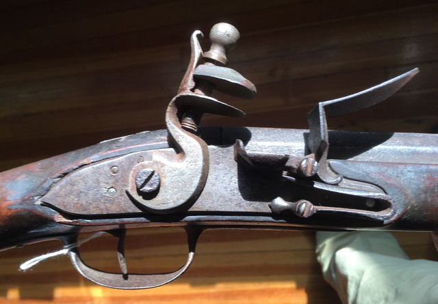

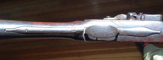

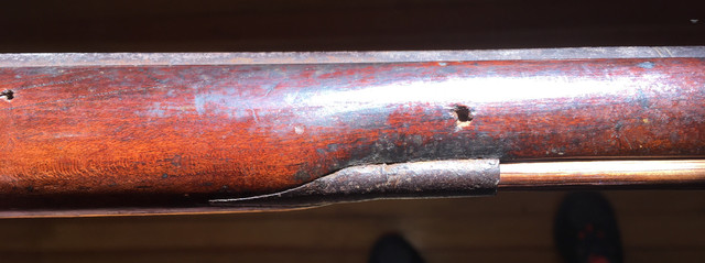

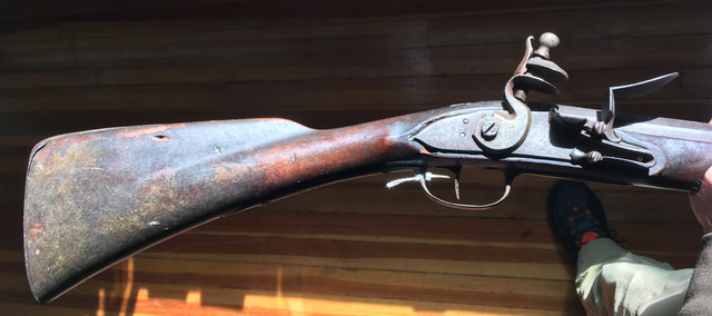

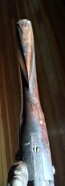

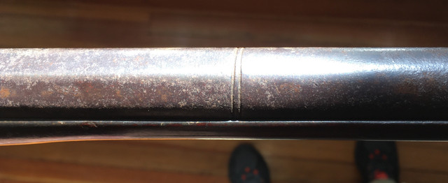

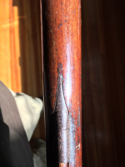

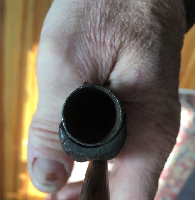

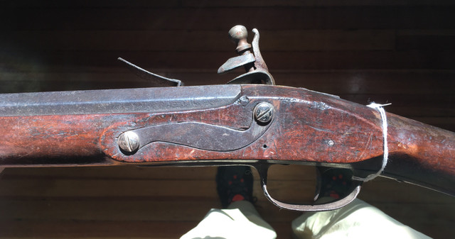

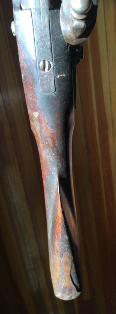

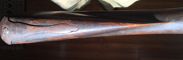

Now to turn the corner on this let me share pix of the original I will base the build on. An auction gun was listed as a French gun. Once that was in my mind I apparently went blind. Yes it was made with 100% French fusil ordinaire parts but it’s stocked in cherry and almost certainly an early New England gun. I have a partially built TRS fusil ordinaire and hate the stock architecture. Too much drop and I could not shoot it with a cheek weld. So I’ll use those parts. Sometimes procrastination pays off. I find the gun below elegant in its lines.

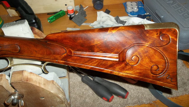

I went back and looked thru my records as well as my related photo files.  I believe that is a blank that you purchased from me.  If you are unhappy with the pc I will gladly refund your money.  I believe it was $75 for the blank, I do not recall the shipping agreement?
I believe that I sent pics of several different blanks to chose from?  I sold several at that times to various folks.  And one fella, maybe you, bought a walnut blank also at the same time.
I remember that there was a lot of sap wood on that pc as can be seen in the photo, but also that it was solid and pretty hard for cherry. I'd try an alcohol based stain.  Still if yer not pleased just say so.
Attached is a photo of a rifle that I completed from a Jim Kibler kit that he used my wood from the very same tree.
Regards,  Brad Foust

This is the sapwood/ heartwood boundary stained with LMF vs AQF. pretty sure I can work with it. Kudos to you for chiming in. I’d forgotten where I got the blank. You’re a stand up guy.

Perhaps a good candidate for aging.   ;)  A darkened and worn finish appropriately done could hide any color difference in the sapwood, which looks like it will pretty much only be in the fore end.
