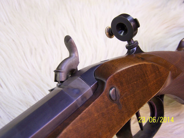

I may try one like this at some point.

That one is backwards, Scota4570.
Eric, Taylor built this Hawken for a fellow from Alaska., The aperture aligned with the barrel sights, IIRCorectly,
as it had the ability to be screwed very low to the top flat of the barrel.
The thread is 80 TPI.

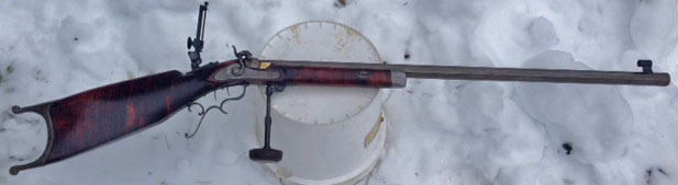

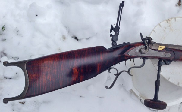

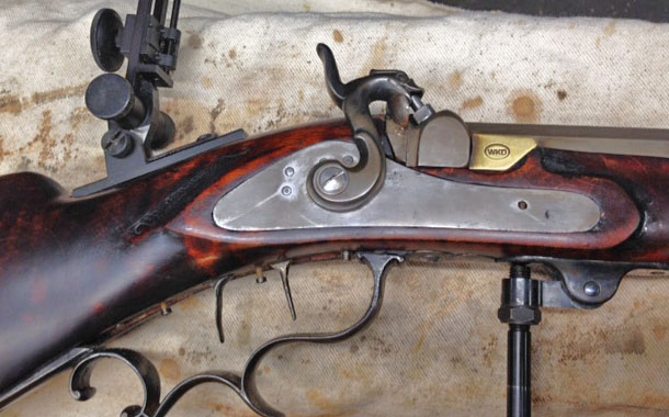

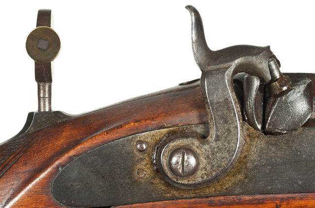

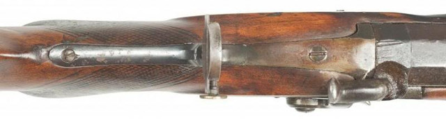

The original question on tang/ peep sights got me looking closer at my collection... Here are some "period correct" mountings on percussion guns from the 1850's to 1870's . Note that on the "lollypop type" all are adjustable with the finely threaded stem and most have windage adjustment capability. Likewise many will "fold down" to allow use of the rifle's rear sight and also for more protection of the sight during storage

Percussion Schuetzen with Pedersoli long range sight.
Kevin

Offline Scota4570
  • Posts: 2680
Re: Peep/tang sights back in "the day"?
« Reply #20 on: January 12, 2020, 01:06:46 AM »
Ok, like this.
I do like the idea of a  fixed,  unobtrusive and sturdy rear sight illustrated.  I have seen picture of originals done like this.  Lolly pops and bent sheet metal are fine for testing but get in the way of your thumb and snag on things.

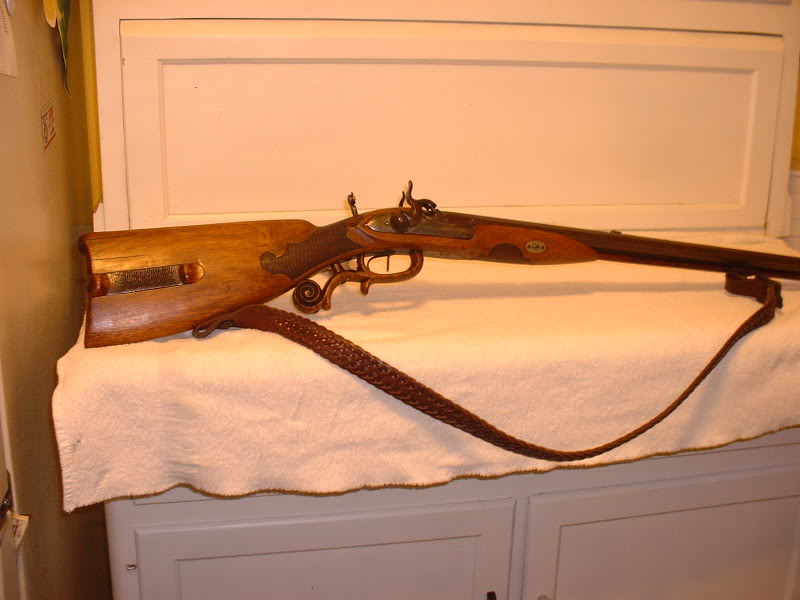

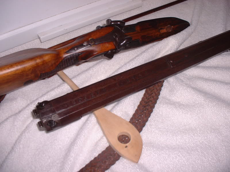

Some time back I was perusing photos of a large bore English rifle built by one of my favorite contemporary makers, Stephen Alexander.  This rifle had a rear "ghost ring" sight mounted very close to the breech which peaked my interest.  I made up some dummy sights and glued them to the barrel of a build I am working on and I love the sight picture through them.  In querying Stephen on the rear sight, he told me that this type of sight was frequently used on Turkish flint firearms and on some English and Continental ones as well.
I did find a few peep sighted Turkish flintlock photos and, apparently, peep sights have been around since Roman days (museum pieces, crossbows from Roman to middle age Europe with peep sights),
Here is the English rifle I built with this type of rear sight on it........works great !
