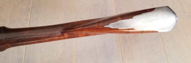

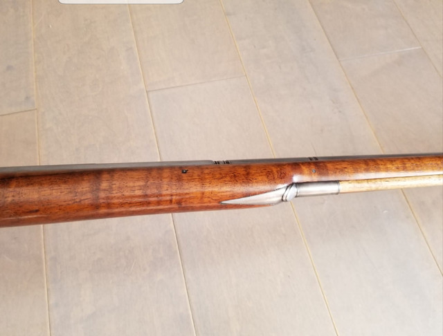

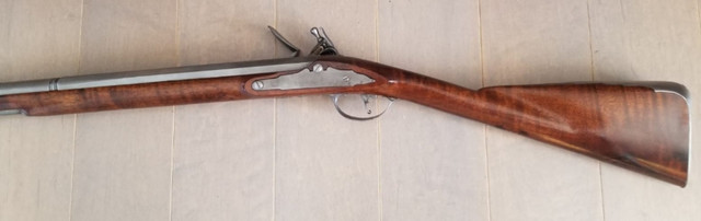

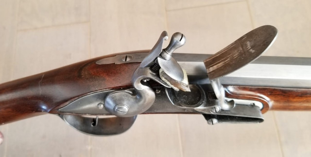

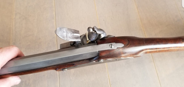

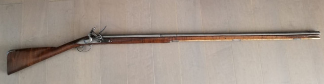

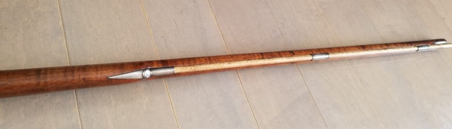

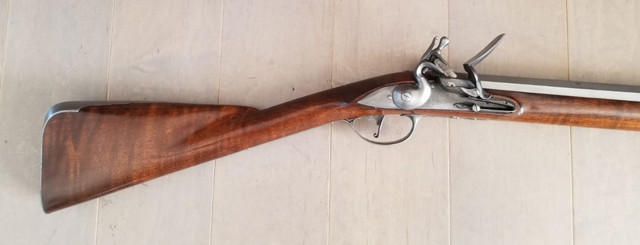

Just got this one finished up. Black walnut stock, 42" 20 ga Colerain barrel, and Chambers Round faced English lock. I did a greyed finish on all the steel furniture.

That's very nice Justin.  It's screaming for some engraving.......

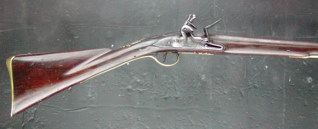

Hi Justin,
Did you ever look at the tutorials I posted on British fowlers?

« Reply #3 on: March 10, 2020, 02:50:02 AM »
This one is going to Vance from Heffley Creek. He wanted a simple, plain gun.  Otherwise I would've engraved it.

Hi Justin,
I did. I followed along with your build last year.
I know that a standing breech with a hump would be more appropriate. I would've liked 1/4" more height in the buttplate too. Any other issues you notice?
Offline BOB HILL
  • Posts: 2281
Re: Finished up a fowler.
« Reply #5 on: March 10, 2020, 12:40:31 PM »
Great job, Justin. I like those slim lock panels. Thanks for posting.

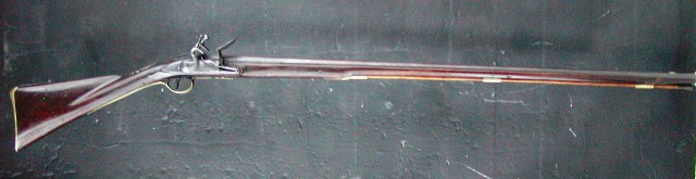

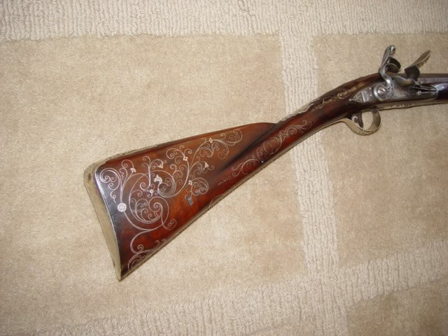

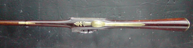

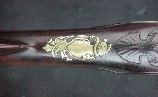

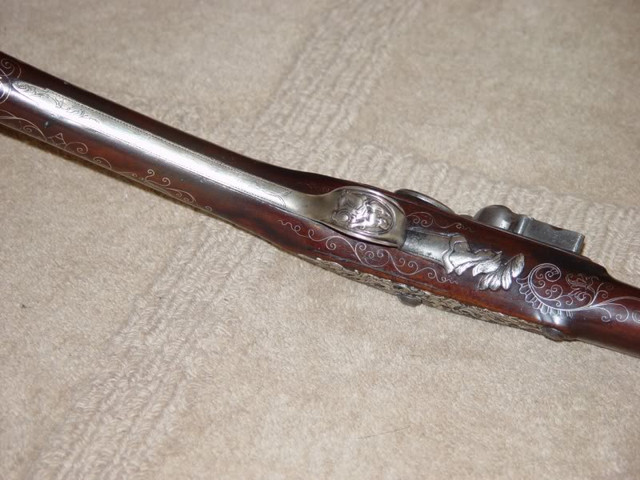

Hi Justin,

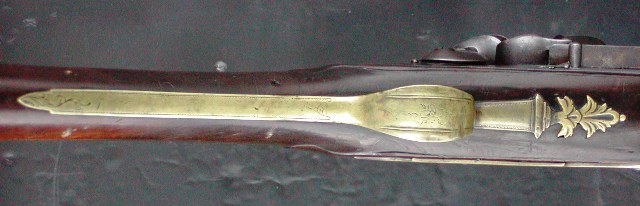

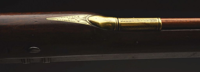

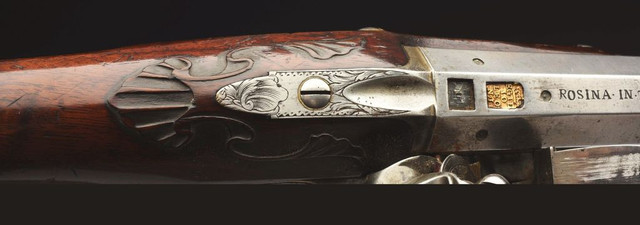

Your gun came out nicely.  Overall, you got the correct profile pretty well and my comments are meant to help you with the details. I assume your objective was an English fowler.  With that in mind, the gun should have a standing breech and hook and given the mid-18th century style, a raised sighting groove in the standing breech.  It also should have barrel keys rather than pins.  The ramrod pipes should be 5/16" not 3/8" which will allow the forearm to be slimmer particularly at the step.  The baluster wrist could extend further into the butt and the radius defining the comb should be more parallel with the wrist such that the shadow it creates does not intersect the top of the comb as yours does.  The top of your comb is too close to parallel with the barrel like a Brown Bess and should angle downward slightly more toward the butt plate. The tails of your lock panels stick out a lot suggesting to me that the wrist could be wider.  It also appears the side plate panel is shorter than the lock panel. You did a nice job on the width of the flat around the lock.  Carved beaver tails would enhance them greatly but many English fowlers of that period did not have them. Below are photos of some original fowlers that illustrate my comments.

Thank you for the advice Smart Dog. I'll apply that knowledge to my next English fowler.
This gun was made as a pretty basic, no frills gun.
My main reasoning for not using a standing breech, is a lack of availability. None of the typical suppliers have any, and I couldn't get through to The Rifle Shoppe after multiple phone calls.
I don't have a welder or machine tools to make one myself.

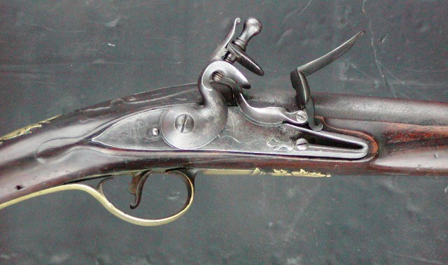

  • Posts: 13415

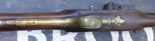

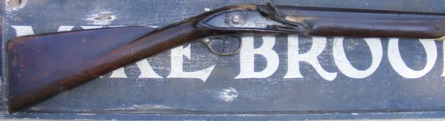

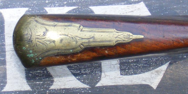

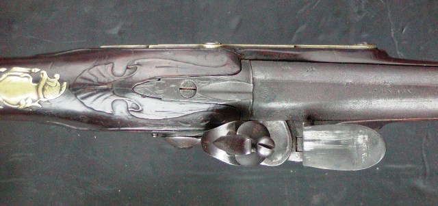

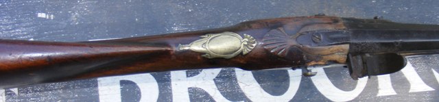

Your gun is fine. Not every English fowling gun lives up to smart dogs criteria. Most everything that got to the colonies did not have a standing breech or keys. I have one here that has no standing breech or keys. Look in "Frontier Guns" By T.M. Hamilton. Take a look at the "Duncan" fowler. My gun is an exact duplicate. Guns of this quality were seen far more often in the colonies than the high end guns that mainly stayed in England.
 You did really well with it.
  • Posts: 13415
« Reply #9 on: March 10, 2020, 06:02:16 PM »

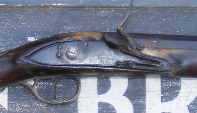

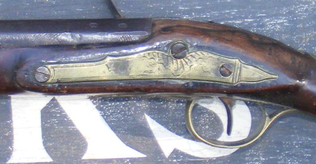

I even have pictures! I think this is post 1785 and possibly made for the indian trade in the 1812 era. The trigger guard would lead you to believe otherwise but I'm dating the gun by the lock which is marked "Ketland & Co. Very slim gun with a 48" barrel and a very petit wrist, no spare wood any where even though it isn't a high grade gun. Your fowling gun is probably the best work I've seen you do, very well executed.

No, it has nothing to do with what looks better in some eyes but what is historically accurate.  My point is not that someone should build a gun as I suggest but that if someone wishes (and Justin did not say this but I suspect he had this in mind) to call a gun an English fowler, it should look like and be made like an English fowler.  I respectfully disagree with Mike Brooks because he mixes trade guns, low quality export guns and British-style American fowlers with guns typically called English fowlers. If someone made a gun that they said was a Lehigh rifle that did not have the profile or details of a Lehigh, folks on this forum would say something.  The same holds for English guns.  They have certain details that changed over time and many on this forum are not familiar with those details as they are about American guns. Because I always walk the walk as well as talk the talk, I posted a multi-part tutorial on understanding British fowlers and another on building a historically correct English fowler.  Those tutorials are loaded with detailed information about those guns gleaned from original examples that I own, examined in collections and museums, or of which I obtained photos.  This forum is not just about making muzzleloading guns.  It is as much or more about the study and recreation of American longrifles and their historically relevant  associates, which include English fowlers.  Therefore, understanding and recreating historical details is an important part of our mission.

Well I guess I've been taken to the wood shed now! ;D  My point is, The original I posted pictures of meets none of the requirements of your description of an English fowling gun yet it IS an English fowling gun. The guns you posted pictures of are fine guns that I have always admired. Few of this type of gun made it to the colonies as they were quite expensive. The common export grade of English fowling gun is what I posted pictures of and they were quite common. I thought Justin's gun hit an export grade fowling gun pretty well. With some engraving it would be just about spot on. I have almost always made an export style of English fowling gun as nobody can afford to pay me to make a high end classic English fowling gun with a hooked breech and keys. The quality of my engraving doesn't reach the level of "best" guns either so I have stuck to making Export quality as that grade meets my skill level better. There is a certain price point I have to stay under in order to make a living, generally I have to stay under 4K as the air gets pretty thin at that level and the addition of a hooked breech and keys will put me pretty close to that or over. You build fine guns far better than I ever did as your skill set is far above mine.
 I didn't read your build along as it was pretty lengthy and don't have time to sacrifice over the minutia of high end british fowling guns even though I find them very interesting....maybe when I get retired. Honestly, due to time restraints, I don't read any of the build alongs that guys post here, probably to my detriment.
 Have you ever read the material published by the Museum of the Fur Trade? There is a great article there describing the fowling guns that Sir William Johnson was ordering for his Indian allies. There were three different grades. I don't have that info in hand at the moment but it is very informative. It has some pictures of the different grades as well. Unfortunately they are typically poor quality. Justin's gun would conform very well with the Sir William guns.

Mike, I did not take you to the wood shed.  You know, in these times taking another guy to the wood shed could be badly misinterpreted. ;D  FYI, the second fowler I showed likely spent its working life in America. Justin never wrote that his gun was meant as a trade gun or any gun that was used in America.  The style suggests to me an English fowler and as I wrote, my comments pertain to that assumption.

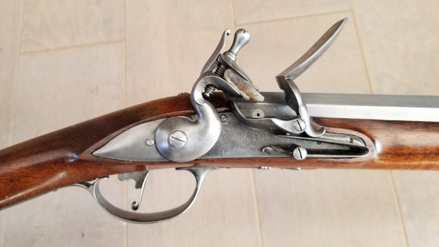

Nice work! If it wasn't for the Coleraine barrel I would guess it is a Chambers PA Fowler kit, because I am building one right now for a forum member, and everything looks the same as yours! Not English.

Thanks for all the comments guys.  Mostly I based this gun on the full sized English fowler plans from TOW. I understood it was more colonial, and trade gun type rather than high grade sporting gun. I can't justify the time and materials spent on a gun of that grade just yet. Maybe when I'm making $6,000+ guns. This is a $1700 gun made for a friend.
