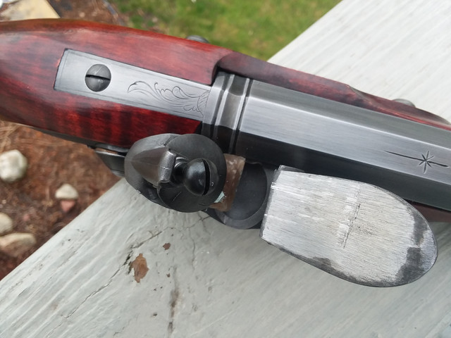

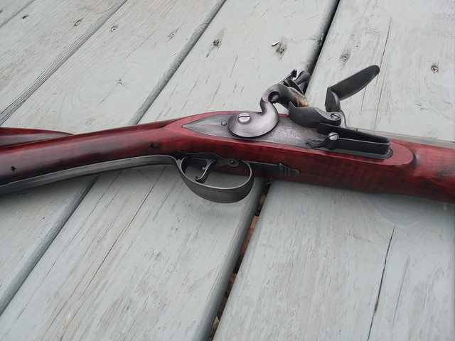

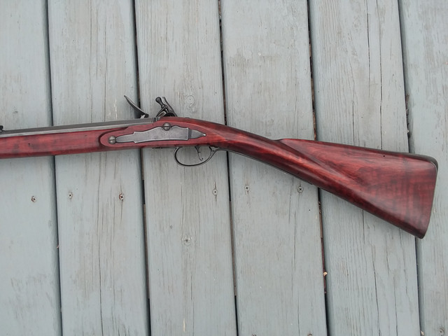

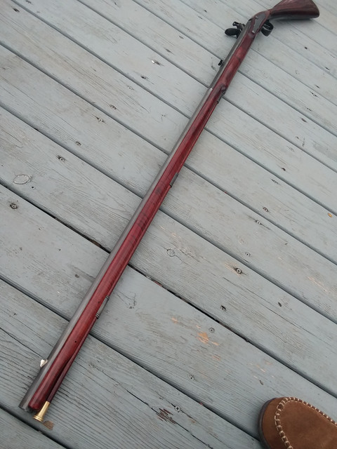

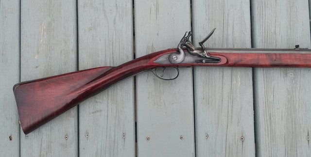

Hi all, I just finished this Chambers PA Foweler kit for "old george" ! It has a 20 ga. x 46" Rice barrel and Chambers Colonial Virginia flintlock of course and all steel furniture. He wants it for hunting and not competition shooting so he had me install a rear sight. He also wanted it dark and red! Got it!
Total time involved was 51 hours, for those who are curious about how long it takes to build a good kit. Sounds like a lot, but this was my 70th build, so I am not a beginner, I just take time to get things right.

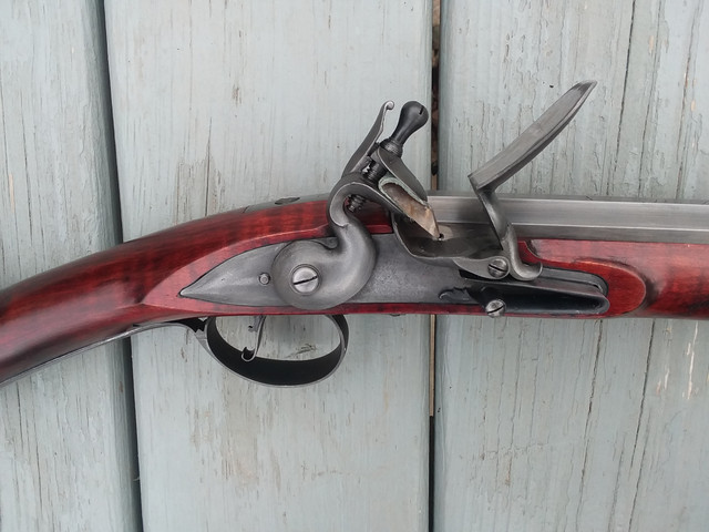

Tom, that is a fabulous build. I bet it will be a wonderful field gun.  This isn't a negative comment on the gun, but I just wondered if it would be incorrect to angle the stock at the breech down to more closely match the octagon barrel flats ?   I've noticed this often happens on rifles, but have not seen the same treatment generally done on fowlers .

Nice clean gun.  Understated elegance. Nice touch with the barrel and tang treatment.

I like it ;D Tom has been patient and a pleasure to work with. That finish reminds me of fall almost like old sumac.

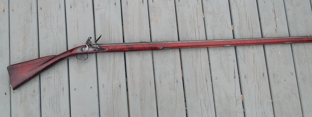

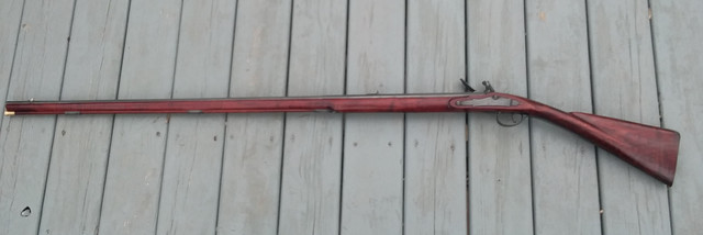

Thanks guys! I added some new pics to the orig. post.

Tom and old George - that is a beautiful work of art and function.  A bit envious of your skill, Tom.
How did you get that wonderful red, Tom -it looks very deep.

Craig, that is a combination of LMF stains. Lanc. Maple, multiple coats of Ebony Toner and Cherry. I also tinted a cpl. coats of LMF Finish with ***lazirine(?) Crimson artists oil paint.
Tom C.

That greyed metal and red stock is striking. Super.

Picked up my fowler from Tom today. I'm very pleased with it. These pictures do not due justice to the finish.Thanks Tom

How do you get the grey finish ?
It's just water diluted Super Blue from Birchwood-Casey. Applied with a scotchbrite pad or steel wool. Even diluted it starts out pretty dark blue....just keep rubbing until you get it where you like it.
