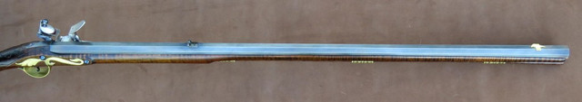

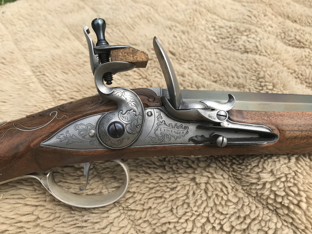

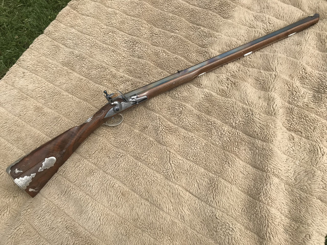

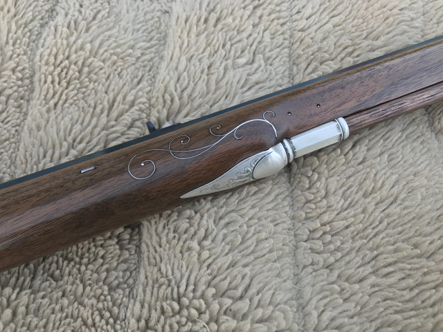

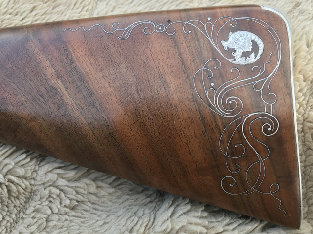

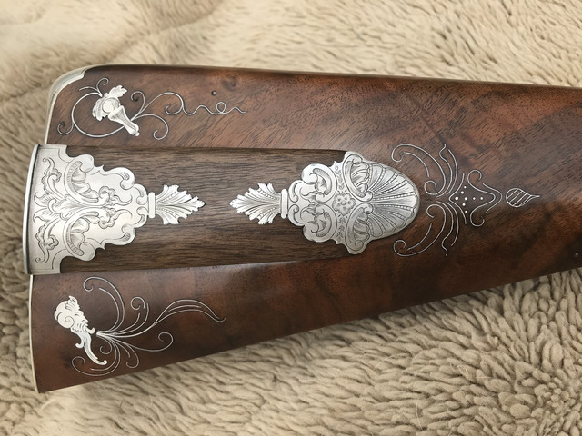

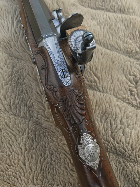

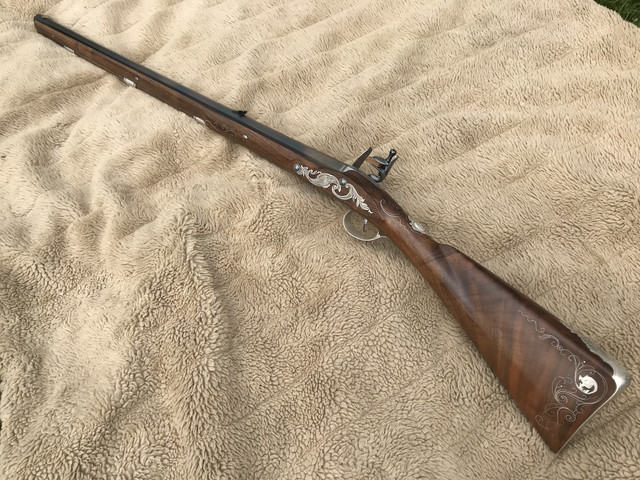

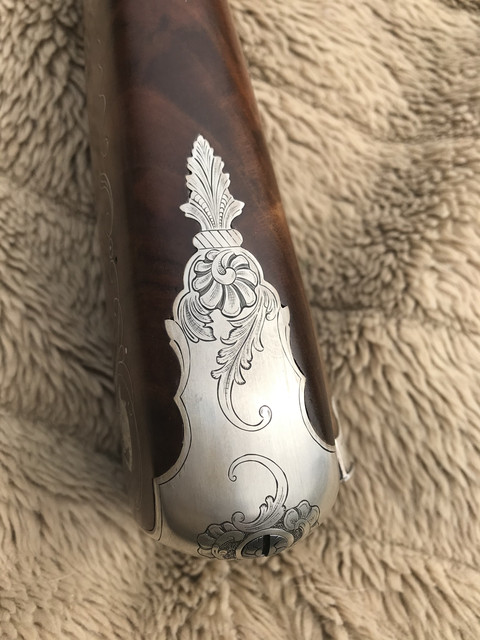

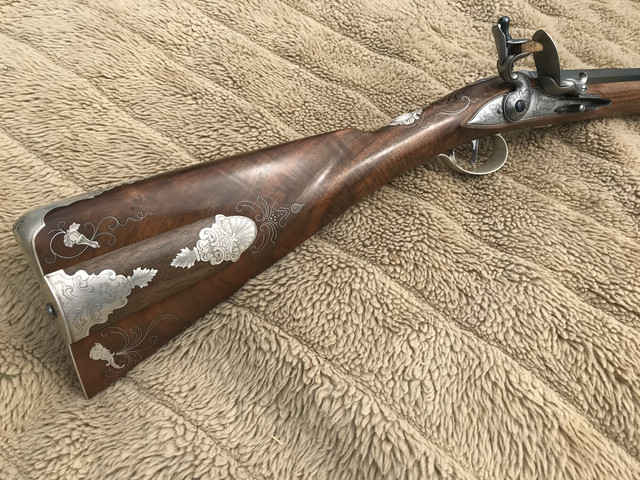

I guess I’m jumping on the Curtis and Dave English gun band wagon!  This is a Chambers English Sporting Rifle that Barbie tempted me with a couple years ago..., thanks Barbie!  It was especially tempting since she had the silver butt piece, guard, and side plate.  At any rate, I’ve been working on it here and there for the last several months, and here are the results.  It’s probably a little more decorative than most English Sporting Rifles, so my apologies to the more “traditionalists”.  The ram rod pipes were fashioned from sheet silver.  The stock was finished with a combination of checkering oil and Alkanet Root varnish.  I also scrubbed the stock with rotten stone and paraffin oil to cut the gloss.  The barrel was heat blued.  I was going for an effect that I saw in a photo (included), which I didn’t quite achieve, but decided not to alter, or “fix”.  Anyway, here it is...   I’d be happy to answer any questions you might have, or comments.  Best,
      Ed

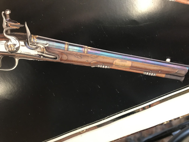

This is the effect I was going for with the fire blue.  I’ll live with what I got.

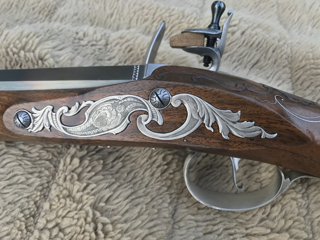

Presentation grade plus! Is that side plate inlet only at the bolts and surface mounted otherwise?

Hi Ed,
Fantastic.  The engraving, inlay, and wire work are superb.  I love mythical creatures and monsters.  They add such a classic touch.  Your rococo shell is the same design I intend to use on the officer's fusil.  I like the ones that roll in from a side.  Ed, one trick that I found worked for the heat bluing is letting the barrel cool a bit so you can handle it and then polish it with rottenstone and raw linsed oil.  The oil will darken the blue if the barrel is warm.  Clean it off and degrease, and then heat blue again and repeat the polish.  I think you will find that the color deepens and evens if you do that.  Great gun by one of the best!!

Excellent piece.  Love the wire, inlays and engraving, not to mention that tasty little tang carving.

I had the same issues as you did on the barrel.
Definitely easier to do smaller pieces ; )

Smylee..., the side plate is inlet into the wood.
Dave, thanks...., and thanks for the tip!
James..., I like your barrel better!  That’s kind of what I was shooting for, a lighter blue with some more colors thrown in.  Nice!

Wonderful gun Ed!  She sure is a beauty.  Your engraving and wire inlay are over the top - your engraving gets better and better with each gun you do!  Are you still chasing with hammer and chisel? I have some alkanet oil and am looking forward to trying it, love the results you got from it.
What caliber is the rifle?

Curtis..., who do you think I am, Mitch Yates !😂.   A lot of the shading was done with hand (push) engraving, but the vast majority was done with a Lindsay palm engraver...

Another triumph !!!  I have only built one kit gun and it was the same Chambers English rifle......lovely lines and just a nice gun to carry.  Yours is magnificent with the silver hardware and your precise work.  Bravo Zulu !!!!!
I understand the heat bluing you were looking for.  That kind of blue is generated by a reaction between the steel and the oxygen in the air at about 550 degrees F.  To control that more precisely, and to try to make that kind of heat bluing more durable, I am building a long copper tube heat chamber that a barrel can be placed in.  The tube is heated electrically and the temperature over the full length can be controlled fairly precisely.  At the same time, pure oxygen (100%) can be bled through the tube rather than just relying on atmospheric oxygen (~20% of the air).  I'll let you know how it works when I get it done.
