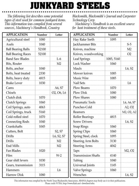

Very old agricultural spring steel is often around 1075 to 1080. You can look up heat treating 1080 and be good to go. My bet is that the average blacksmith recycling this back in the day heated it orange-ish, quenched in water, and tempered by color appropriately for the intended use with serviceable results. But, informed,  temperature controlled approaches will give better results for most applications.
  • Posts: 21120
Re: Need advice please
« Reply #3 on: April 19, 2020, 03:30:55 PM »
Widely used and mostly accurate. Cold rolled steel is obviously not 1070 though.
« Last Edit: April 19, 2020, 03:34:37 PM by rich pierce »

« Reply #5 on: April 19, 2020, 05:49:41 PM »
Nice to have chart, thanks for posting that Rich!  I have several plowshares in my junk pile, it’s good to see they land in the 1080 range. Hay rake times and such are fairly rare here in the mountains...not much ground suitable for hay.
