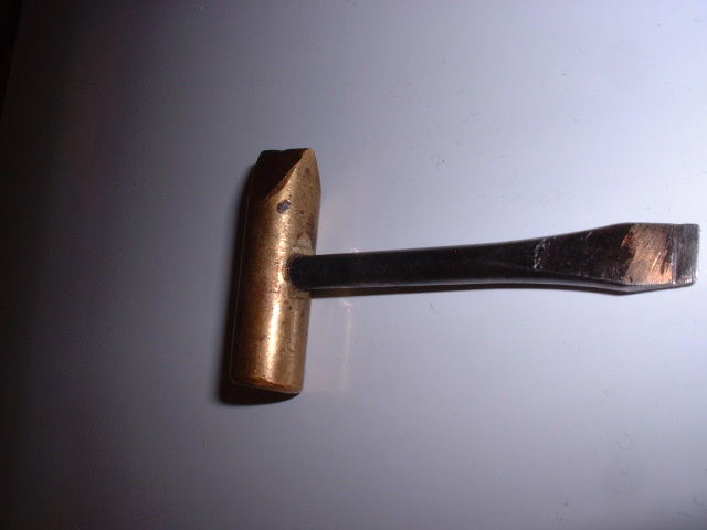

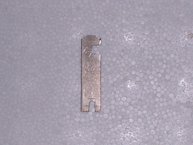

  • Posts: 15822
Re: Gun Flint Field Sharpening?
« Reply #8 on: April 23, 2020, 07:20:53 PM »
I use these, as well as the bottom corner of the frizzen on the edge, just pushing down.
That method works very well on English and French flints.
There was flint knapping thread just a short while back - seems to me it contained a short tutorial by Taylor on method.
