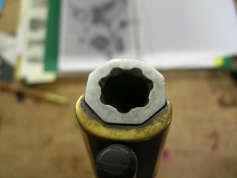

For some time I have been anxious to file out the grooves on the crown of my rifles, but I've been too much os a chicken to take the chance on destroying the accuracy.  I took the leap.
Don Getz said to me that the ball must exit the same muzzle every time, and every time does it the same way.  So how could it effect accuracy?  I just took a round needle file and went at it, filing as evenly as I could by eye, the round bottomed grooves in an already perfect crown.  I haven't shot it at paper off the bench yet, but all shooting thus far is just fine.  I won second place in the Alberta Bullseye shoot at Heffley this year with the rifle, and I have yet to do as well with a rifle in that match, so something must be working.  Here's the before and after...the rifle brand new, and now.

« Reply #1 on: October 09, 2009, 12:17:41 AM »
Hey Taylor,
 That's real nice! Now go ahead and put the "V" notches on the lands!

Re: Filed muzzle crown
« Reply #2 on: October 09, 2009, 12:18:52 AM »
That looks really good to me. I tried one, but filed the lands with a small round file. Looks like yours, but different, sort of. Don't ask me why..I read something in either Muzzleblasts or Muzzleloader about doing it that way. The barrel still shot ok, so I guess it worked. Sure made it easier to load.

But the original crown as in the first picture was the barrel as it was received from Barbie, and I assume the way Rice sent it out.

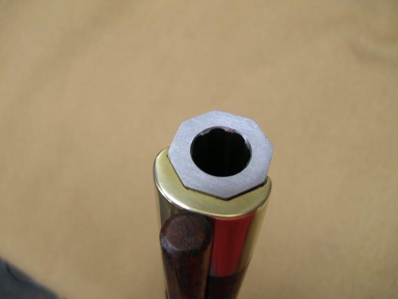

« Reply #5 on: October 09, 2009, 04:01:00 AM »
Here is a crown done the way Tauylor described it, uisng your thumb- in this case, my thumb. This is the way I do all crowns, even when using a lathe, after cutting the shallow bevel, like shown in Tayor's first picture.  This crown, newly machined, is too sharp on the corners of the lands and grooves and is difficult loading a very tight combination. The crown on my 14 bore as pictured, allows easy loading with a pure lead ball only .006" smaller than the bore and a .030" denim patch.  The rifing is .012' deep, so you see, I have about .020" compression at teh bottom of the grooves. Just in case you think this combination will deform the ball and cause innacuracy, it still puts them into 1 1/2" at 100 meters and 1 1/2" x 3 1/2" at 200 yards.
Note that the corners at the tops of the lands, and bottoms of the grooves are smoothed, ie: with a gentle angle.  I call this a radiused crown.  It allows easy loading with tight combinations, combinations that allow unlimited shooting without having to wipe as well as producing the best accuracy a non-target rifle can provide.  I have the same crown on every one of my rifles, 2 of which use oversized balls (larger than the bore) and a .018" denim to .020 twill patches.

« Reply #6 on: October 21, 2009, 11:30:15 PM »
Those are some very good pictures guys. The crown on my rifle takes a rather sharp turn as it hits the rifling, not enough to cut my patches but enough that i can't load a .495 rd with a .18 or .20 patch. I'll be doing what daryl has done to his rifles to my rifle before i go to the range this weekend. then we'll see about those .18 and .20 patches.

« Reply #7 on: October 22, 2009, 01:57:35 AM »
On my Virginia rifle, I did not change the original crown on the Rice barrel, just as it came from the source.  When I did the filing, I only exaggerated the grooves with a round file.  I loaded .023" patches before the filing and still use them.  They load even easier now.  And to my great delight, the filing did not alter the rifle's inherent accuracy.

« Reply #15 on: October 24, 2009, 12:55:14 AM »
Taylor, I've filed a couple of barrels like this...but I ain't got the guns done yet, so I haven't shot them!  I can't imagine that it could possibly hurt anything, so long as it is smoothly done (they don't change from shot to shot).  I have seen so many old guns done this way.  It is almost universal on German rifles.  You have a narrow bevel crown, plus each groove has its own little crown.
I just filed them with a little fine half round file about the same radius as the grooves.
I've tried it with a square groove barrel...with not so much success.  Doesn't quite work the same way.
