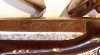

Can you post a picture of the "London private proofs"
  • Posts: 1056
Re: Thomas Fort Fowler ca 1690-1710
« Reply #79 on: November 18, 2023, 09:18:04 PM »
Proof marks on Thomas-marked pistol.  I might have been more correct to refer to it as a Tower Private Proof mark.

Offline James Rogers
  • Posts: 3197
  • James Rogers
    • Fowling Piece
« Reply #80 on: November 19, 2023, 03:58:04 AM »
Thanks for the clarification.  I thought you were talking about those stamps from the tower wharf but wanted to make sure I was on the same page.
