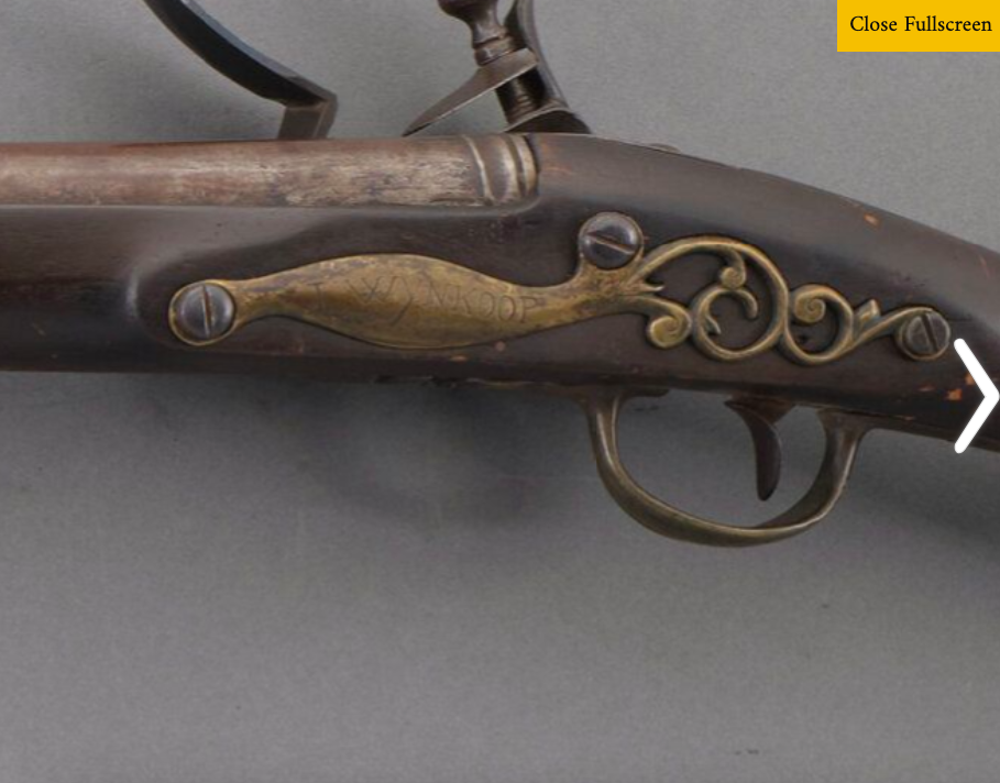

Not sure it's a true parts gun til you splice together two sideplates!
Very cool!
Can you go here https://americanlongrifles.org/forum/index.php?topic=83893.0
and give instructions in exquisite detail on how to host pix somewhere and get a hot link that can be pasted herd without modifications that will give us pictures?
Very cool!
Done. I used the same site you did and had no issues. I hope it helps.

« Reply #33 on: February 16, 2025, 08:42:22 PM »
Very helpful. Thanks!

« Reply #34 on: February 16, 2025, 09:12:40 PM »
Tom, is that side plate backwards? Just struck me as odd the solid section wasn't to the rear.
I don't know why, it just did. Na, guess not, wouldn't line up with the holes. Hurts my neck trying to twist my head around.
Looks GRRRRRREAAAAAAT!
Yeah, pretty cool, right!? It was listed on an auction site as a "Dutch Fowler." Looks like a musket sideplate joined (very well) to a fancy sideplate. It would be interesting to know the story behind it.
Tom Silkowski

« Reply #36 on: February 16, 2025, 10:08:22 PM »
I like that side plate - kinda querky. But I don't see a joint. To my eye it was made that way.
Robert Wolfe
