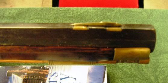

This is a picture of a double based site I took several years back at the Norris Show.  I'm pretty sure it was on a Gillespie rifle.  I'm sure Dennis can chime in but it would be considered a NC rifle.  Others I have seen had the site bases closer together than this one.
I agree with Gary the ones on your rifle seem to be pretty far apart to be for a double based site.
Ken

That looks like the Philip Gillespie rifle that I said had the 37 inch barrel. I know that Sam Everly had that rifle at the Norris show 2 or 3 years ago. Sam had been doing some work on the rifle and he had it on display.

The front site of the first rifle shown was replaced with a new site in a new location.
The Guilford County - Jamestown School in North Carolina is largely known for their double brass dovetailed based front sites.  This was the largest School in the South with at least 87 named gunsmiths.  Around 70% of their longrifles came with double brass dovetailed based front sites.
