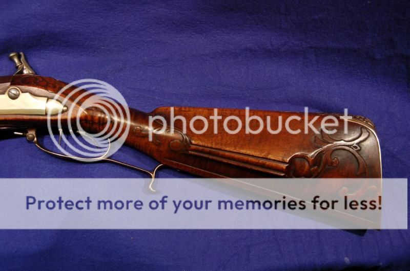

I do all my cheek piece moulding with either a triangular or round file.   I have a large (~10") triangular file that is only used for cheek piece moulding.   I file it the same way I file rings on a thimble or butt piece heel extension.    That is one of the simplest things I do.   It takes mere minutes to add a decorative moulding with a file that is large enough to reach across the entire cheek piece.
The example that Tom shows would just be done with the large triangular file.   I would file two grooves and then round off the part in between.    I would layout the grooves with a pencil line.   The moulding lines and the top and bottom line of the cheek should all converge at the same place.   My point of convergence is generally the apex of the head of the rear lock bolt.   It varies by maker, but that usually works.

When I said that the cheek moulding is one of the last things I do,  I really meant that I did it in conjunction with the cheek side carving.   Actually stock shaping is going on throughout the build process and into the carving.   There are a lot of elements that you must work on at the same time to make sure everything flows together.   Most areas are touched several times throughout the build.   For me it is an iterative process.    I was naturally doing that from the beginning and was later instructed to build that way.   What that means is that my guns don't look finished in any way until they are actually finished.   They certainly don't look like Tom's in the picture where he has done all the background relief and then will do the modeling.   His work looks like it came out of a text book.   Mine looks more like a evolution (from primordial slime   ;) to homo sapien) .   I would normally have carving in various stages of completions spread around the entire butt stock.   My work actually evolves.    I start with a design on paper, but it rarely looks exactly like that on the gun when I am finished.   I start with an idea and it evolves as I execute it.  You don't have to do this this way, but I thought that I would explain that different people have different processes and approaches.  I guess that is really obvious, but for some reason I felt compelled to explain all this.   ::)

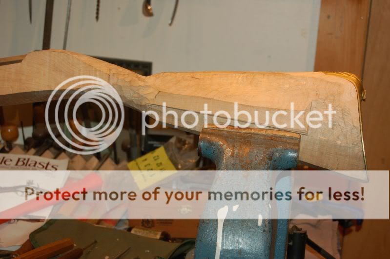

I agree, it's a process of working one area into another, until you decide it's done, or sick of it.   While carving, as Mark talks about, I also do minor stock shaping. Stab the design, cut away background, then rasp and scrape everything smooth. At this point, I turn everything in a slanting light to see the contours. If I see a shadow line I don't like, or a hump or a hollow here or there, I scrape it to the proper contour.
cheekpiece in the early stages. I didn't know what size or where it was going to end up, so I left it large and long.
All those things happened with stock shaping, then carving, shaping, finishing.
