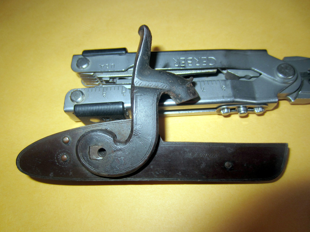

Picked up another decent quality run of the mill English fowler restoration project.  These are still available at very reasonable prices and are a great opportunity to practice/develop restoration skills.
This one is "Manton" marked on the lock with "London" on the barrel and most likely double Birmingham proof marks, but possibly London commercial proof - which I think unlikely.  Cleanup and magnification will tell.  Definitely not Joseph and likely not one of his sons.  Could be a later member of the family, an unrelated Manton or an English-made knockoff.

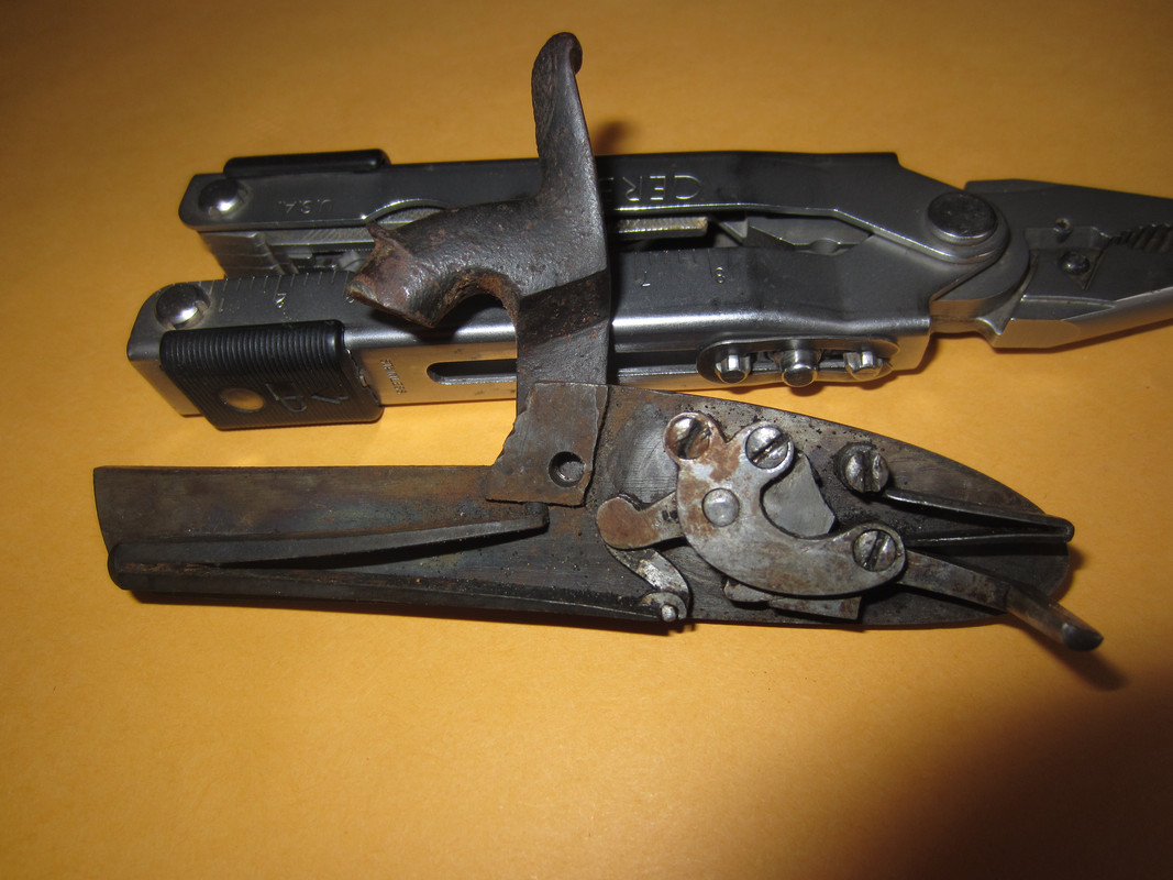

The innovative feature is the location of the hammer screw, which straddles the joint between the hammer and the tumbler shaft.  Although, in my opinion, not as aesthetically pleasing, I can see advantages.  This is the first time I have seen it.
Has anyone else seen this and could it lead to identification of the maker?

Never seen the likes before, Bluenoser.
It looks Slightly related to the Lovell way of attaching a hammer to the tumbler.
The latter I always wonder why we do not see or use it more!

I have not seen this before, but despite its odd look, it leaves more metal in the tumbler shaft, i.e., a more solid tumbler shaft, and I've seen a good number on American rifles where the shaft has snapped off at the lock face, from a hole through its center. It also looks like it would retard the hammer after years of use from starting to get a little loose on the shaft. If the tumbler's screw head is big enough to hide the entire "ugly" off-center hole/shaft, it may be a decent idea.

Thanks for your comments.  I would like to look into the Lovell way of attaching a hammer to the tumbler.  Where might I find info?
Yes, it should make for a more sturdy tumbler shaft and snugging up the screw would correct for any slight loosening of the fit.  It does not appear to be a taper fit.  It would also significantly simplify things if a more aggressive repair is needed.  The screw appears to be the original and it would have been nice if the head were a tad larger since the rear edge of the joint is visible.

The great part about Lovelles idea, is that a cock can be pressed onto the round tumbler and set at exactly the angle best suited, before the hole is drilled and the peg inserted.
It was used on the British P 42 I believe.
Also a round tumbler shank will be stronger than one squared off.  Normal cock screw in centre hole completes the job of course.

Thank you for the comment on my lock making.Looking at this odd interference fit with a pin and IF I was doing it I would use a tapered pin made to a length compatible with this idea and use the hammer screw to make a crushed fit.

Having thought about it, I believe there is a fly in the ointment.  One would think a conventionally placed hammer screw and the addition of a tapered hole on the perimeter would further weaken the tumbler shaft.  A tapered flat wedge fitted to one face of the hole in the hammer might be a better approach.
