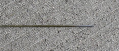

 Taper one end of the wire

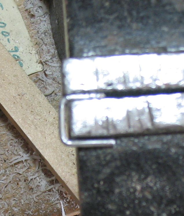

 The first bend, a half inch or so
 The second bend,  Yes one leg is a little longer, I should have trimmed it off
 Clipped off,  taper filed and locked in vice
