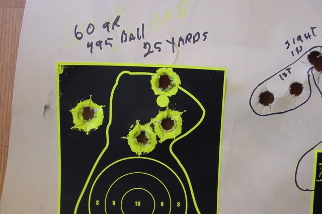

Below is typical 25 yards with thin patch and larger ball, 60 gr of FFFG. Some were significantly worse. Did not try the 480 ball at this distance. Did not get them till a week or two later.

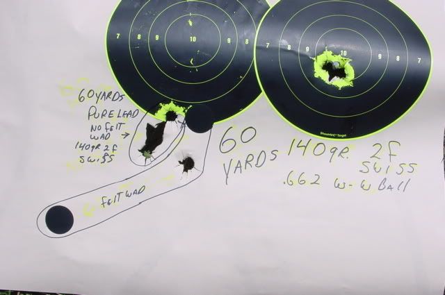

These were shot with the 16 bore while the 50 was cooling. I shoot 3 shot strings with it since its a little  uncomfortable off the bench.
The big group was with a thick soft felt wad under the patched lead ball, the next best was pure lead, the best group was WW alloy with a center hold since 6 oclock seemed to be causing problems with the silver front sight. I consider the WW group to be about as good as I could do.
