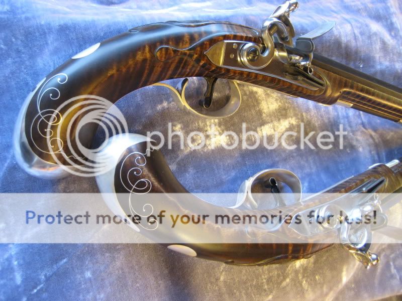

I did this wire inlay with 0,03" round, pure silver wire that I flatten to 0,01"  in a rolling mill.  This gave a strip 0.055" high. When using a rolling mill the wire elongats more than it widens. Your wire will work fine. Roll the flatten wire into a coil, wind a steel wire around the coil to keep the silver wire tight to gether, heat to dull cherry red to aneal. Any part of the silver wire that is not in contact with the other silver strands will overheat and melt.

Rolf,
 A FINE looking pistol. How many hours do you have in polishing that lock.
I can see about four hours of my shop time and that would add $100 to
the cost of the lock.
Thanks for posting this fine job.

Rolf, nice looking pistols.
Indeed, the wire will get longer than wide. It has to be annealed, probably a couple of times, if you are going to roll the wire down in stages.
a 1' piece will probably yield 18" or 2' of flattened wire. Make several thicknesses while you're at it. Wire inlay that is all the same width does not have great visual interest.
