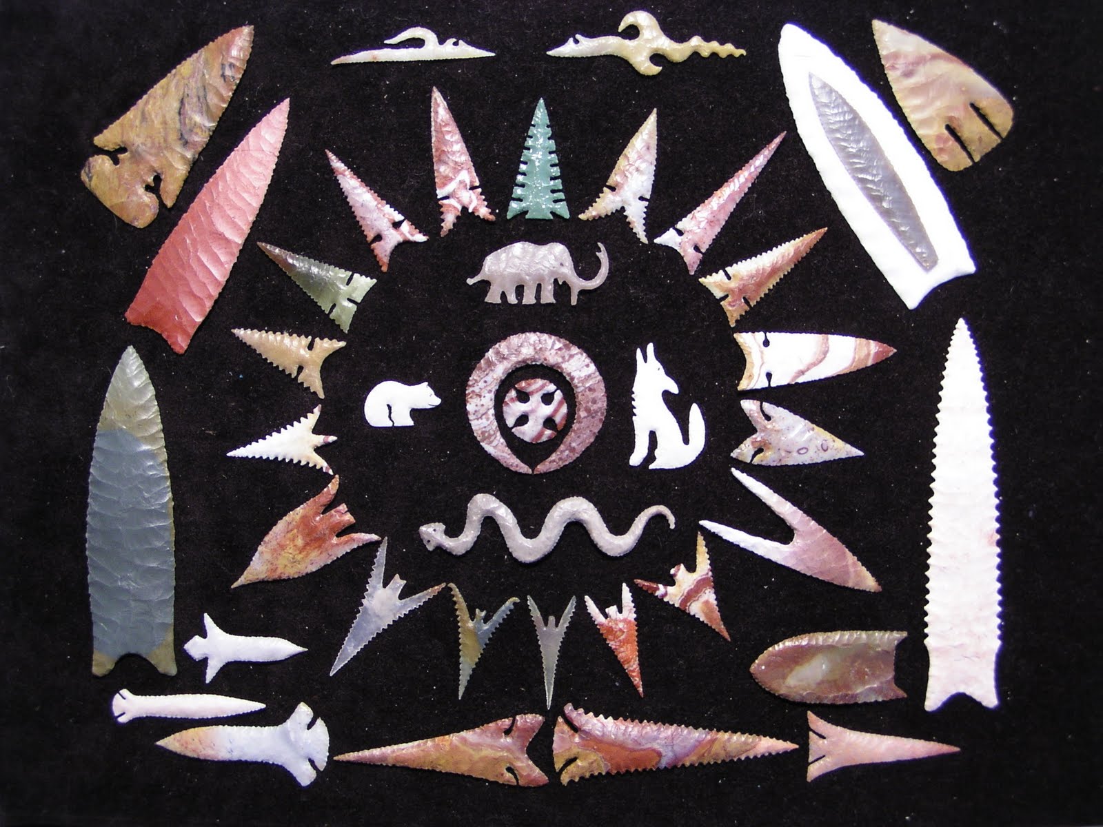

Book on flint knapping. Here is a very comprehensive treaty on flint knapping that should still be available. My copy was printed 2005. It is titled "Flint knapping, Making and Understanding Stone Tools" by John C. Whittaker and published by University of Texas Press.
This one covers all aspects of the craft with a lot of focus on recreating artifacts but does have a section on gun flints. It most importantly details what type of tools are required and how to correctly prepare the spalls. This is an art that requires some effort and practice to become proficient in. I don't knap yet. If you can find some one who does and is willing to teach it would be invaluable if you really want to learn.
I will repeat the caution. You WILL bleed! A friend of mine who knaps all his own gun flints, and demonstrates recreating Native American artifacts had to have his gaul bladder removed a few years ago and got his surgeon to agree to use a flint scalpel he had made.

... You WILL bleed! A friend of mine who knaps all his own gun flints, and demonstrates recreating Native American artifacts had to have his gaul bladder removed a few years ago and got his surgeon to agree to use a flint scalpel he had made.
Sounds exactly like Jim Winn/paleomanjim on Youtube, (I mentioned above).  Here's some of his work:
30 years of work in ten minutes video:
opening shot from that video:
Caution: I do believe that could be addictive.  ;)
