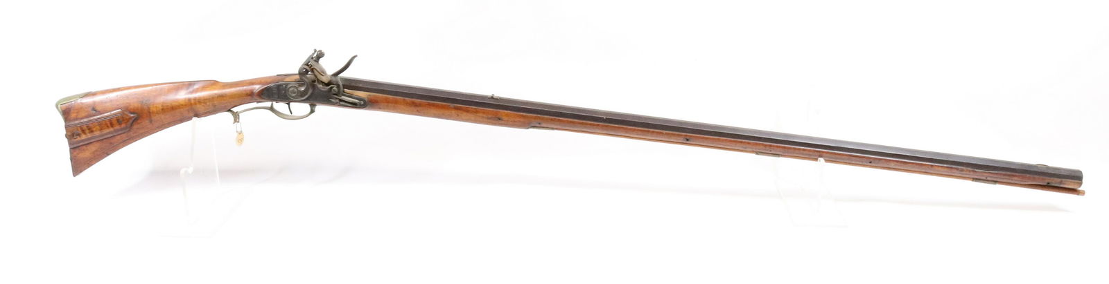

.54 CAL, FLINTLOCK WITH 43" BARREL MARKED "BIRCH" WITH UNUSUAL WOODEN PATCH BOX TO REAR OF STOCK (SLIDES)

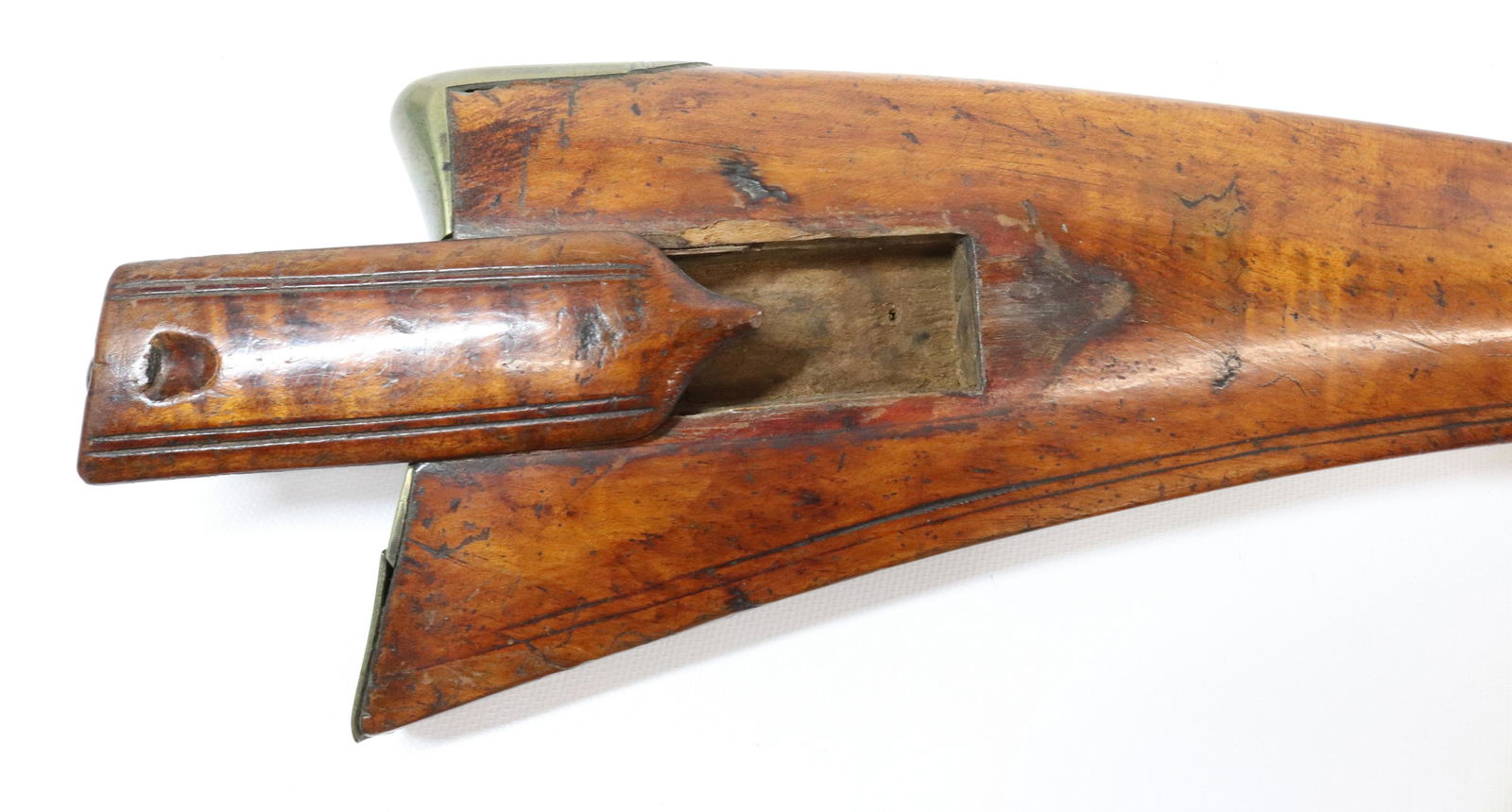

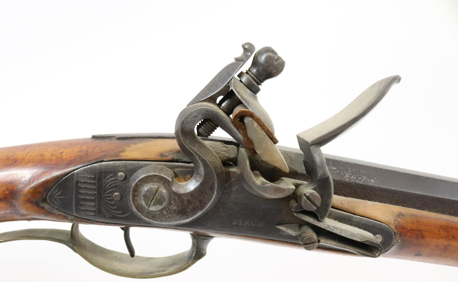

I've been watching this one for a while but of course all the action happens in the last 30 seconds and it's not on my "I'm interested" list regardless.  My thoughts...looks to me like a reconversion and not necessarily all that good of one at that.  I also have to wonder if when switched to percussion, they hogged out the lock mortise for a much larger plate. That patchbox design is interesting as are other details but needless to say I'd like to hear other opinions on its good points as well as bad.

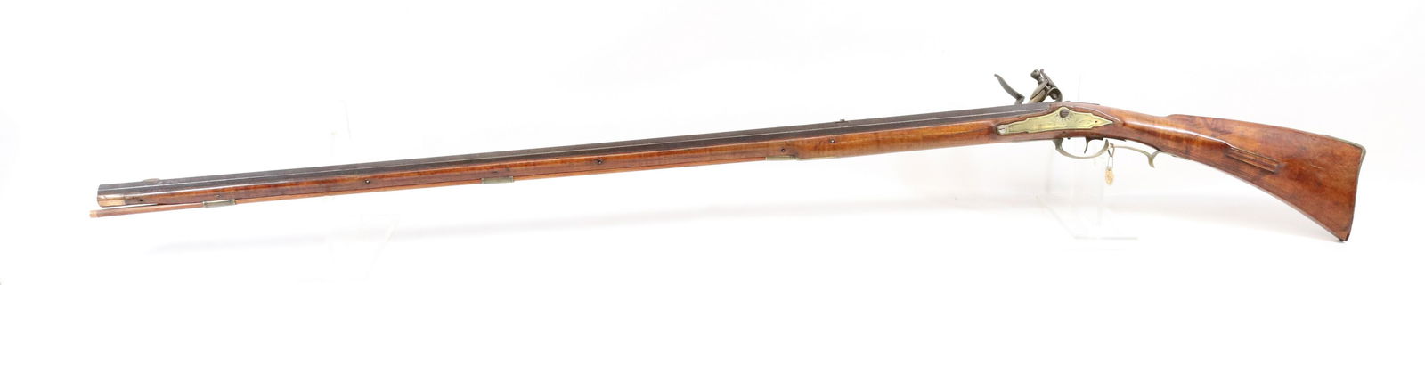

I’d vote the lock has been reconverted like 90% of those appearing as flintlocks. Nice plain gin with good architecture.

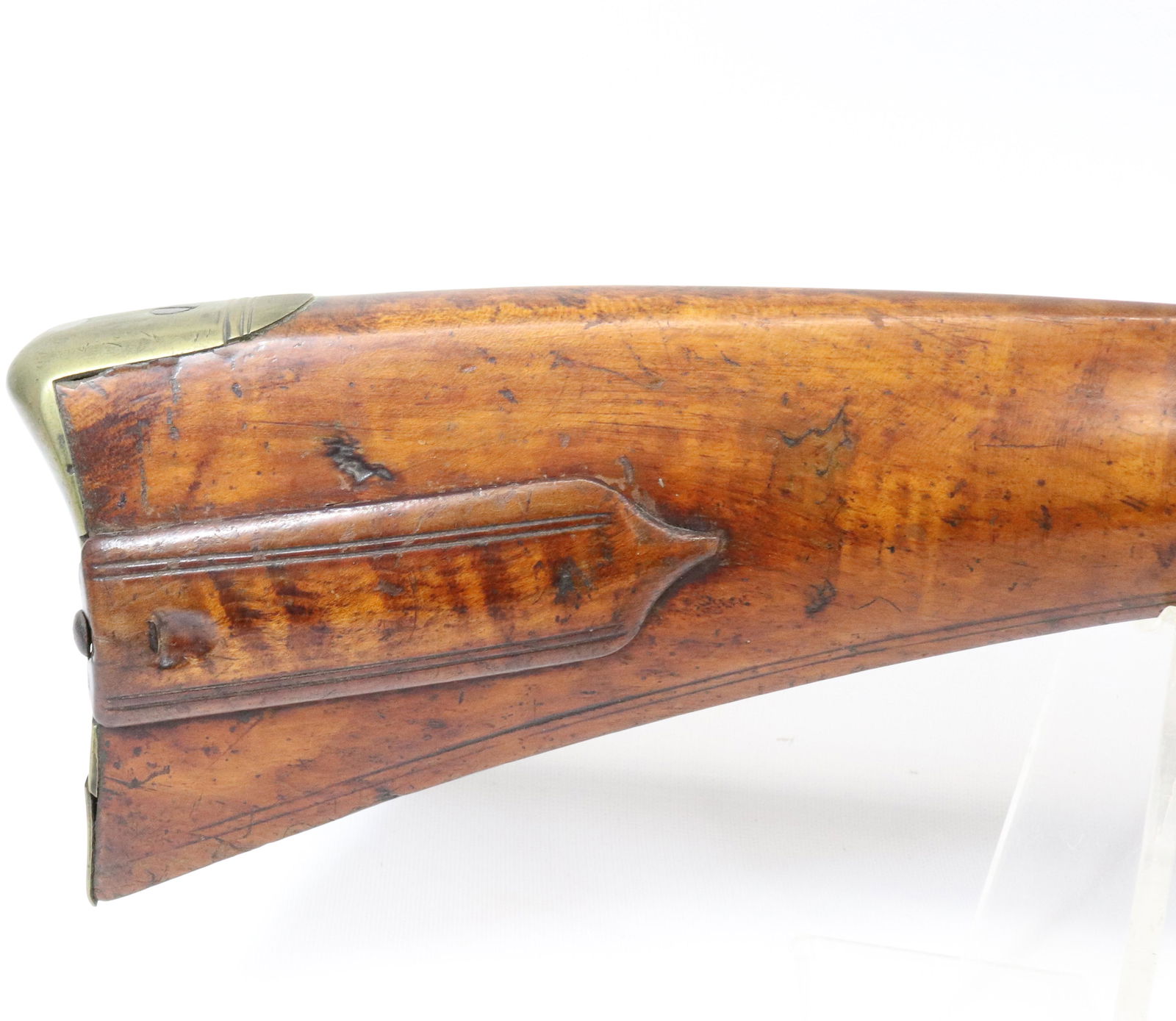

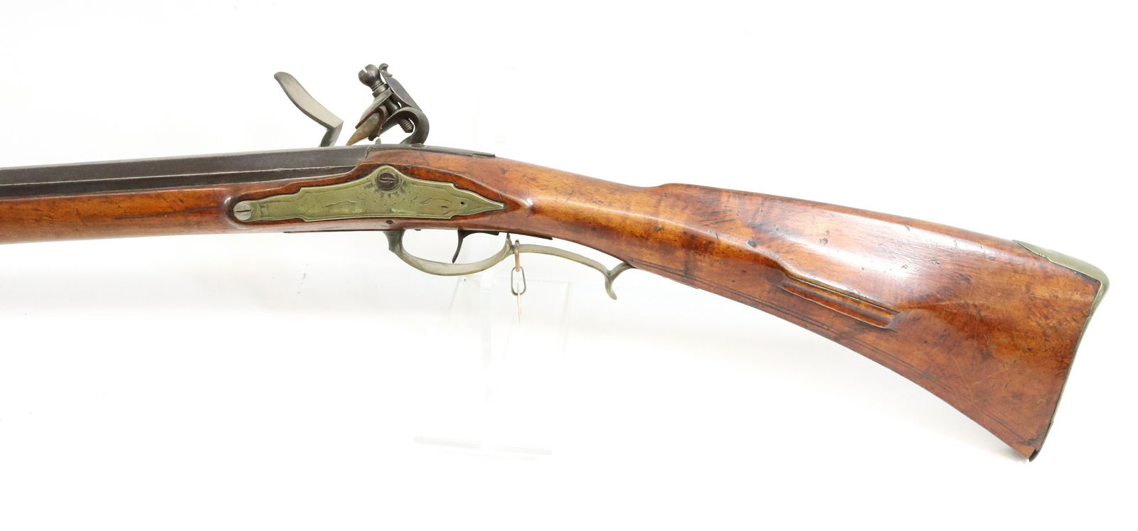

Whole lock replaced, no doubt, and probably some reshaping around the tail of the panel at the time it was converted and who knows, maybe again when someone started piecing in wood and/or maybe even this very lock in entirety.  Compare the tail shaping of the lock panel to the sideplate panel.
Typical Moll or Moll-type imho using scavenged parts.  I'll bet it's not a dainty gun - likely has some heft.  Box is probably original and I've seen a couple others done very similarly as well as with no brass cap at the rear.

I agree, certainly seems to be a little pointy gap on the far left tail end of the lock, wouldn't be surprised if the whole lock is new to the gun (which is a shame when trying to date a piece). That being said, it is a really cool box lid and interesting rifle.

That box cover really flips my lid.

An interesting gun, with an unbelievably poorly replaced lock!
Sadly, with a little work, a period replacement lock that would have fit better could have been found pretty easily.

Given what I see as some recycled parts, I'd love to see the gun with this lock on it.  Size is right although no idea if the bolt centers would line up reasonably.  Just enough 'repair' work to be believable but never converted.

JMHO but at 2800 plus what 24-26%? it's already just about max for what it is.  The best thing it's got going for is that box, which I believe original, and the traces of dark red varnish under the box.
