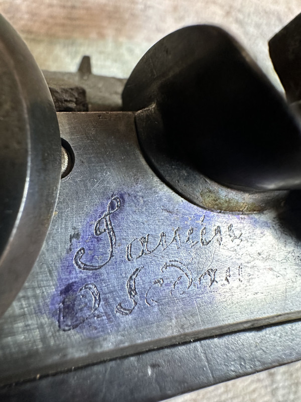

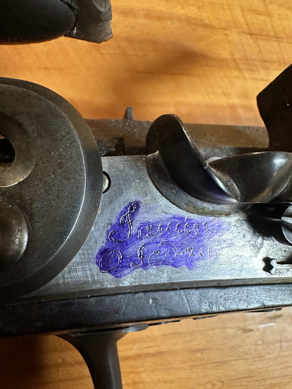

Likely nothing special but I think I want to make it a shooter.
Breach plug needs to be fabricated and pistol stock remade due to cracks.
I’m just trying to figure out what/who made it
I don’t know why I’m having such trouble with the script

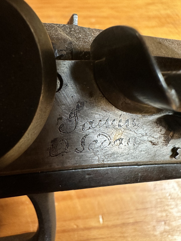

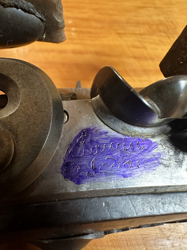

Because it's in French? I can't  make out the name. Is it Jausér D Sedan? Jasuér from Sedan possibly?
Offline plastikosmd
  • Posts: 239
Re: Help with name on a lock (pistol)
« Reply #2 on: December 23, 2023, 05:58:39 AM »
Maybe?
Better than what I came up with

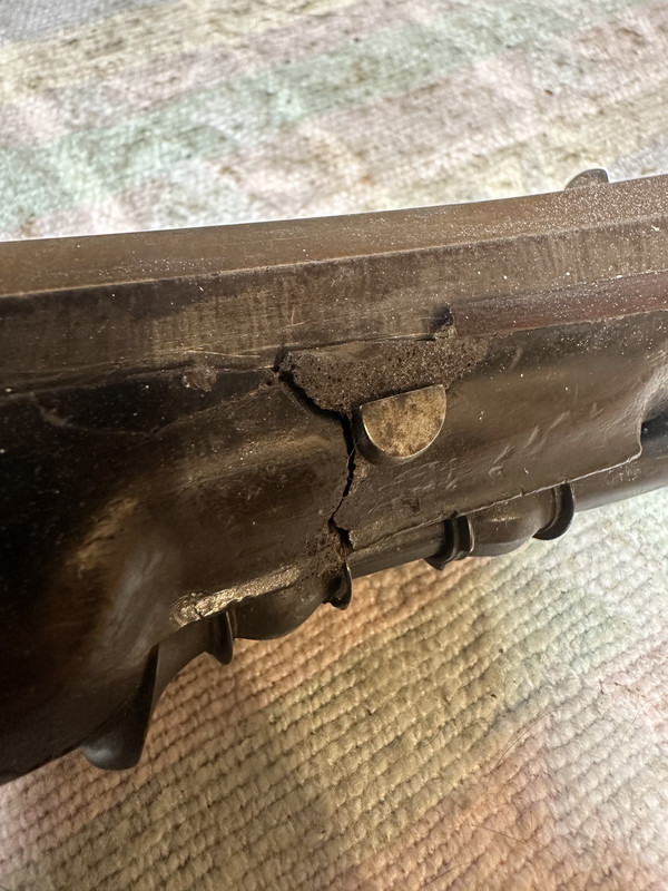

« Reply #5 on: December 24, 2023, 01:14:16 AM »
Home on Tuesday, is just plain comfortable to hold. Balance is awesome. I have a bunch of fancy siber/etc and this is my favorite.
Forend/forearm?? (Not sure on pistol nomenclature) barrel channel is pretty cracked. Someone glued but it would really require removal/splicing in a new piece.
If I can find someone interested in some woodwork (outside my my comfort zone) I’d love to hear from them.
  • Posts: 4589
« Reply #6 on: December 24, 2023, 01:54:29 AM »
I've done a lot of this sort of work, so let's see some pictures of what you're talking about.

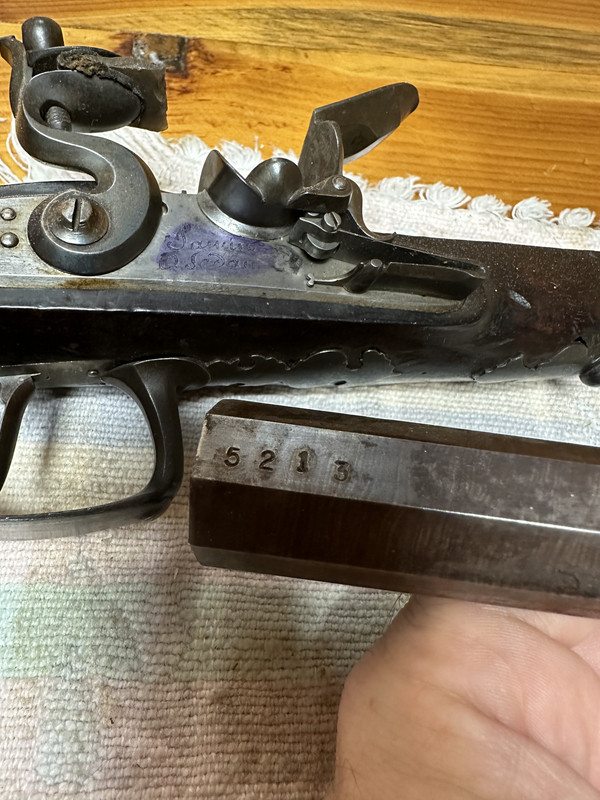

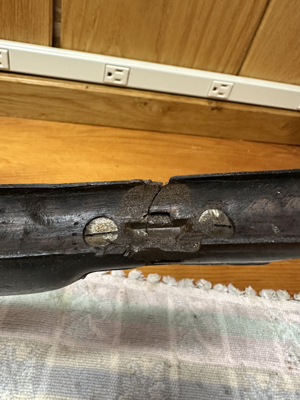

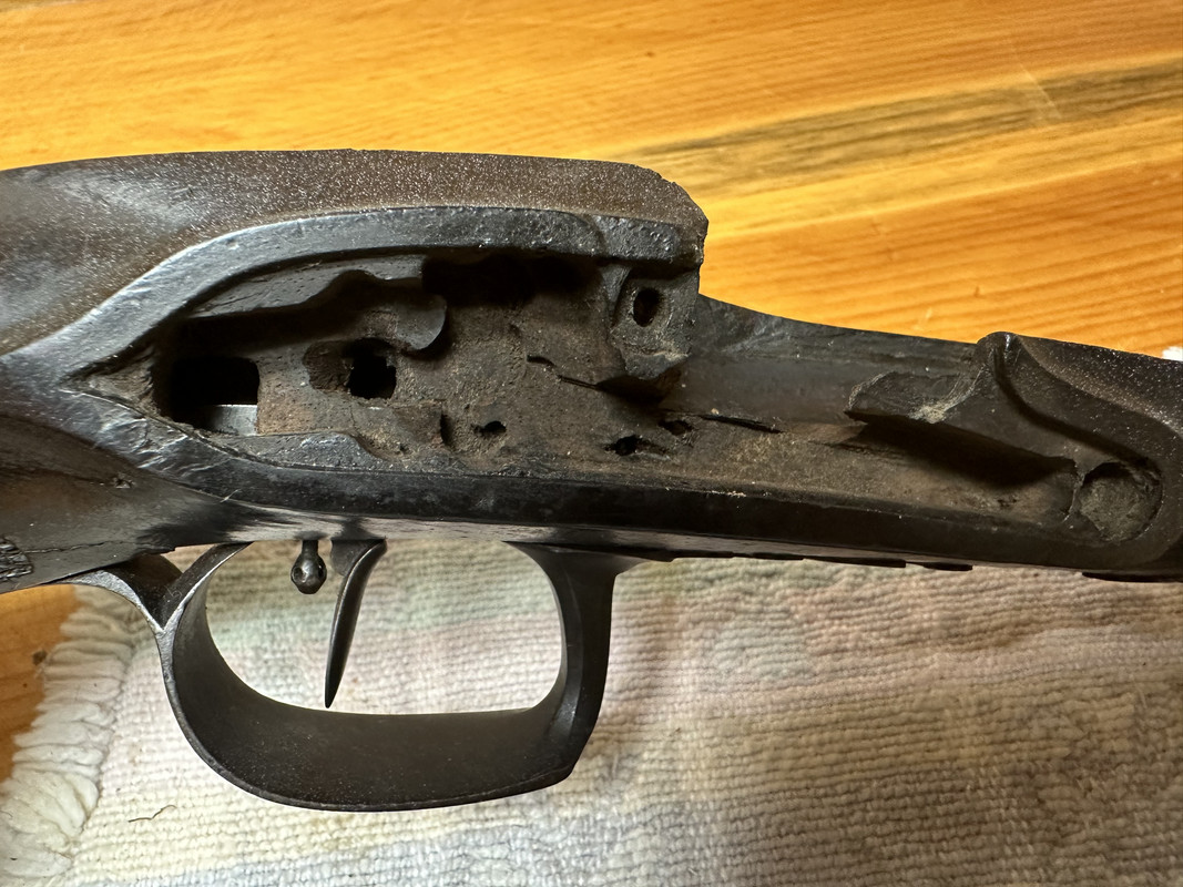

« Reply #7 on: December 29, 2023, 01:20:08 AM »
Multigroove
Cracked at barrel pin
Bit of wood missing at lock inset
The plug I have to make
Only other marking I can see, seems odd for the time period?

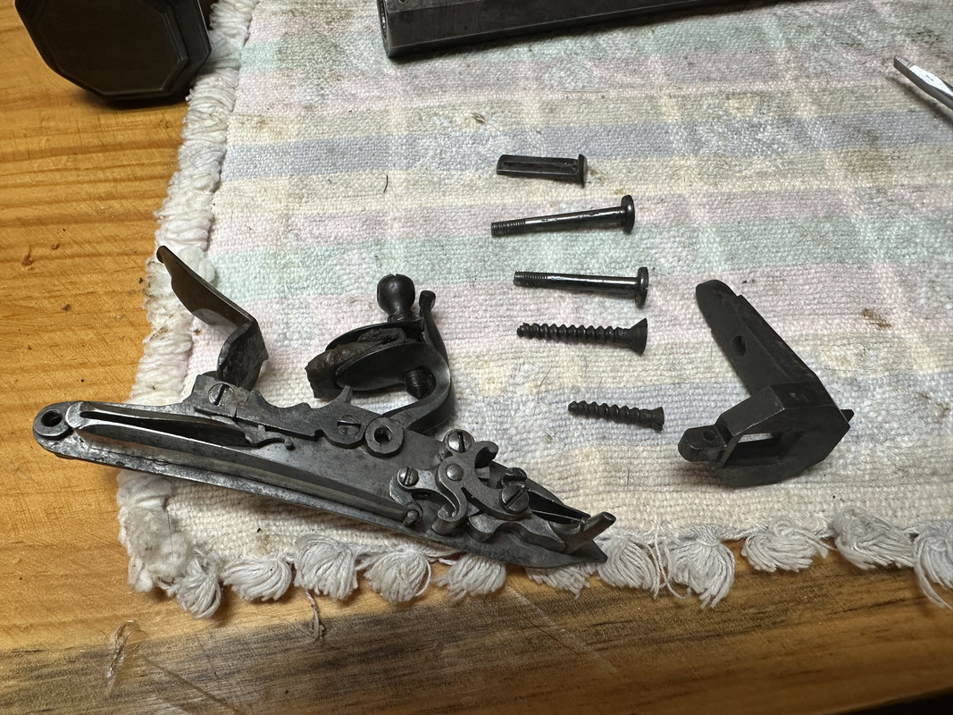

« Reply #8 on: December 29, 2023, 01:25:33 AM »

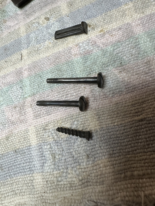

I can’t get the lock out, as of yet
There may be some writing on one of the lock screws.
I will look closer

« Reply #9 on: December 29, 2023, 01:31:18 AM »
Meh, strike that.
Lock out, just need to get trigger/guard out

« Reply #10 on: December 29, 2023, 05:08:00 AM »
So what wood is that stock? From the pics I can't tell.
And what are the white specks all over it? Dust, dandruff? Something permanent?
It certainly has a nice lock, set trigger!

« Reply #11 on: December 29, 2023, 01:06:43 PM »
The stock looks to have a shellac  based finish ?? You can see the build-up around the lock mortice...Nice lock ....later flintlock era 1810-1820??

« Reply #12 on: December 29, 2023, 06:46:25 PM »
Thx all
White specks, probably junk from sitting on someone’s wall or basement for years. I haven’t attempted to clean it at all.
Tho dandruff is a possibility, being retired.
Lock appears well made. Spring is strong.
Wood type, unknown. I wouldn’t know how to start to tell.
I guess I should start on a plug and get someone to fabricate a facsimile “stock”

My thoughts on your very nice late French FL pistol:
   Lock: Nice late FL. Great condition. The signature is a puzzle. "D Sedan” makes sense. It’s a city in NE France. I think the signature starts with an “L”, or less likely a “T”, but probably not a “J”. Der Neue Støckel lists 45 gun makers in Sedan, none of which I can make fit.
   Stock: Although broken, bondo’ed, maybe shellac’ed, and possibly the accidental recipient of paint overspray, the checkering is in unusually good shape, I like the architecture, and the piece appears well made. Looking at the lock mortise just above the sear spring area, I see open grain, suggesting the usual walnut. I would hate to see that fine stock replaced. It could certainly be restored by the right hands, leaving the valuable original parts and history intact.
   Barrel: Gorgeous swamp and rifling! Striping in some images looks like (faux?) Damascus. When you make the new breechplug, please don’t change the female threads in the barrel. Match the plug threads to the barrel. I agree the numbers look relatively recent. Maybe "bondo man" put his "mark" (last four of SSN) hidden under the barrel? If you know who owned it in the past, you might corroborate that.

« Reply #17 on: December 30, 2023, 07:21:39 AM »
Just a thought, but I wonder if the stock is made of Ebony? Hard to tell from the pictures. What does it look like to you?

« Reply #18 on: December 30, 2023, 04:04:52 PM »
Is most likely to be made of walnut that  has possibly been 'ebonised' or blackened using an iron/vinegar solution. This could account for the dark colour overall, including in the barrel channel and lock mortice. There does seem to be some lighter colour in the lock mortice, particularly in the sear and mainspring areas.
 I have a percussion pistol that appears to have had this treatment.
  • Posts: 4589
« Reply #19 on: December 30, 2023, 09:28:05 PM »
Thanks Niall.
I know Ebony is difficult to work with glue wise, and achieving a reliable glue bond.
plastikosmd, PM sent.
