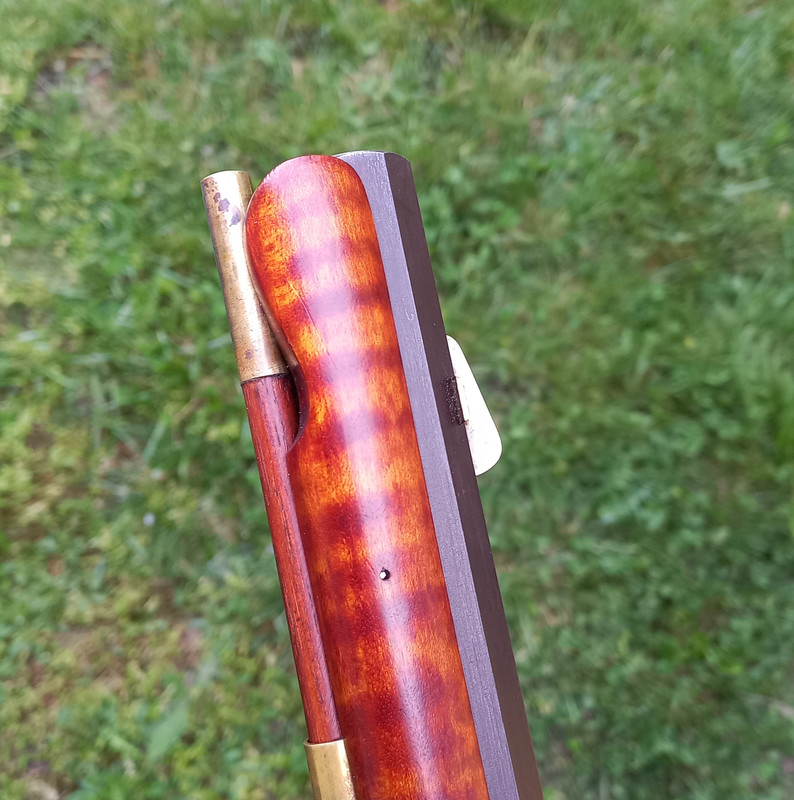

I have bought a Tennessee style rifle with maple stock.
It is a reddish color and by the looks of the internals of the stock it looks like it is colored with stain. Am I right?
Do I have to remove a lot of material if I'd like to sand this stain off and refinish it with iron nitrate?

Iron nitrate is going to get you a color similar to what you have now. That stock looks pretty to me.  Answering your question about how much material will need to come off, much depends on how deep the original stain and finish have penetrated the grain. Yes someone has stained the barrel channel. Don’t worry about that. Good luck 🍀!

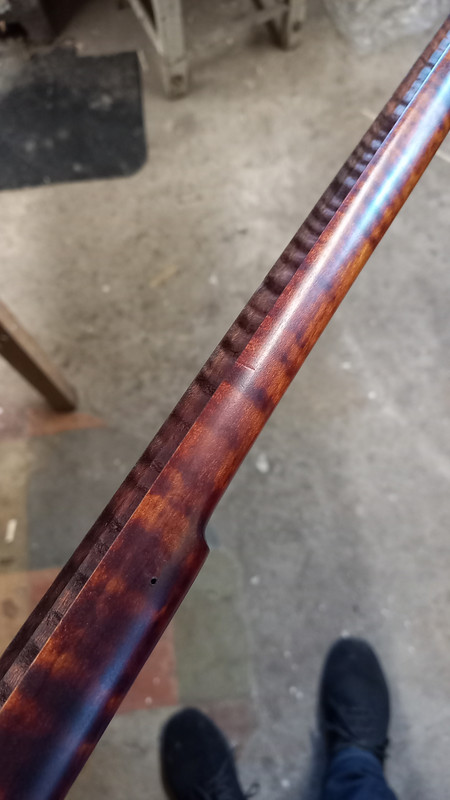

I've had better results with cabinet scrapers. Sandpaper will quickly load up with finish. Here's a stock my dad put stain on and I used cabinet scrapers to take it off.

Based on the pictures I would not remove the existing finish completely.  Filling the grain is a lot of work, there is no need to destroy it.
The existing will impair the water based AF stain penetration.
I'd take a different approach.  I'd rub it back with maroon scochbrite until I am down to the unstained wood for part of the grain.  IF it is going to slow use solvent and the scochbrite.  Mineral spirits  and charcoal lighter work well for this.   The figure has already soaked up the stain more in some places than others.  This is a good thing.   I'd then use a spirit stain-dye of whatever color you are looking for.  The result will be the red in parts of the background and  the new  color over all.  Done right it makes a 3D effect.

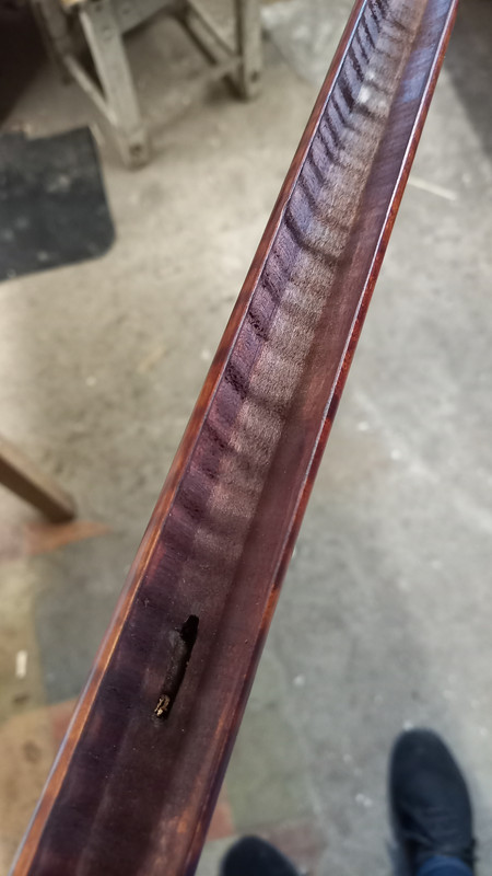

It looks like bare wood in the barrel channel, I woud do a test with aqufortis in the channel over the stain, blush it, add some finish and see how it comes out, you might like it.

KRNL, here is a shot of the stock just after blushing with nitric acid and another with finish. It darkened a little with age.
That's another great idea. Thanks a lot.

This looks awesome. I see no traces of the stain left. I really like this dark brown color. Looks antique.

Colour looks good. That's a LONG cheekpiece.

My dad wasn't a gun guy but wanted to build a rifle upon his retirement in 1978. We gave him the parts, books, and instructions and he did a fine job although messed up the top of the buttplate a little. He never finished it so I did the refinishing, browning, and final fitting of everything several years ago, years after he died. Outside of the buttplate problem it turned out OK. It is a great shooter and very accurate.....45 cal.
Daryl, I never noticed the cheekpiece but you are correct, it is long.

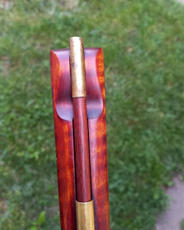

So, my rifle has this flared nose with the rounded front and this rather weird cutout for pinching the ramrod.
That's why I thought I would reshape it or add a brass nosecap. All the hardware is brass on the rifle.
But if I reshape the front then I have to refinish the whole rifle.

I see your point, it looks like someone made a rifle stock out of the upright of a ladder back rocking chair!
But you might be able to "feather in" the stain and finish if you just work on the nose.

Some of those have the cutout for the fingers even depth to the muzzle.
Check em out. There's a thread on SMR's with a truckload of pictures for you to see.

The fact is that you cannot pull the rod out this way. Like you pinch it, but then you can't lead it forward because of that hill infront of the recess.
